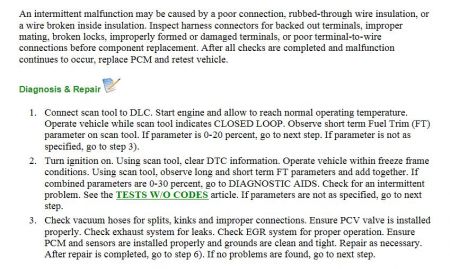

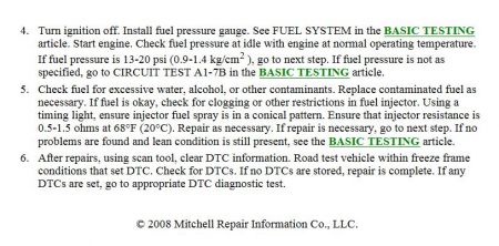

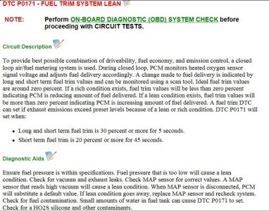

Hi treasuregetter, Thank you for the donation. The VSS code should be a different problem. Is the speedometer workign erratically? P0171 does not necessarily mean a bad O2 sensor. It could be a fault with the idling circuit. I would suggest testng the MAP sensor values. Here are the explanation and diagnostic procedures.
https://images.2carpros.com/forum/automotive_pictures/192750_DTC0171_97GeoMetro01a_1.jpg
https://images.2carpros.com/forum/automotive_pictures/192750_DTC0171_97GeoMetro01b_1.jpg
https://images.2carpros.com/forum/automotive_pictures/192750_DTC0171_97GeoMetro01c_1.jpg
