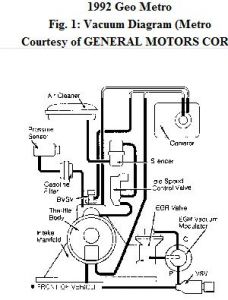

Does the check engine light come on? this is a odd duck vehicle but i worked for chevrolet when they were new and im trying to remember any odd problems. one thing i remember is the map sensor and the vacuum line going to it was usually the only problem i ever found with this car. check it out and get back to me
https://www.2carpros.com/forum/automotive_pictures/139033_ac_4.jpg

The check engine light does not come on! I checked and cleaned the egr valve and it it working now! I also checked the map sensor and it is functioning also! I have noticed while driving it it will do the stalling when you hold the accelerator steady. If you accelerate or slow down it does not stall. Seems to be at around 2000 rpm. I wonder about the throttle position sensor? Upon futher investigation I see that the injector is cutting off fuel when the stall occurs. It also wants to stumble when you first start it!

Sorry I missed your repost. Tps is a possibility, you caan check the voltage of the tps and see if it drops out at the steady throttle, also how did you check the map sensor and did you check the vacuum supply and volume? And its losing injector pulse not fuel pressure correct?

I checked the map sensor by first taking it off and inspecting the vaccum line itself it was fine! I then pluged it back in to make sure there was vaccum and there is. Then I unpluged the sensor while the car was operating and it made a significant difference! I also checked the tps and it was not the problem! The fuel presure is remaining at about 20 psi but the injector stops the pulse.
