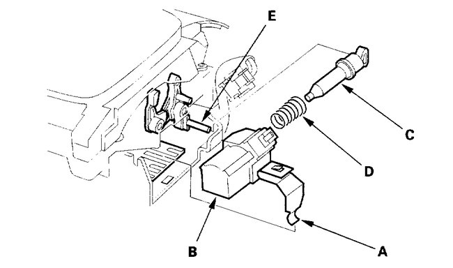

My gear shift wont move out of park normally.

The vehicle is equipped with a shift interlock system which prevents shifting from park with your foot off the brake. So, the first thing I have to ask, are the brake lights working? I know that sounds crazy, but the interlock release solenoid is powered via the brake light switch.
If the lights are working, then you will need to access the solenoid and determine if there is power going to it. If there is power, then replace the solenoid.
Here are directions for replacement of the solenoid. The attached picture correlates with the directions.

SHIFT LOCK SOLENOID REPLACEMENT
Shift Lock Solenoid Replacement
1. Remove the console panel.
2. Disconnect the shift lock solenoid 2P connector.
pic 1
3. Pry the shift lock solenoid clamp (A) with a screwdriver, then remove the shift lock solenoid (B).
4. Install the shift lock solenoid plunger (C) and plunger spring (D) in the new shift lock solenoid.
5. Install the shift lock solenoid by aligning the joint of the shift lock solenoid with the tip of the shift lock stop (E).
6. Secure the shift lock solenoid with the clamp, then connect the shift lock solenoid connector.
