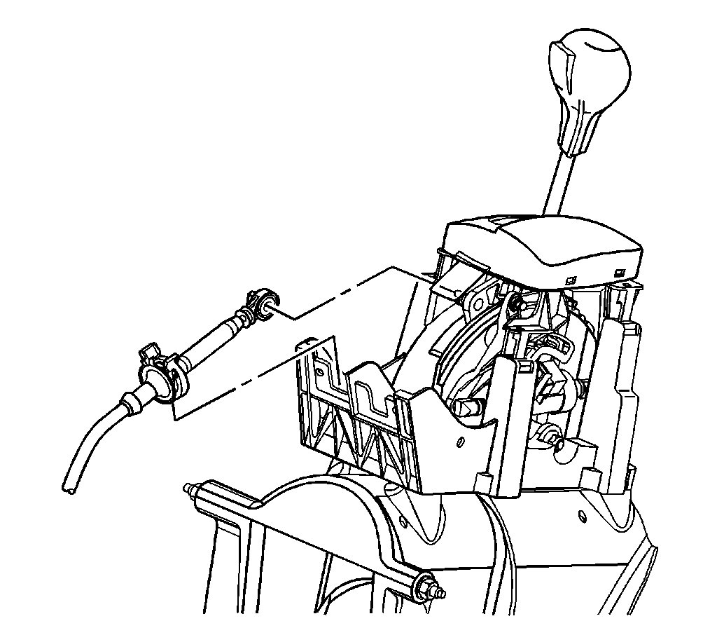

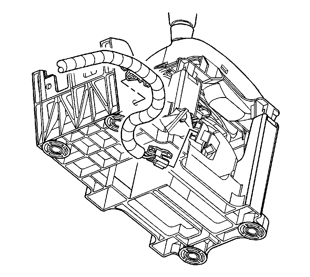

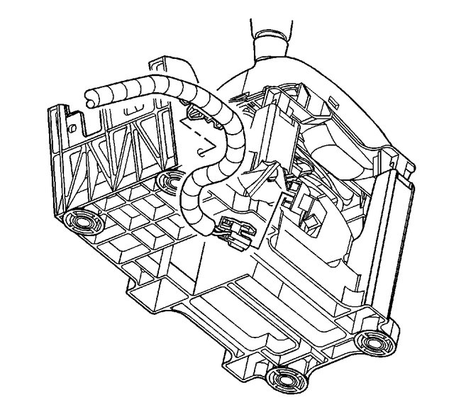

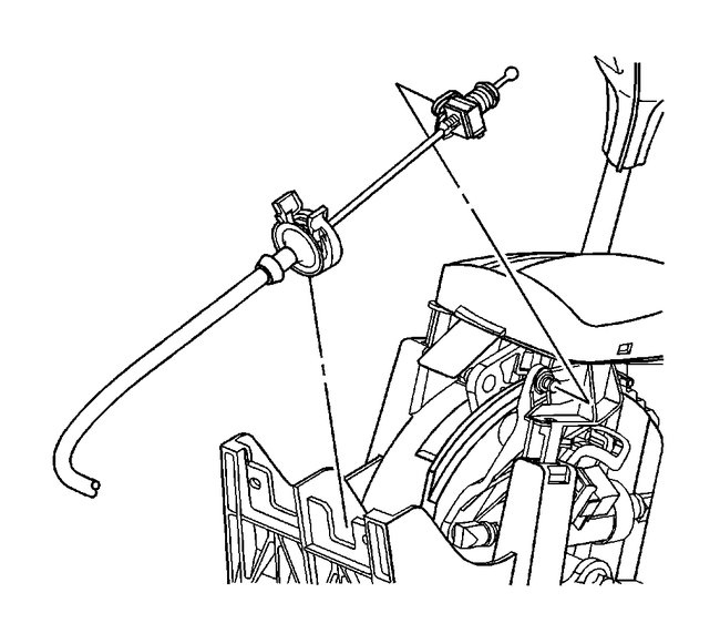

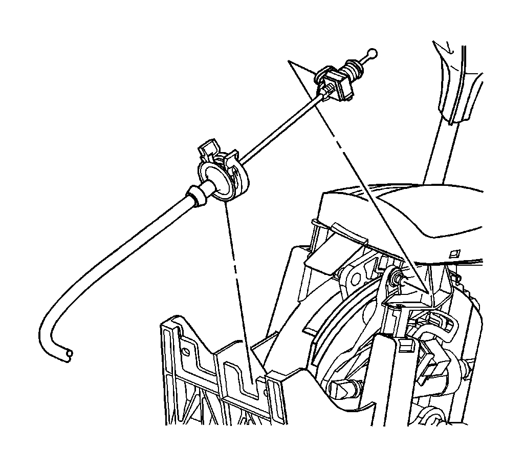

That will let you access the shift control. These can be repaired but it's usually easier and faster to just replace the entire unit. For that you remove the shift cable by releasing the tab and popping it off the stem. Then squeeze the release tab for the interlock cable and remove it. Now remove the wiring connector and the 4 bolts that hold the shift control in place. Reverse the process to install the replacement.
