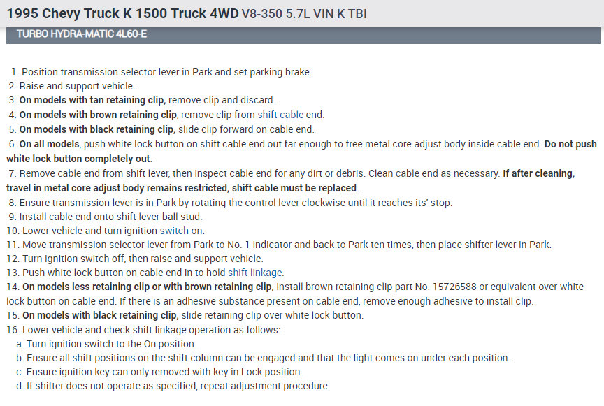

Is there any how to videos on changing the gear selector cable and adjusting it if it can be adjusted.

Here is what I found for replacement and adjustment of the shifter cable. I've attached a picture below. Get back to us and let us know what happens or we'll go from there. Hope this helps and thanks for using 2CarPros.
