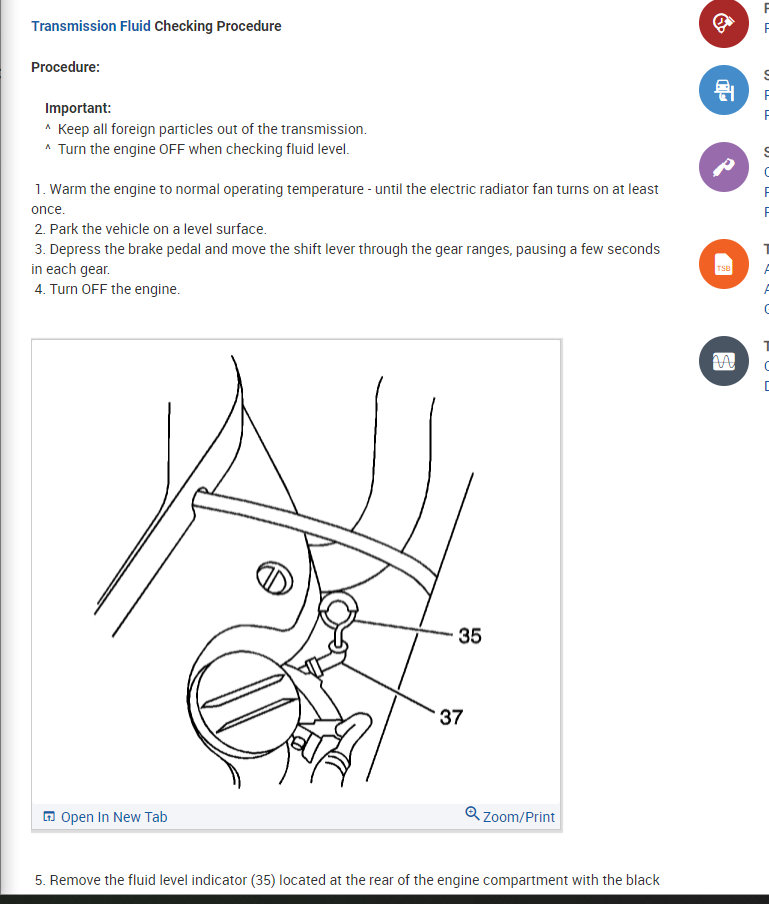

More than likely this is fluid related. There really isn't anything that cares about the temperature other than the fluid. If things get too hot then it can cause slipping but complete disengagement just sounds like the fluid is not able to keep the pressure needed. Then when the fluid cools down a little, it is able to work again until it gets too hot.
There is a chance that this is also a cut seal that only acts up when the unit it hot.
However, let's start changing the fluid as that is the easiest and most common issue. Then we dig deeper if needed.
Here is a guide that will help with this.
Below you will find the process from the manual. If you can get a picture of what the fluid looks like when you checked it. I understand that it is not low but what does it look and smell like? If it smells burnt then that is the first sign that this is at least related to the issue.
Please see the info below that will help with this as well.

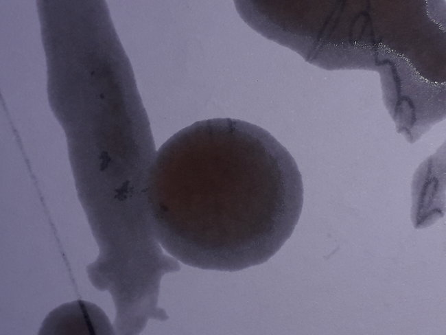

It still looks clean, that pink color of ATF and smells the same as out of the bottle.
the attached photo is a few drops on white paper.

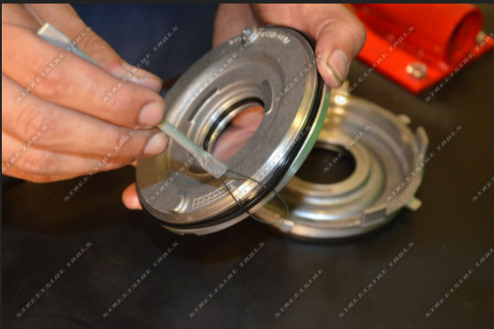

So if you have this issue that the vehicle just revs up until you return to an idle then that points to this pressure issue that I am talking about.
If it is not the fluid then that means most likely there is a seal internal to the transmission that is cut and not holding pressure when it is supposed to.
This is not an external leak just a seal on what is called a drum or piston on the inside of the unit.

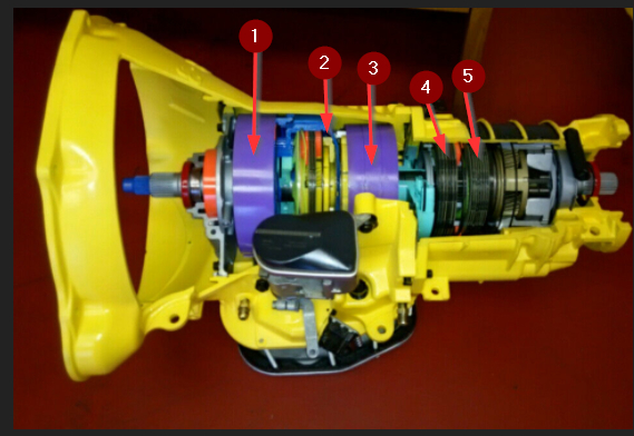

Basically there are about 4-5 clutch packs and drums with pistons and they all have seals on them. So when you need first gear you apply one combination of clutches and then second gear is a different combination. Each combination will result in a different gear ratio which is how the transmission shifts through the gears.
Take a look below at a cut out of a transmission and you will see the clutch packs. Then the next picture is of one of these pistons where they are showing a seal.
If one of these seals is cut then when it is supposed to be holding pressure it won't and that prevents the gear from engaging.
Imagine trying to water a garden with a hose that has holes in it. You have no pressure at the nozzle because you are loosing it all out of the holes in the hose.
If there are no codes and it just neutrals out, then unfortunately if it were me, I would remove it and go through the unit inspecting this and the valve body for issues. Especially if this has been happening for this long and it progressed to this point. It sounds like it has finally failed.
