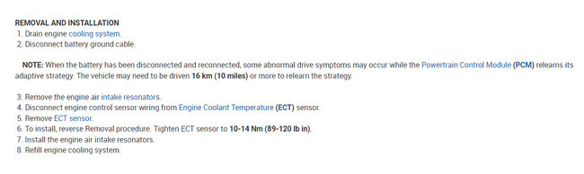

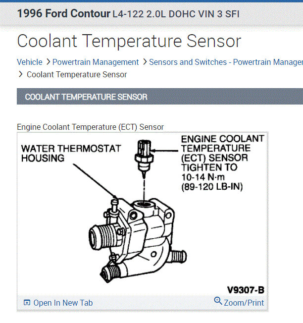

Thank you for your answer. I checked the ohm readout on the temperature sensor and it is way off. I notice that the wires to the sensor have crumbling wire protection coating. Can I diy this with new wire?
May 17, 2021 at 4:05 AM
  • 110,248 POSTS
As far as replacing the sensor, you should be fine. I attached the directions below. You will need to drain the coolant level below the sensor or you will end up with a mess. LOL

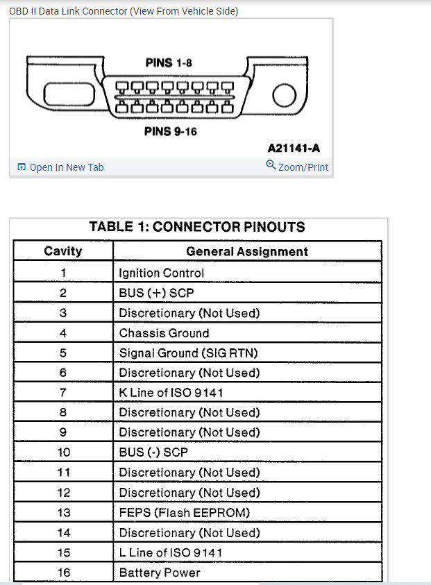

First is to scan for codes, the second is to allow to idle and monitor the temperature, remember to inspect transmission oil for any burn smell and if it is full according to Ford dipstick. Let us know what happens and please upload pictures or videos of the problem.
I am glad to help you, if there is anything else we can help you with please contact us again. Thank you for choosing 2CarPros. Take a look at the chart for diagnosis connector.

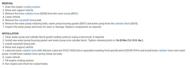

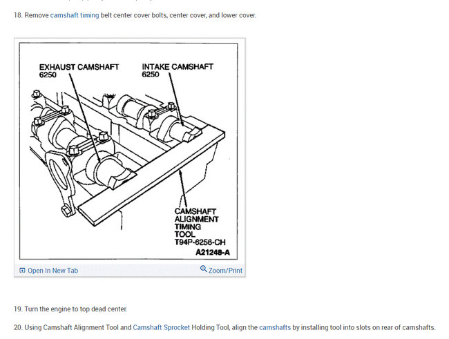

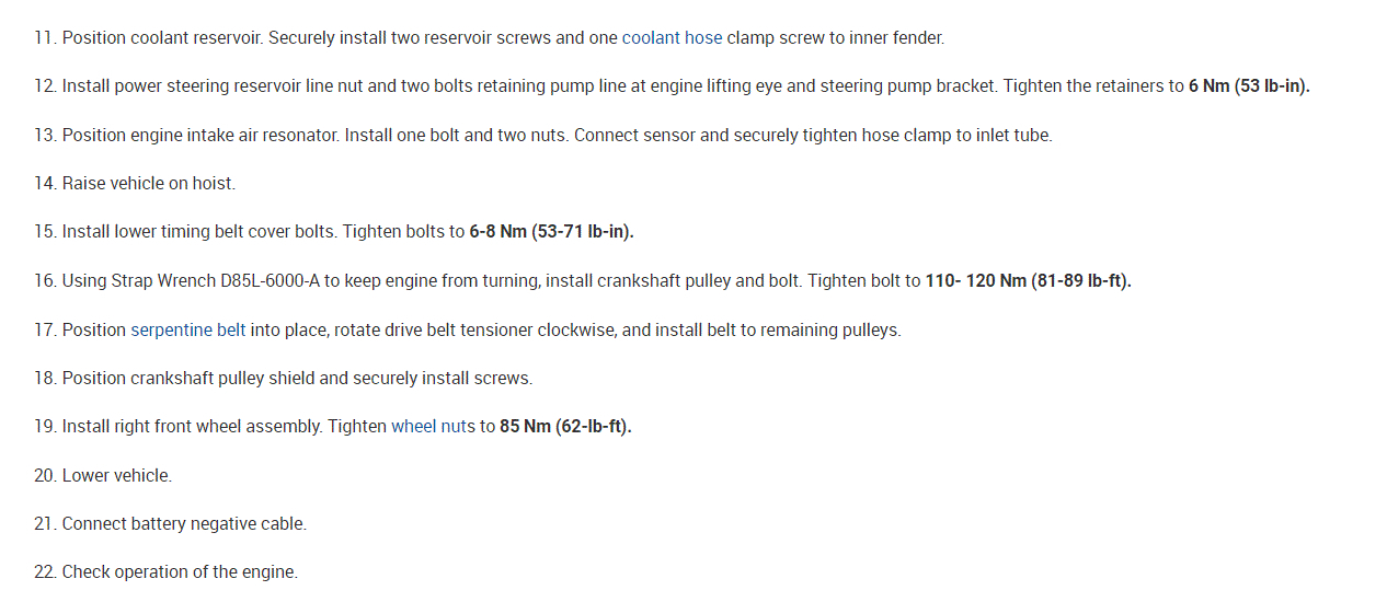

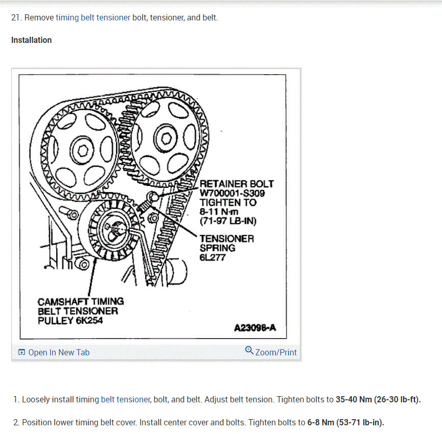

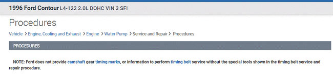

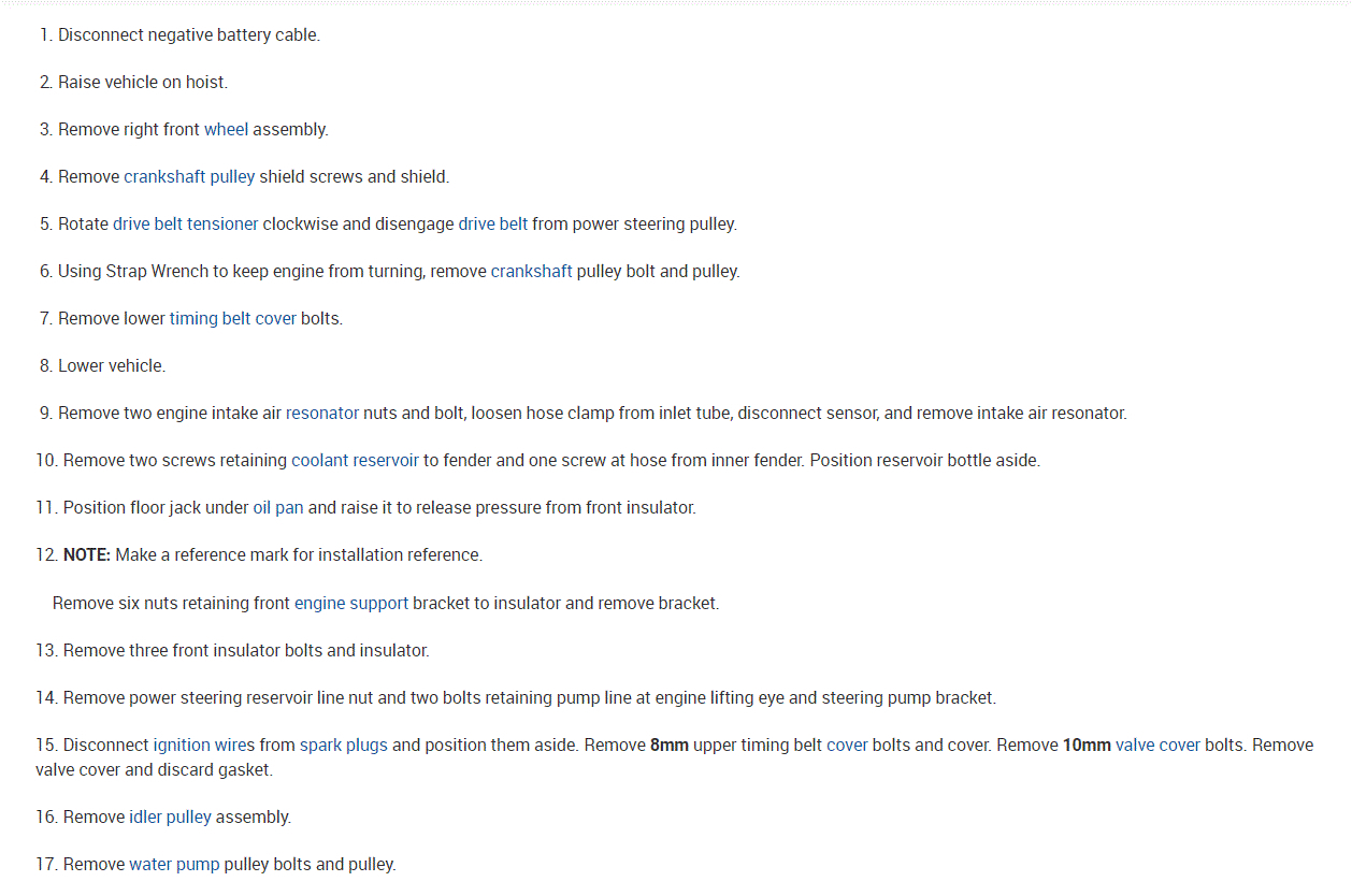

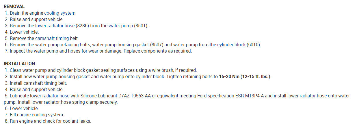

After replacing the obvious sensors etc., it is now down to the water pump. I purchased one and have to replace it myself. Is there a video you know about to give me a blow by blow. I know it is a difficult job but don't have a choice re tackling it myself. The car is 1996 Ford Contour 2.0 litre, 4 cylinder.
Many thanks indeed.
May 21, 2021 at 4:49 AM
  • 110,248 POSTS

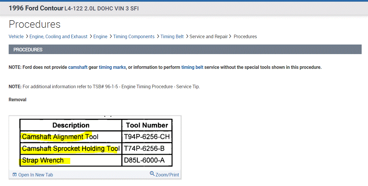

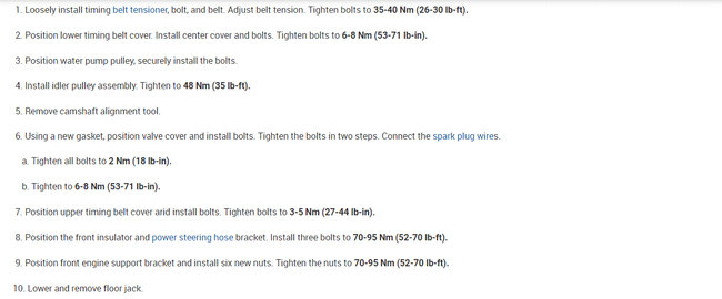

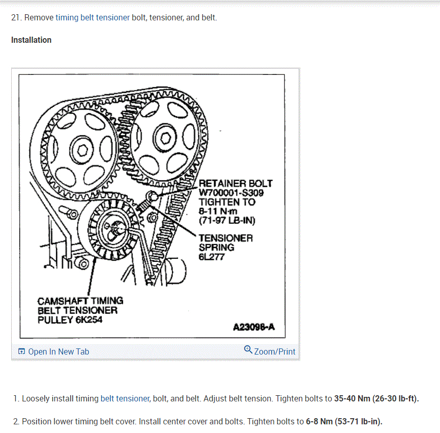

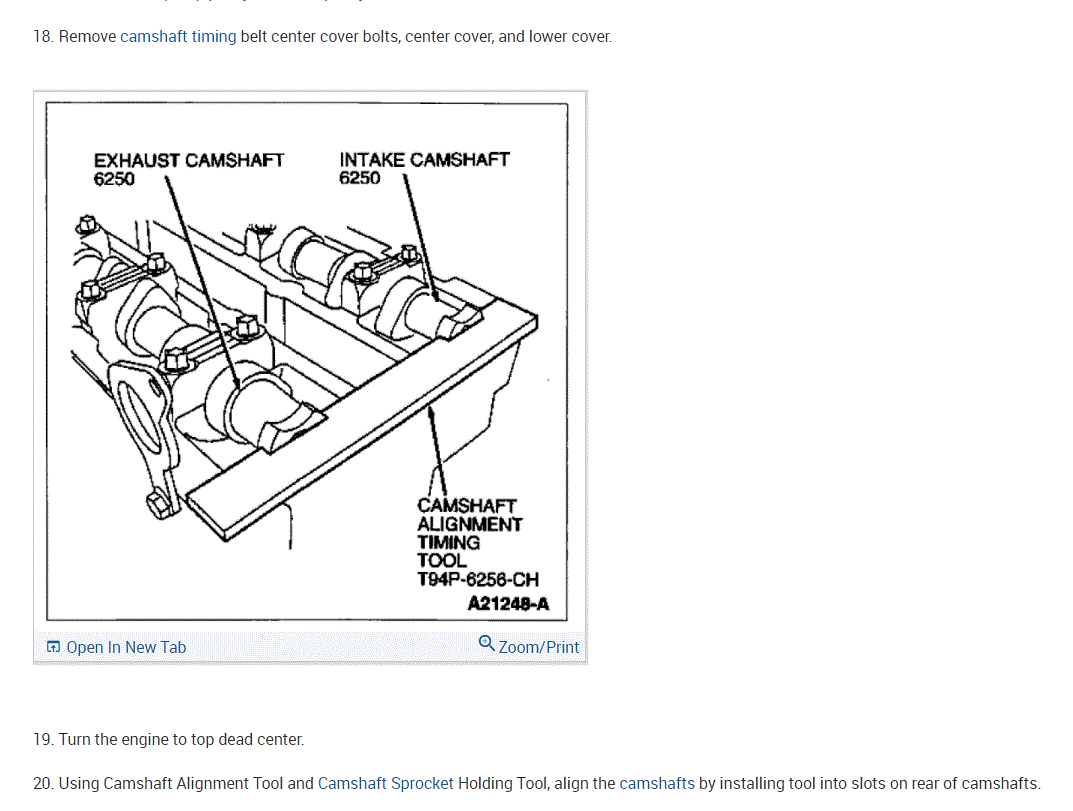

The camshaft timing belt needs to be removed. I am going to first give the directions for the pump replacement. After that, I will include the belt directions. You will need a couple of special tools to accurately time the cams. They are indicated in the directions. I believe you should be able to rent or borrow them from a parts store.
Once you get it back together, turn the engine several rotations to make sure there is no binding. If there is, don't force it. Instead, recheck the timing marks.
Interestingly, (and this is from memory) the 2.0 DOHC in a Contour shouldn't be an interference engine. However, the same engine in the Ford Probe was. So, that's why I'm recommending turning the engine several times first.
May 21, 2021 at 12:46 PM

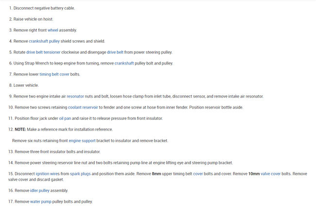

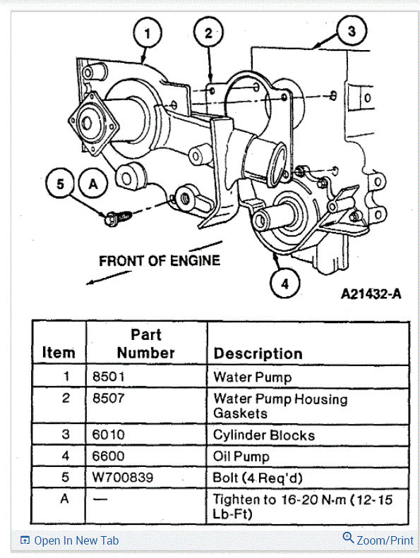

The water pump on this car seems to be driven by the serpentine belt. Do I still have to go through all the camshaft timing belt steps?
May 21, 2021 at 5:50 PM
  • 110,248 POSTS
Unfortunately, yes. Although it is driven by the serpentine belt, it is mounted to the engine block behind the timing belt. I have to be honest with you. It isn't an easy job on this vehicle. Make sure you are 100% sure the pump is bad.

I should further explain fuel pump issue. I don't know for sure it is gone. What I do know is that the pulley is making a lot of noise and doesn't run true to balance. It appears to be rough running and wobbles - big word to describe a little "shake" back and forth. Sounds like the whole thing wants to be bathed in oil! Water pump pulley has been discontinued, so if in fact there is a bearing in the apparatus, the only thing I can think of is to take it to a bearing company and put a new one in.
What do you think? I really don't know if there is a bearing in that pulley. Can't find any info. At this point, I will go to fantastic lengths to avoid replacing the water pump! Although I'm sure I can tackle it with all your help, it is, in the long run, daunting!!
So, I will wait for you to opine and we'll go from there.
Cheers!
May 23, 2021 at 11:22 AM
  • 110,248 POSTS
The code indicates the sensor is slow to respond. That can be caused by several different things. For example, the obvious, the sensor could be bad. Also, an exhaust leak, engine vacuum leak, and even a wiring issue can cause the code to set.
IF the water pump is making noise and has a wobble, the bearing is bad. With the engine off, see if you can wiggle the pulley. Also, if you can possibly record it and upload it for me to see, it may help.
As far as the bearing, it isn't one that can be pressed in. The new pump will have a new bearing.
