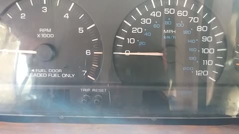

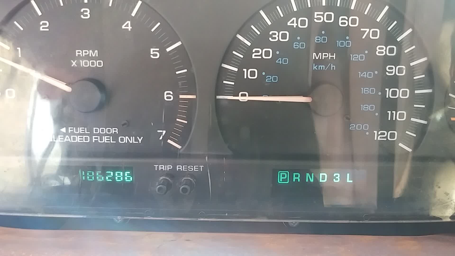

When the key is turned to the off position the gauges will "tick" and jump around a little. Just barely tapping their posts.
So far, I have replaced the ignition switch and I have soldered the connectors on the back of the instrument cluster. I have cleaned the battery terminals even though they are fairly clean anyways. I even tried connecting a jumper cable to the negative and grounding it on different bolts in the engine.
I honestly don't know what to test or try next with this.

Here is the video. And no, the numbers don't look like they are flashing like that when not on video.
Feb 2, 2021 at 1:49 AM
Yep. I have seen that a number of times and it is normally a battery issue. The way to test the ground is we will need to do what is called a voltage drop or a resistance reading. They are not overly complicated but I would start with the battery test because I would be surprised if it passes.

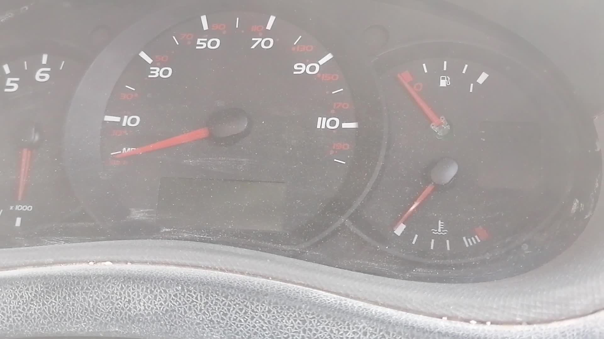

Does anyone know what is causing this issue? I just had a new ignition barrel and started installed. this wasn't happening before. Tia Andy

  • 54,837 POSTS
So, that is not you trying to crank the engine over? Is the battery in good condition fully charged? It looks like it is low voltage.
Sep 22, 2022 at 12:20 PM
1969ANDY
  • 7 POSTS
No, it's not me trying to crank it, the keys were not even in the van.
Sep 22, 2022 at 1:20 PM

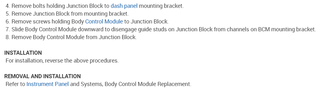

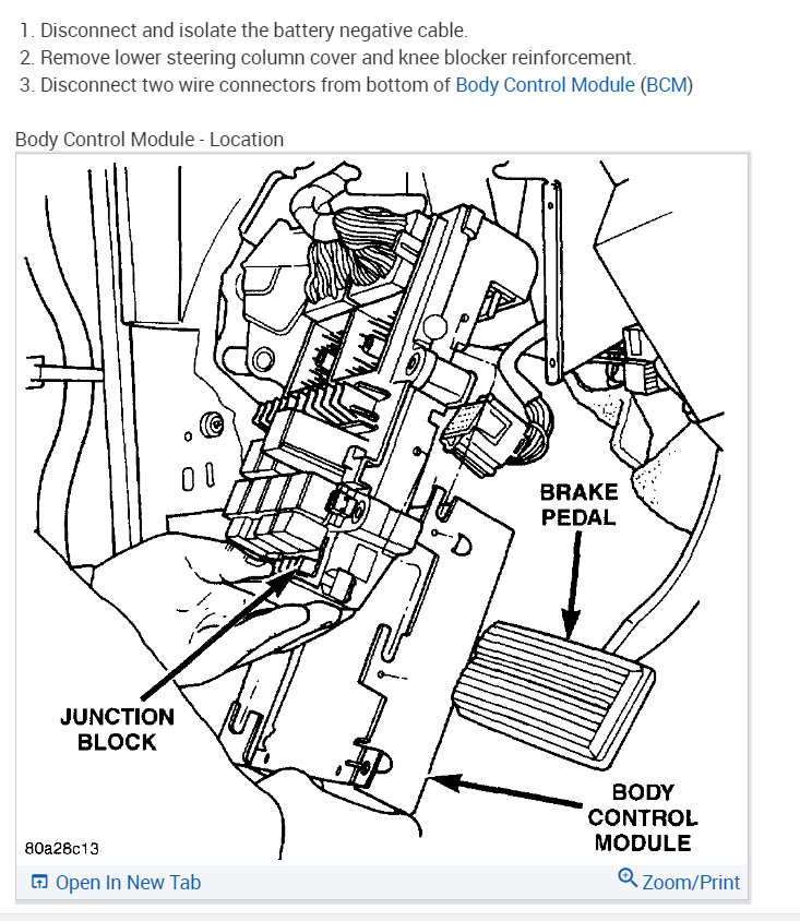

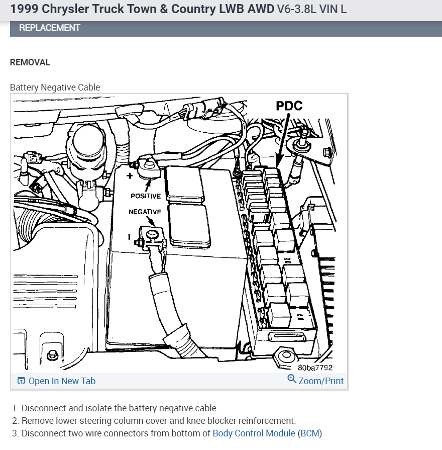

  • 54,837 POSTS
It looks like the BCM was gone out. here is its location and how to replace it in the images below. We should do a CAN scan first though to make sure it is not the cluster as well. Also, let's recheck the work that was done, maybe a ground wire has been left off. You can get a CAN scanner (Controller Area Network) from Amazon for about $36.00.
https://youtu.be/u-4syLc-ifQ
