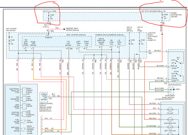

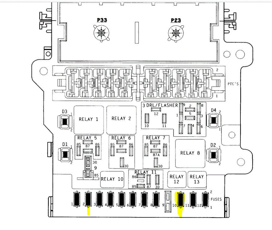

All of the dash gauges stopped working, the blinkers and the park and drive indicators as well. I drove it they were all on the next time I drove it they were all off. I checked and replaced some of the fuses under the dash. Can anyone help?
Nov 9, 2020 at 1:36 PM
  • 110,240 POSTS

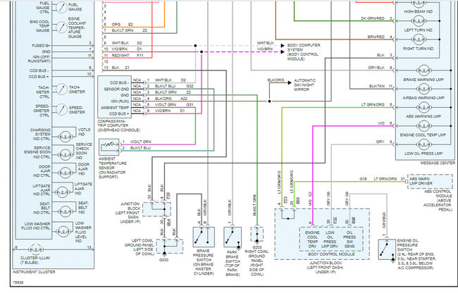

I attached a copy of the wiring schematic and circled two fuses to check first. You may have already checked them, but I'm not sure.
Next, in addition to checking the fuses, confirm there is power both in and out from it. Here is a link that you may find helpful:
I had to cut the schematic into two parts to make it readable. However, I did overlap them so you can follow them easier. (pics 1 and 2)
Note that both of these fuses are located under the hood in the power distribution box.
Let me know. Also, make sure nothing has come loose under the dash where the harness plugs into the instrument cluster.

We reset the instrument panel and the gauges have been working every since but still no signals. We were just looking up the fuses when I got your response. We could not figure where they were located. You helped us tremendously with the circled photo. I appreciate your help so much! I'll let you know and again man, thanks a lot!

  • 110,240 POSTS

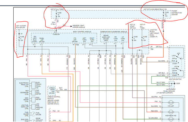

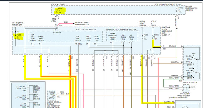

I need you to confirm the fuses I circled in pic 1 are good. In addition to the fuses being good, we need to confirm there is power to them and back out.
If you look at pic 2, the two fuses I highlighted power the instrument cluster gauges, lights, and so on. If one is bad, everything shuts off.
Pic 3 shows the fuse box under the dash. The two highlighted fuses are important to check. Here is a link that you may find helpful when checking for power:
____________________________

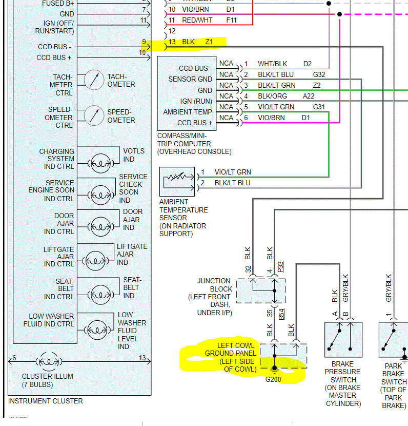

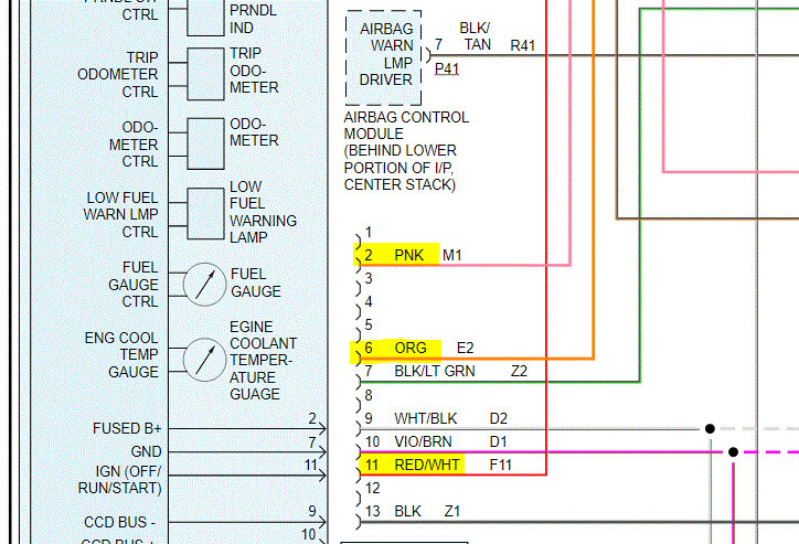

If the fuses are good, have power both in and out, then you need to go to the instrument panel connector and check for power at the three wires I highlighted. See pic 4.
If there is power at the connection, then we need to confirm there is ground via the black wire at the plug. For this, you need to check for continuity to ground (Ohms / Resistance). You will need a multi-meter to do this. See pic 5
If there is power to all supplies at the panel, the ground is good, and none of the pins in the connector to the cluster are damaged, bent, corroded, or pushed in, chances are the cluster needs replaced.
I know this sounds like a lot. However, I'll help you through it if you have questions or run into trouble, so don't be afraid to ask.
