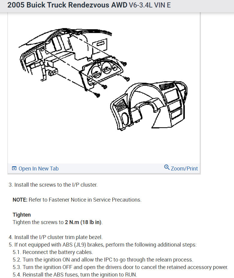

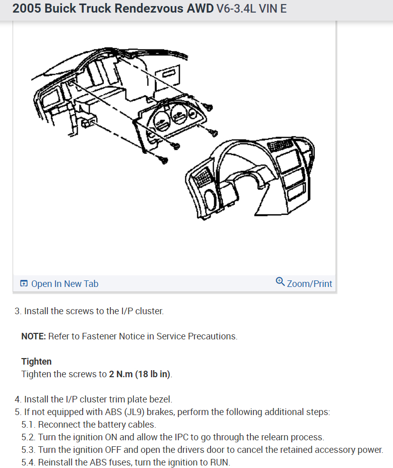

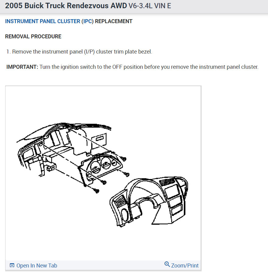

It says error on odd the gas,rpm, temperature gauge not working.
Jun 22, 2021 at 4:52 AM
  • 55,433 POSTS
Let start by checking the fuses. here is a guide to help with the fuse locations below:
if the fuses are good it sounds like the cluster has gone bad. to be sure lets do a CAN scan which is the future of automotive repair you can get a CAN scanner from Amazon for about $50.00. here is a video to show you how:
https://youtu.be/u-4syLc-ifQ
If confirmed this video shows the job being done on a similar car but the process is the same:
https://youtu.be/_HEC44xENxw
Here is how to do the job in our car in the diagrams below. Check out the diagrams (below). Let us know what happens and please upload pictures or videos of the problem. You can find a rebuilt cluster on eBay.
