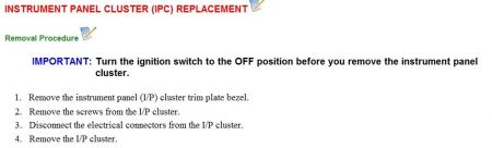

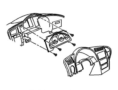

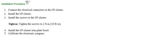

What are the steps for removing the gauge cluster? I am having issues with my speedometer and would like to send off the gauge cluster to get it repaired, but I need to remove it properly.
