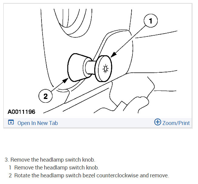

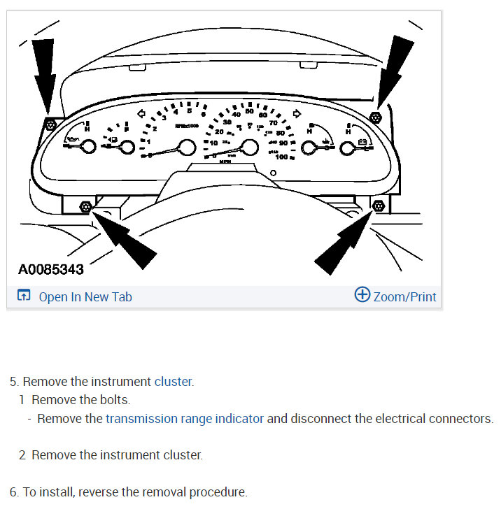

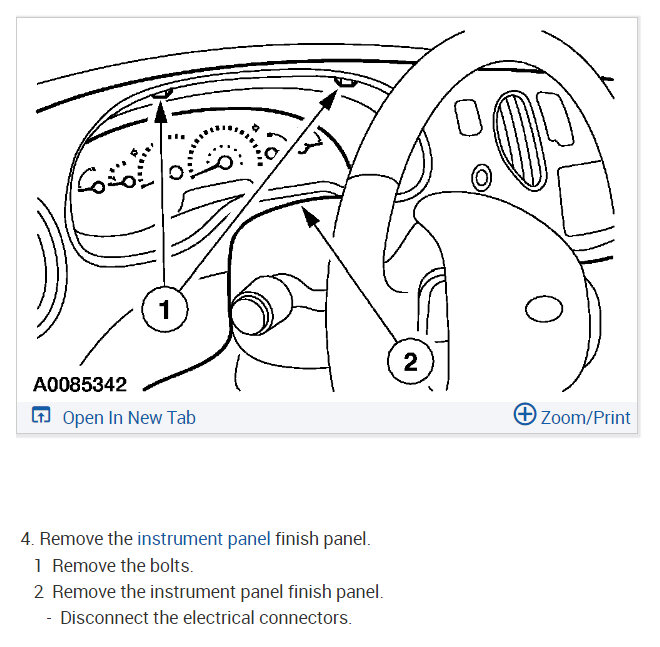

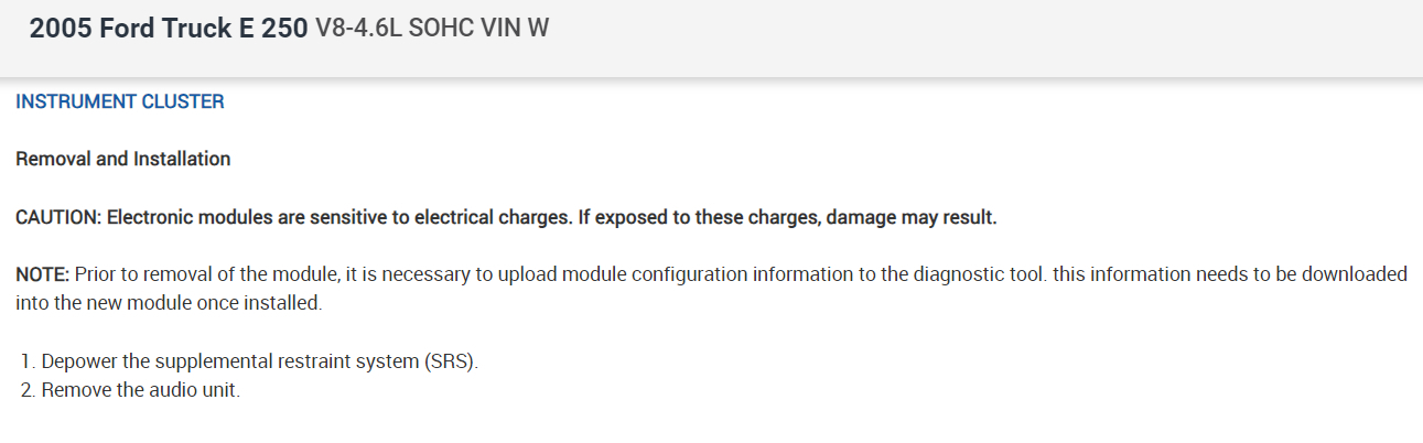

For a 2005 Ford E-Series Van (specifically the E-250 model), the gauge cluster is generally interchangeable with models from the following years:
2003 to 2007 Ford E-Series Vans (E-150, E-250, E-350, and E-450)
Here is how to change the cluster out in case you need it. Check out the images (below). Please let us know what happens.

The information was incomplete. Instrument cluster need to be programed by a Ford dealer or some who understands the programming.
Mar 30, 2026 at 1:04 PM
  • 55,433 POSTS
If you are repairing your original cluster then no programming is needed. But, yes, if the cluster is from another vehicle or the programming/PATS setup so it will not communicate correctly with the vehicle and keys. Good catch.
