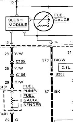

My gas is not working. i mean the needle jumps around all the time from full to empty then to half.

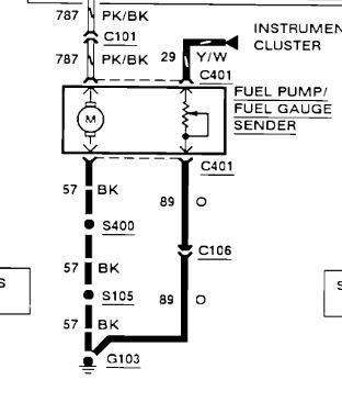

That can be caused by a few things. First, a bad ground to the sending unit or the rheostat itself is bad on the float level gauge.
First, start by checking grounds. I have attached two pictures. The first is for the ground at the sending unit (fuel tank) and the second is under the instrument cluster. You will need to check continuity on the wires. To do so, you will need a multi meter. Here is a link that shows how to use one:
First, identify the wire in question and follow it to where it attached to the body of the vehicle. Between that point and the component in question, check continuity while moving the wiring around to see if there is a change.
Do this and let me know what you find. Unfortunately, I don't have a schematic of the grounding points on the truck most likely due to year. Also, I don't know where you are located, but if you are in the snow belt or an area where roads are treated leading to rust problems, the underside of these vehicles are rust prone and grounding issues are common.
