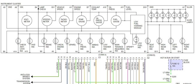

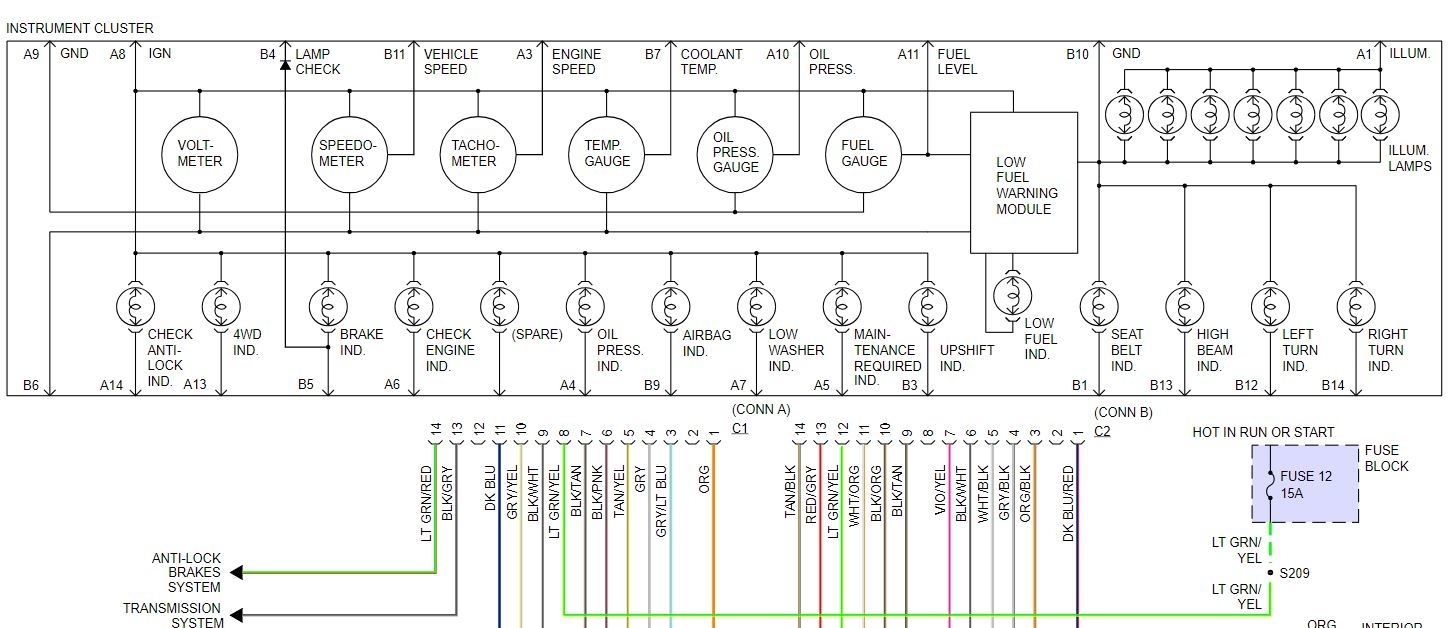

I replaced the fuel pump and I did not have power to the fuel pump. I replaced the PCM. I replaced relays and fuses, so I had to toggle switch the fuel pump and my gas gauge does not work. No power to the gas gauge. Has not had power to the gas gauge since I bought the truck.
May 11, 2018 at 1:02 AM
PATENTED_REPAIR_PRO
  • 1,853 POSTS
That is fed from the fuse #12 in the fuse block along the light green/yellow wire to pin 8 on connector 1 at the cluster connector. Check out the diagrams (Below). Please let us know if you need anything else to get the problem fixed.
