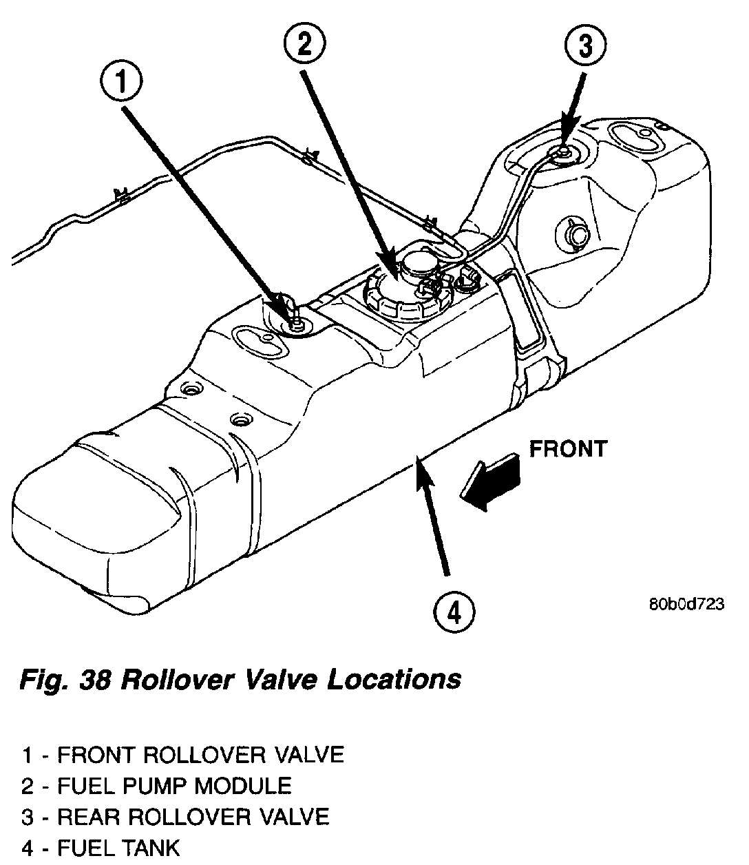

It worked when I first purchased the truck but recently has stopped. Everything else works. what could it be? I thought maybe I would start with changing the electric piece in the cluster? Could that be a reason it didn't work?

It's much more likely there's a problem with the sending unit inside the gas tank, or the wire going to it is cut. The way your mechanic would tell is by using a scanner to see what the sending unit is reading. He can also use it to run all of the gauges up and down to insure they're working.

Chances are the rheostat on the level gauge has failed. To check it will require a multimeter or voltmeter to check resistance. Here are the directions:

The fuel gauge sending unit contains a variable resistor (track). As the float moves up or down, electrical resistance will change. To test the gauge sending unit only, it must be removed from vehicle. The unit is part of the fuel pump module. Refer to Fuel Pump Module Removal/Installation for procedures. Measure the resistance across the sending unit terminals. With float in up position, resistance should be 20 ohms ± 6 ohms. With float in down position, resistance should be 220 ohms ± 6 ohms.

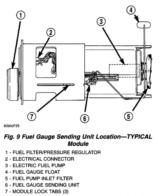

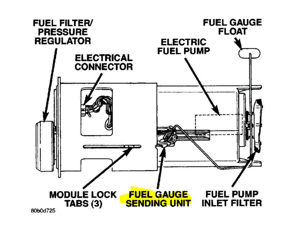

Now, if you find there is no resistance or no resistance, you will need to replace it. It is located on the fuel pump module in the tank. Pic 1 shows the location of the sensor (rheostat).

Fig. 9 Fuel Gauge Sending Unit Location - Typical Module
pic 2
The fuel gauge sending unit (fuel level sensor) and float assembly is located on the side of fuel pump module (Fig. 9). The fuel pump module is located inside of fuel tank.

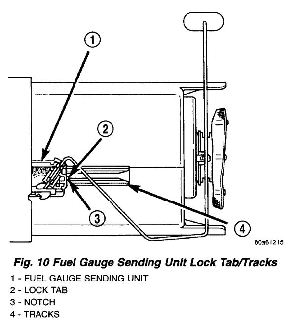

Fig. 10 Fuel Gauge Sending Unit Lock Tab/Tracks
pic 3
5. The sending unit is retained to pump module with a small lock tab and notch (Fig. 10). Carefully push lock tab to the side and away from notch while sliding sending unit downward on tracks for removal. Note wire routing while removing unit from module.

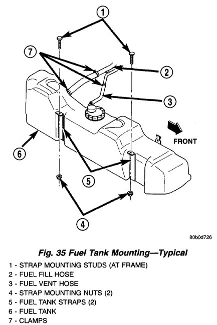

7. Place a transmission jack under center of fuel tank. Apply a slight amount of pressure to fuel tank with transmission jack.
Fig. 35 Fuel Tank Mounting - Typical
pic 4
8. Remove fuel tank mounting strap nuts from mounting strap studs (Fig. 35). If equipped, remove fuel tank shield bolts.
9. Lower fuel tank only enough to allow access to top of tank. The 2 tank fittings (where rubber fuel fill and vent hose connections are made) must be positioned above tank level. Rotate tank slightly to allow these fittings to be above tank level.
WARNING: WRAP SHOP TOWELS AROUND HOSES TO CATCH ANY GASOLINE SPILLAGE.
10. While working over left rear tire/wheel, disconnect rubber fuel vent hose at fuel tank (Fig. 35) (vent hose is the smallest of 2 hoses). Position fuel siphoning/drain hose into this fitting at tank. Drain fuel into an approved portable holding tank or a properly labeled gasoline safety container.

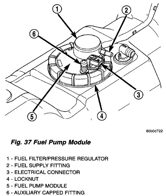

Fig. 36 Fuel Pump Module
pic 5

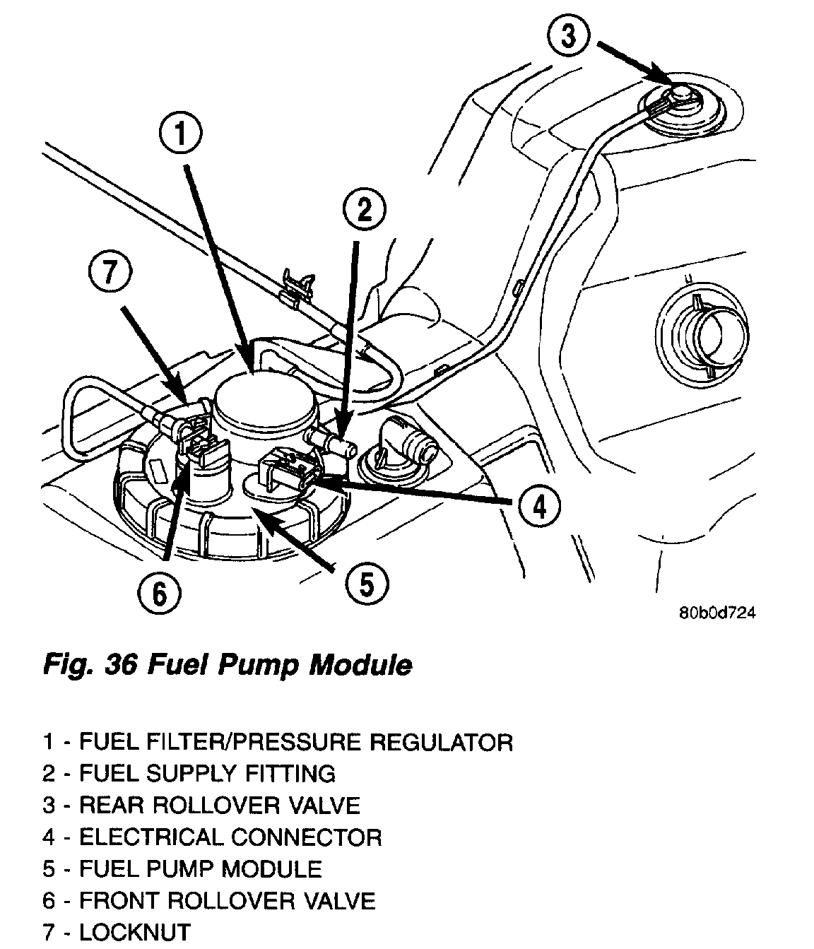

Fig. 37 Fuel Pump Module
pic 6
a. While working over left rear tire/wheel, disconnect wiring harness connector from electrical connector at top of fuel pump module (Fig. 36) or (Fig. 37).

Fig. 38 Rollover Valve Locations
pic 7
c. If equipped with 35 gallon fuel tank, two EVAP lines are connected to rollover valves. Disconnect EVAP lines from rollover valves at top-front and top-rear of fuel tank (Fig. 38).
d. Disconnect fuel supply line at fuel filter/fuel pressure regulator supply fitting (Fig. 36) or (Fig. 37). Refer to Quick-Connect Fittings for procedures.
