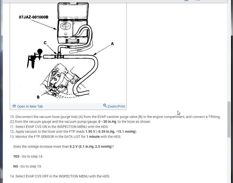

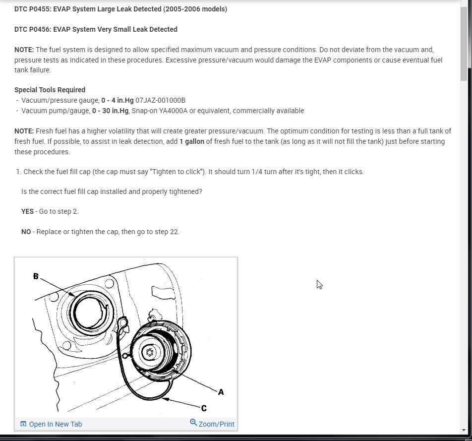

Replaced purge valve and EVAP canister and a new gas cap but keep coming up check gas cap light coming on.
Oct 17, 2020 at 11:15 PM

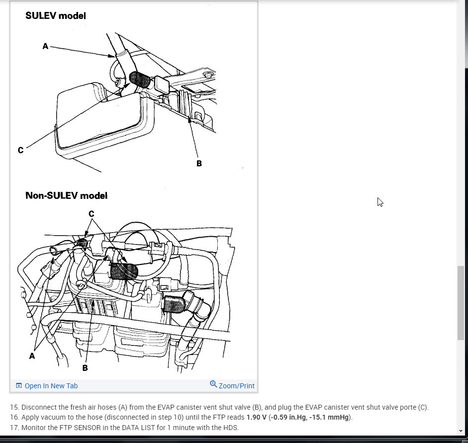

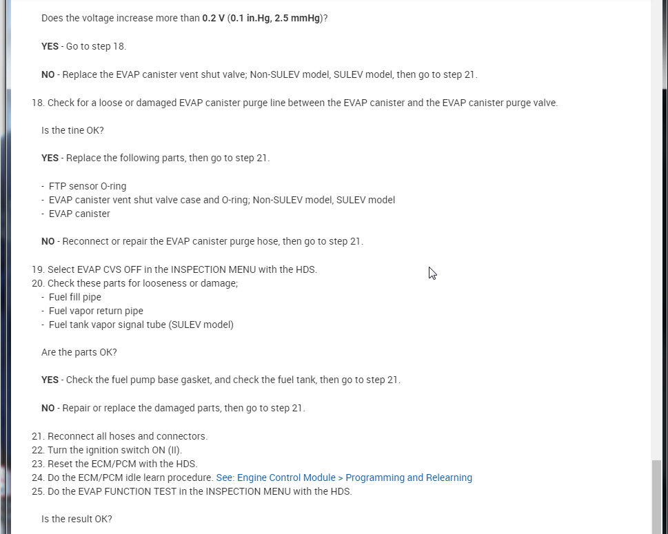

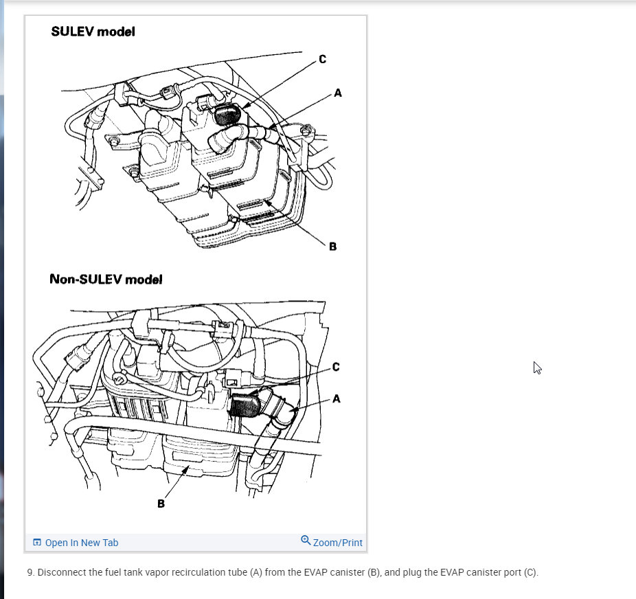

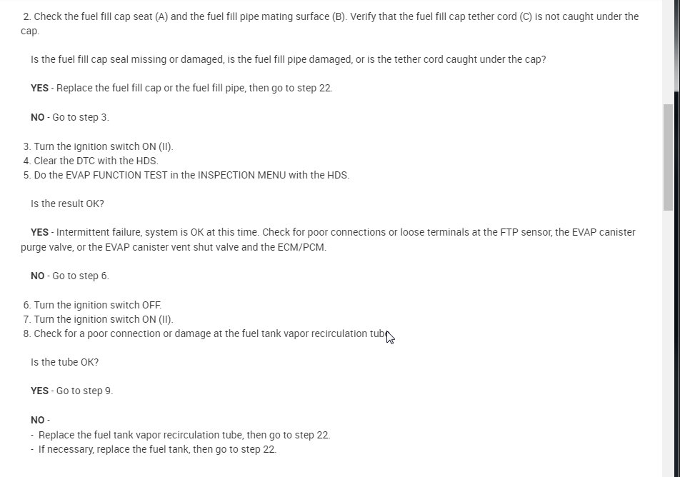

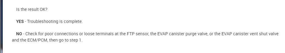

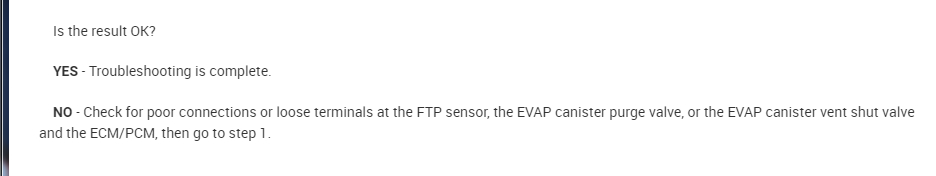

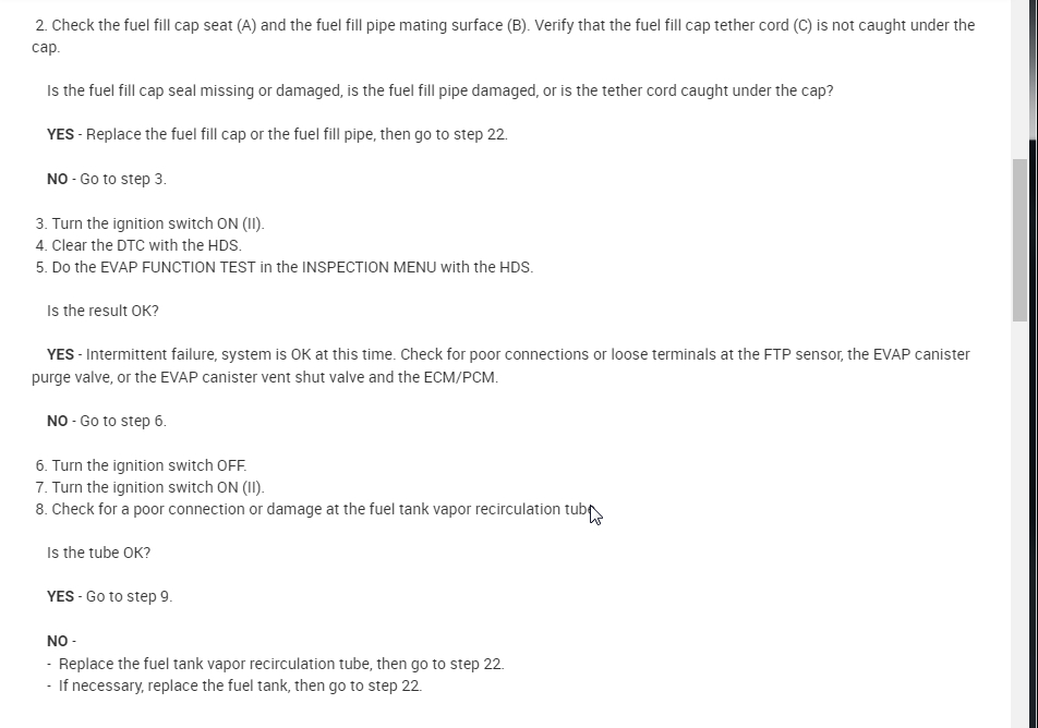

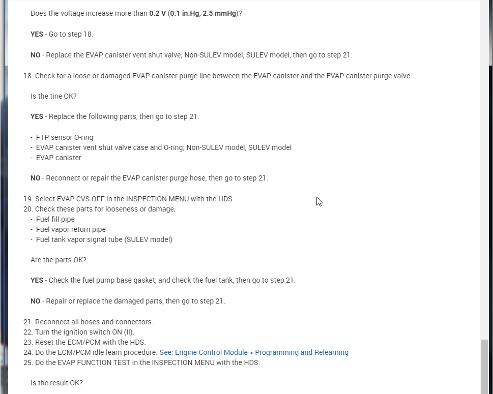

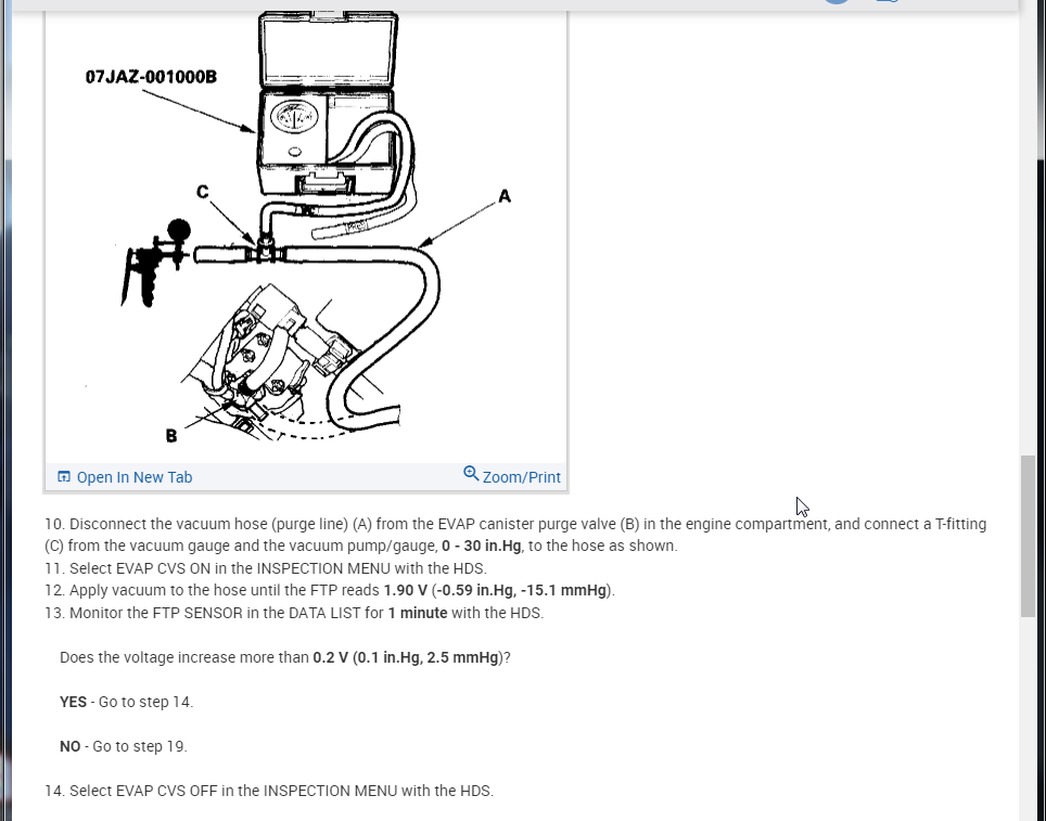

This light is a little misleading. It means that you have a leak in the EVAP system and it could be the gas cap but since you replaced that it means something else is leaking. I attached the testing that we need to perform in order to figure out what needs to be done.
This EVAP system is there to take the fuel vapor and use it in the engine rather then venting it to the atmosphere so when the system is leaking either internally or externally it will turn this light on.
Let's run through this information and go from there. Thanks
