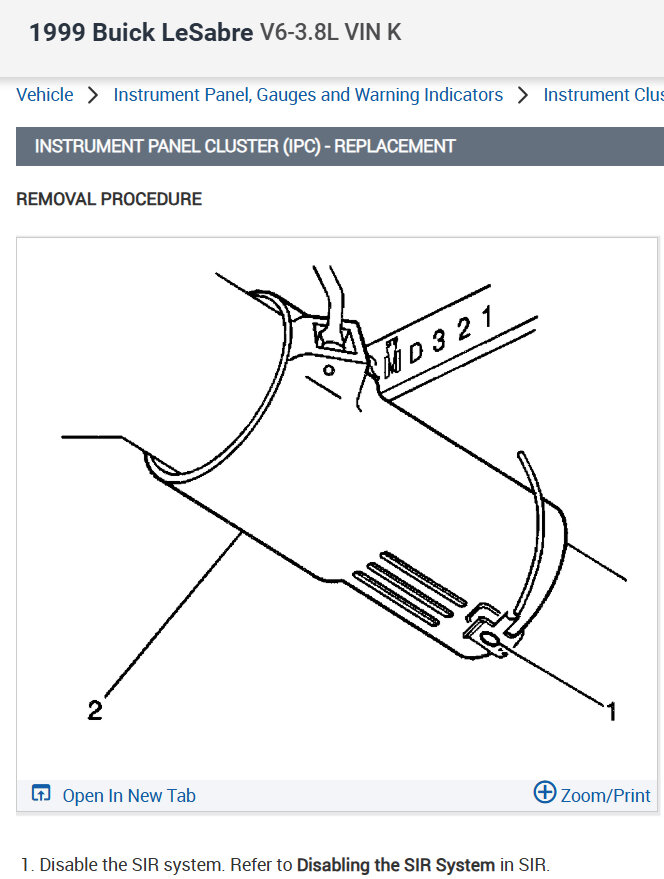

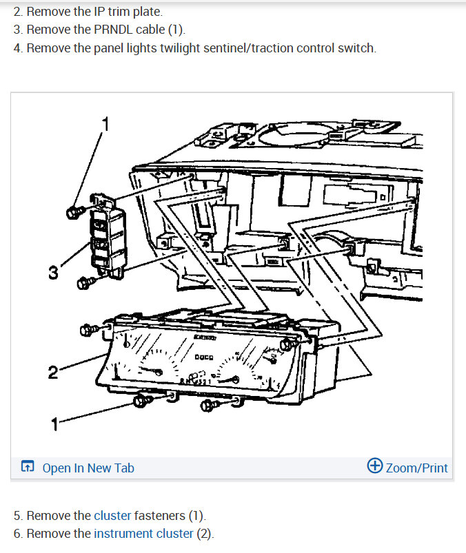

The windows and check engine light will be separate issues, please start new questions for those problems, but the other problems seem like the cluster need to be replaced, here is how the job is done. You can get a used unit from eBay or search Google. Check out the images (below). Please let us know what happens.
