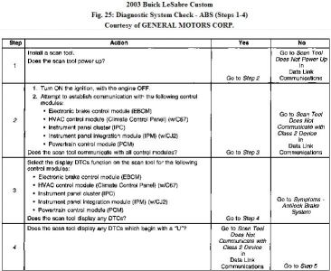

THE TRACTION CONTROL,BRAKE AND ABS LIGHTS ON MY LASABRE INSTRUMENT PANEL STAYS ON AFTER INITIALLY STARTING THE VEHICLE.IS THERE A RELAY THAT COULD CAUSE THIS OR IS THE ABS PUMP NOT FUNCTIONING?WHERE WOULD I CHECK TO SEE WHERE THE PROBLEM EXIST?

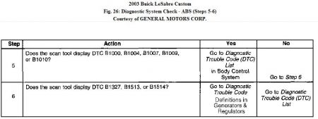

MIKE I FINALLY FOUND A REPAIR SHOP THAT SCANNED THE ABS SYSTEM AND FOUND THE BODY CONTROL MODULE IS BAD,WHICH HAS TO BE HANDLED BY THE BUICK DEALER AS IT HAS TO BE PROGRAMED ONCE THE MODULE IS REPLACED.I HAVE MADE A APPOINTMENT TO HAVE THAT SERVICE PERFORED.THE MODULE IS READILY REPLACED BUT IT HAS TO BE PROGRAMED WHICH TAKES LONGER THAN THE REPLACEMENT .THE PART COST $310.00 WITH THE LABOR THE WHOLE PROCESS TAKES 1 1/2 HRS AND TOTAL COST $455.00.I THOUGHT THE FEEDBACK MIGHT HELP WITH SOME FUTURE INTEREST IN SIMILAR PROBLEMS.THANKS AGAIN FOR YOUR COMPETENT HELP
