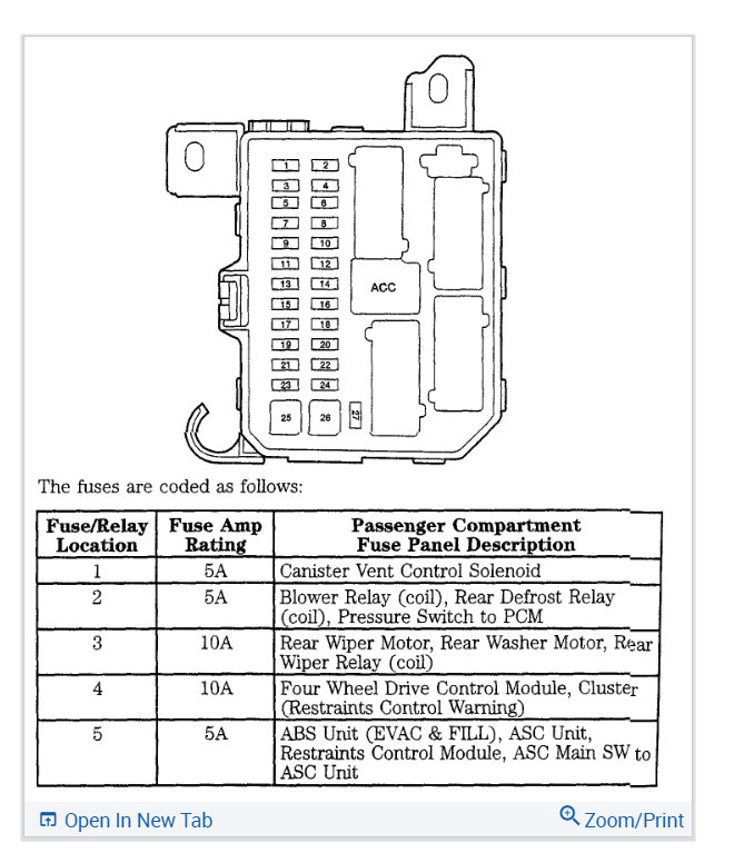

Where do I find the fuse to my alternator?
Nov 15, 2017 at 6:53 PM
STEVE W.
  • 15,344 POSTS

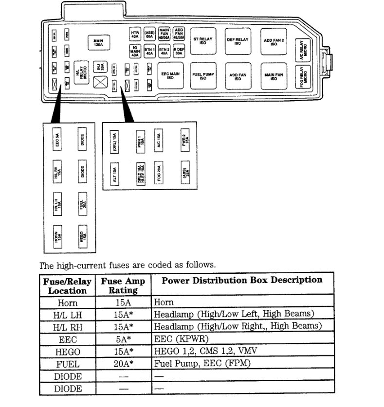

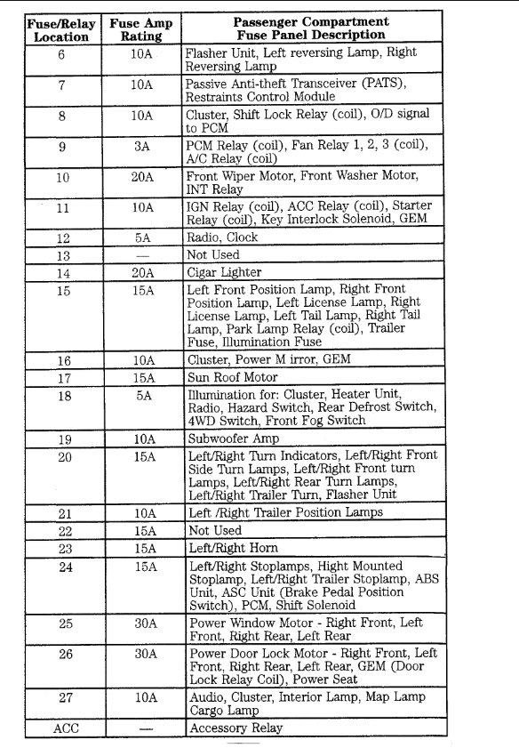

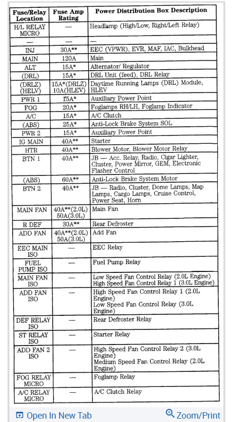

There are four fuses total. Two are in the fuse box at the left side of the dash, those are fuses 8 and 27. Both 10 amp. Then there are two more under the hood in the battery junction box on the drivers side. Those are fuses 11 (15 amp) and FB (120 amp).
What is the issue you are having? Here is a guide to help you check the fuses with the fuse locations in the diagrams below.
