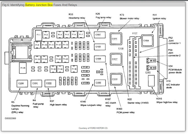

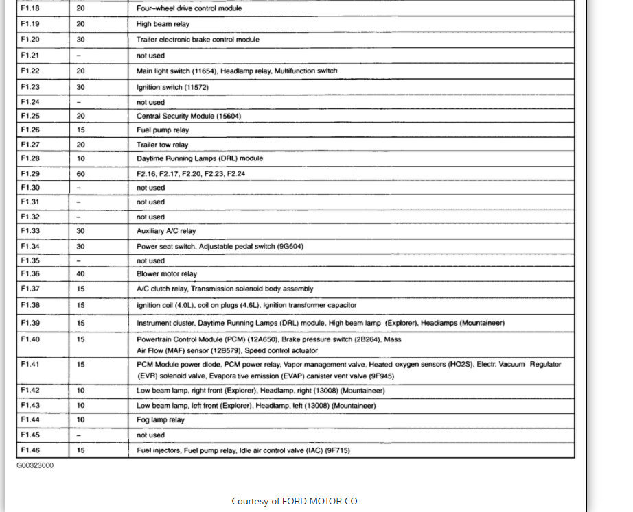

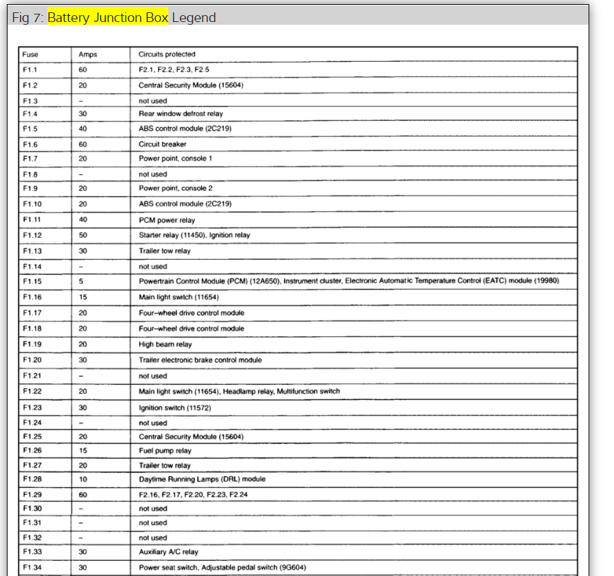

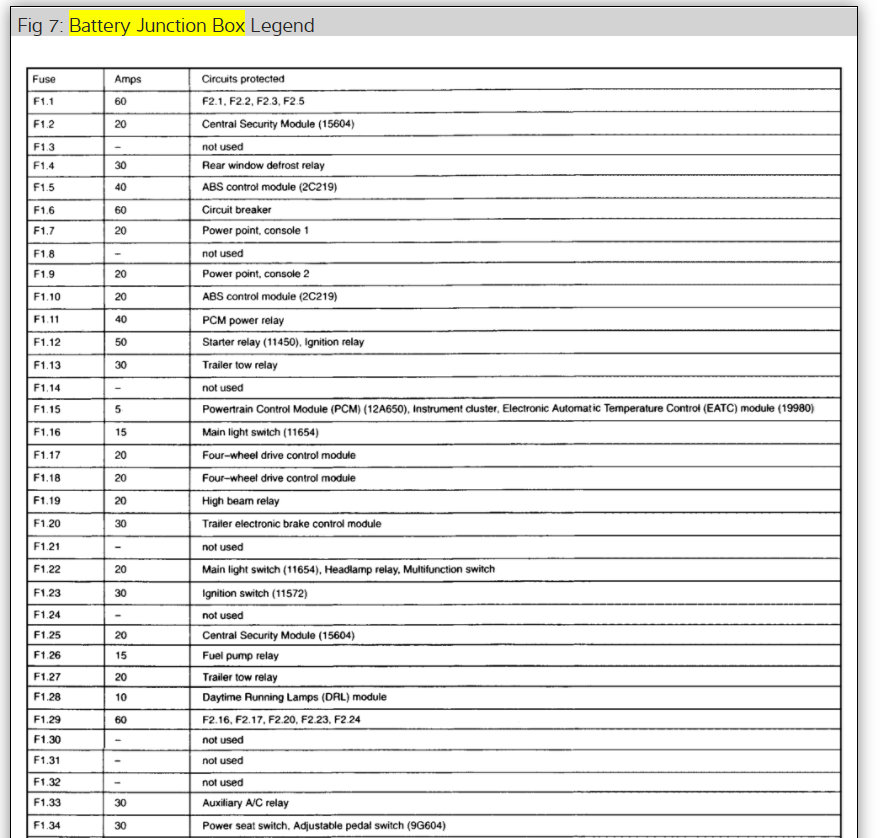

My 1999 Mercury Mountaineer will crank but not turn over, i did a light check on the PCM fuses under the hood and found that I'm not getting any power for the camshaft positioning sensor/EGR vacuum regulator/EVR solenoid/heated oxygen sensor. The fuse is not blown but replaced it anyways still nothing. Those anyone have an idea what could be wrong?

Yes the PCM (f1-15) fuse can cause this issue here is a guide to help you test for power and the fuse location below.
Check out the diagrams (Below). Please let us know what you find. We are interested to see what it is.
