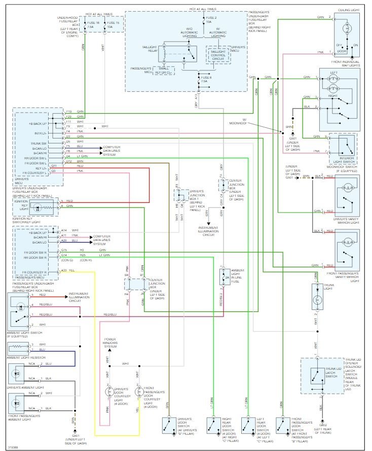

I’m having a problem getting my front passenger interior door light working… I’ve checked the bulbs, the fuses, the harness and the door switch, for the life of me I cannot get it working… has anyone have a solution for me? Much appreciated.

Do the other lights work normally? If you open the passenger side door, do the other lights work normally?
I've attached a wiring schematic for your interior lights. First step would be to check for power on both sides of fuse#15 in the under hood fuse box.
Then I would check for power and ground at the light bulb and work my way back. Remember, you can only test the circuit while the other lights are on, as the car will shut off the lights after a set amount of time.

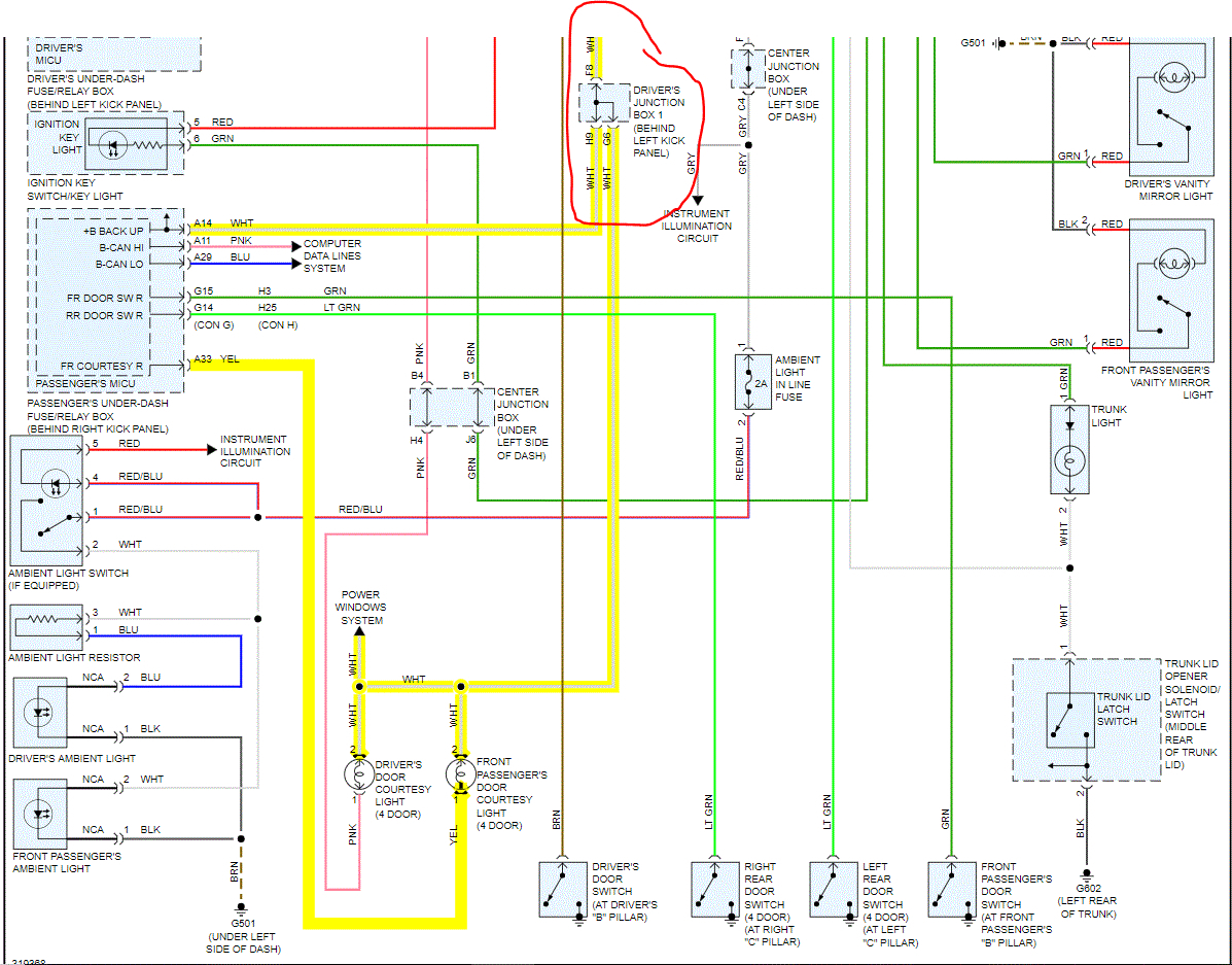

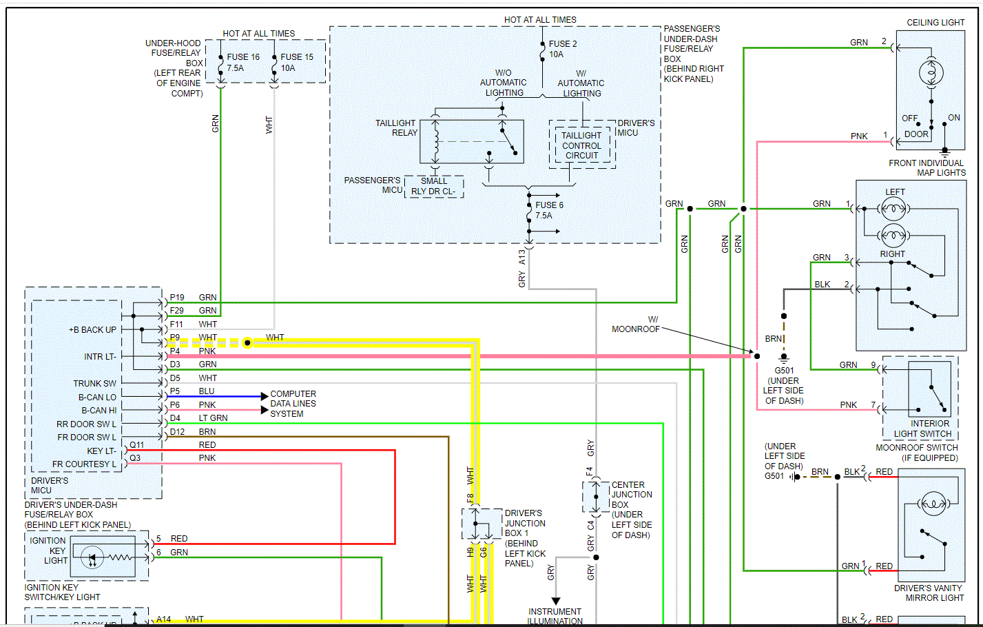

Also, I attached the schematic below that was provided above. I cut the schematic in half to make it easier to read and I highlighted the wiring I need you to check.
Specifically, check the white wire at the light socket for power. The driver's door light works and they receive power from the same place. So, if there is no power, the splice where the two wires are joined may have failed.
Also, if I am reading the schematic correctly, the ground must be provided via the yellow wire. Check that for continuity to ground to make sure it's good.

Check the ground that Joe circled in the diagram he sent you. Clean all those grounds and re-test.

So I checked the grounds… cleaned reconnected and still no power… also I checked the 7.5a Small (Intr) fuse while installed and got no reading… I did get continuity though.
Aug 27, 2021 at 1:05 PM
If the 7.5 amp fuse has no power, you may have a bad fuse box as it is not supplying power to the fuse.
Re-test to confirm.
