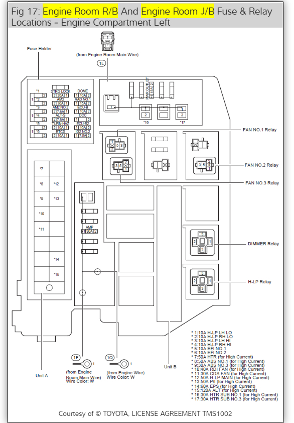

Special tools should not be needed to replace fuses. Most cars have a really big fuse for the generator's output circuit. Because the high current would overheat standard plug-in terminals, these large ones are bolted into the under-hood fuse box.
You cannot get a shock, or jolt, from a twelve volt electrical system, so I suspect he meant there was a huge spark. That would come from shorting the output circuit to ground with the wrench, and that would blow that large fuse. There can be other circuits tied to that output circuit, so do not panic yet when multiple systems are out.
Also, be aware that due to all of the unnecessary computers the engineers have seen fit to hang on our cars, there is a pretty significant current surge when a disconnected battery is reconnected. That too can blow multiple fuses, but only the smaller ones.
To verify that large fuse is blown, use a test light or voltmeter to measure the voltage on the output stud on the back of the generator. You should find full battery voltage there all the time. If the fuse is blown, you will find zero volts there. You can buy a replacement from any auto parts store, but since this is a real low-failure item, you can get one from a salvage yard too.

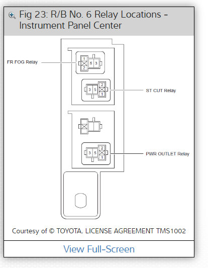

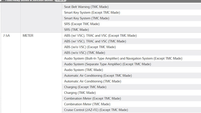

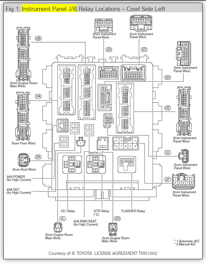

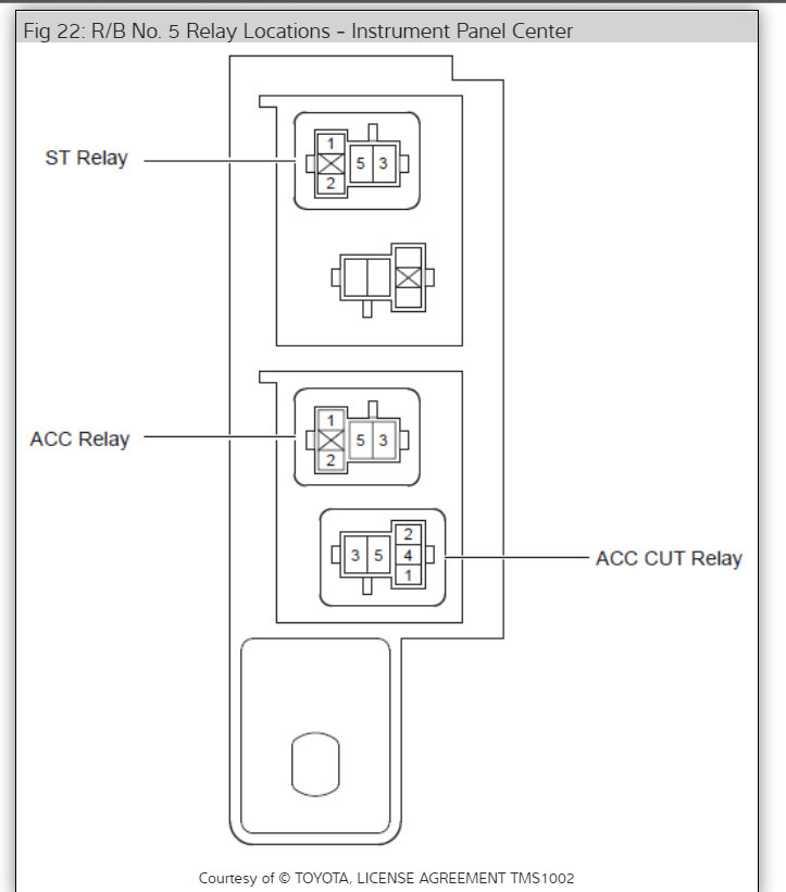

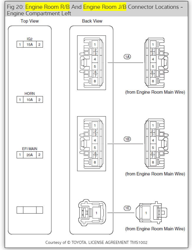

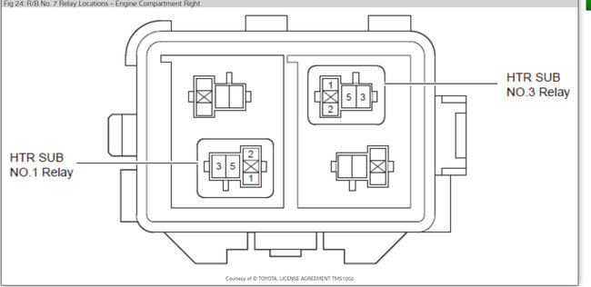

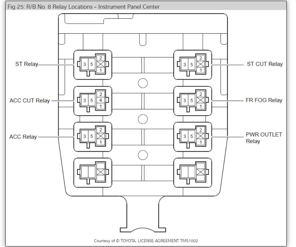

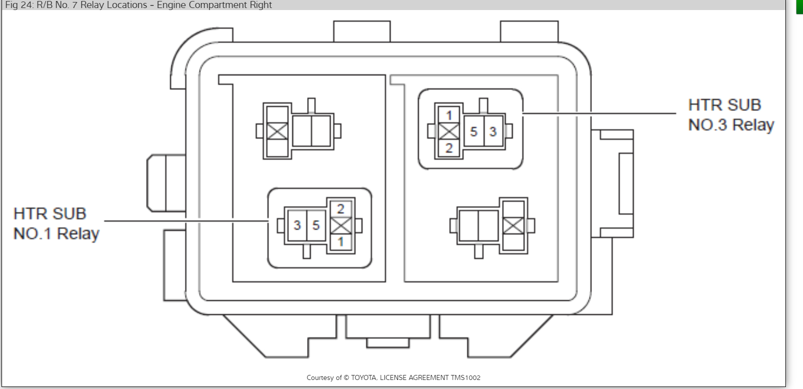

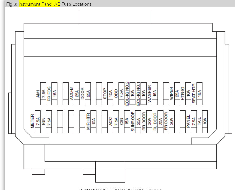

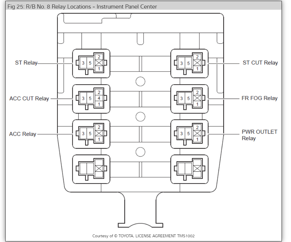

If I can jump in here. do you have any warning lights on ? Here is how you can check the fuses with the fuse location as well:
Dec 16, 2019 at 2:45 AM
