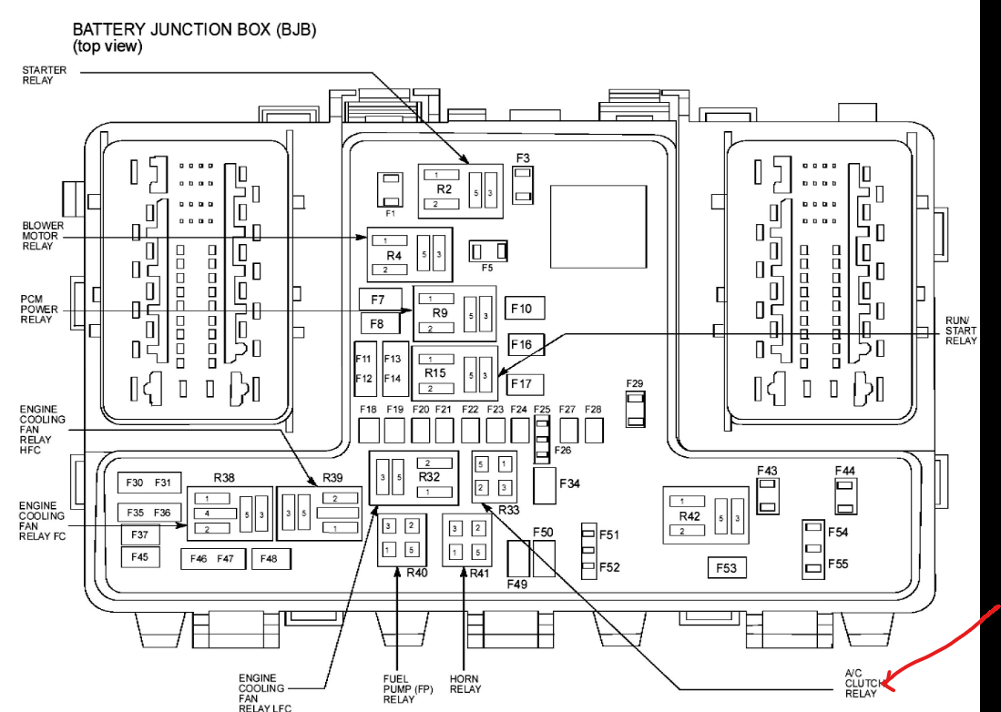

fuse that controls the clutch on compressor is not getting power?
2013 FORD FUSION
95,000 MILES • 2.3L • 4 CYL • 2WD • AUTOMATIC
TRUCKERLANCE
  • 5 POSTS
Replaced A/C compressor after old one locked up and spit clutch assembly off.
I had A/C recharged and double checked all connections are connected. The cooling fan for engine works. I'm still without air conditioning. Fuse 10amp is still good even replaced and nope. Checked all fuses under hood with probe tester and all good except for the fuse that controls the clutch on compressor it's not getting power to just that one.
Jul 21, 2023 at 1:25 PM
  • 55,399 POSTS
There is an A/C clutch relay that I would swap out, here is the location. Check out the images (below). Please let us know how it goes.
Jul 22, 2023 at 8:57 AM
TRUCKERLANCE
  • 5 POSTS
Thank you, sir. Monday I will get a new relay and drop that in there and cross my fingers that's it. I have seen also the evap sensor and its smart location Ford put it that the relay does it. Let you know how goes.
Jul 23, 2023 at 6:09 AM
  • 55,399 POSTS
Please do, yep, they sometimes can surprise you in the locations of some items. lol
