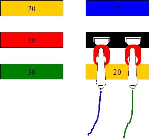

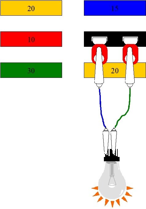

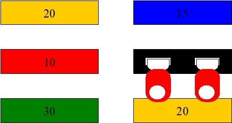

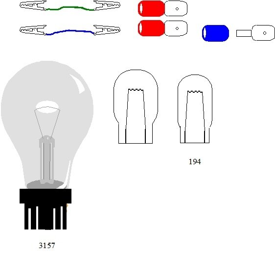

Here's a trick to get you started. Plug a pair of universal crimp-style terminals into the fuse socket. Attach a clip lead / jumper wire to each one, then the other ends to a 12 volt light bulb. I use a 194 "peanut" bulb or a common 3157 brake light bulb because they're easy to connect to. You can find a pack of about ten jumper leads at Harbor Freight Tools for less than five dollars.
With this setup, the bulb will be full brightness when the circuit is turned on and the short is present. The bulb will get hot, so be careful what it is laying against or on. When you do something to make the short go away, the bulb will go out or it will become dim if the circuit is trying to work.

Once you solve the short, the radio will try to work, but the test bulb will be using up part of the 12 volts, leaving much less than 12 volts to run the radio. Reinstall the proper fuse and the radio will work properly.
