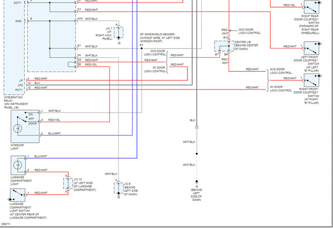

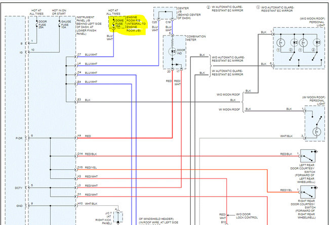

my dome light does not work when i open any door in the car. fuse?
Mar 6, 2021 at 6:04 AM
  • 110,248 POSTS
It could be a fuse, the bulb, or a wiring issue. However, I would recommend starting at the fuse.

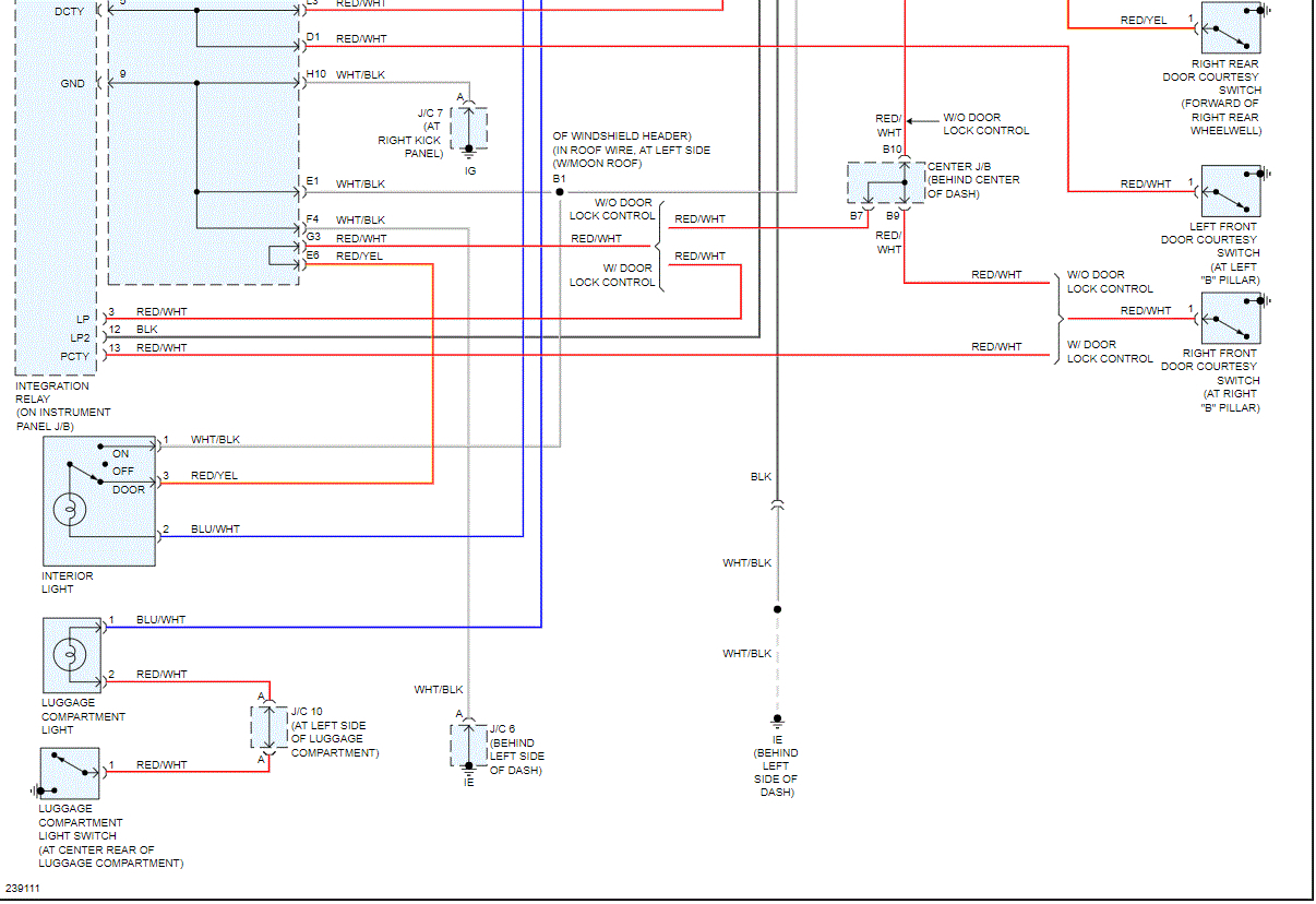

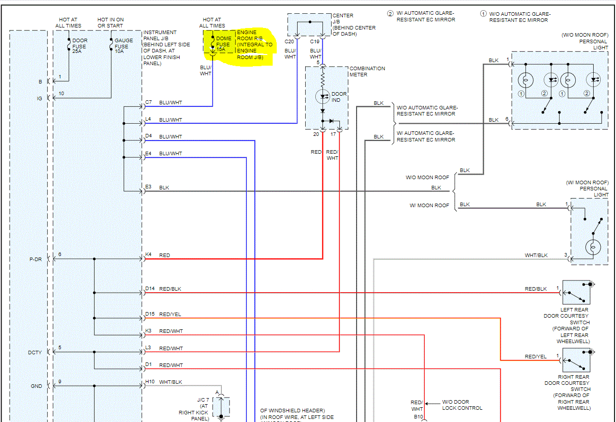

I attached 2 pics below which shows the entire wiring schematic for the interior lighting. I highlighted the dome light fuse. Note, there are two pics. I had to cut it in half to make it readable.
Check that fuse. In addition to checking the fuse, confirm there is power to and from it. Here is a link you may find helpful. My manual doesn't offer a fuse layout diagram. Under the lid of the fuse box will be a legend.
Here is the thing. That fuse powers a few other things as well such as the clock, seat belt warning, and so on. If those are working the fuse is good.
