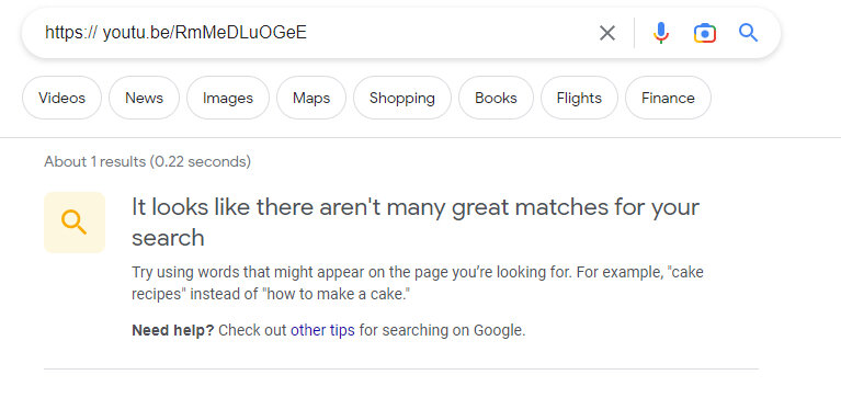

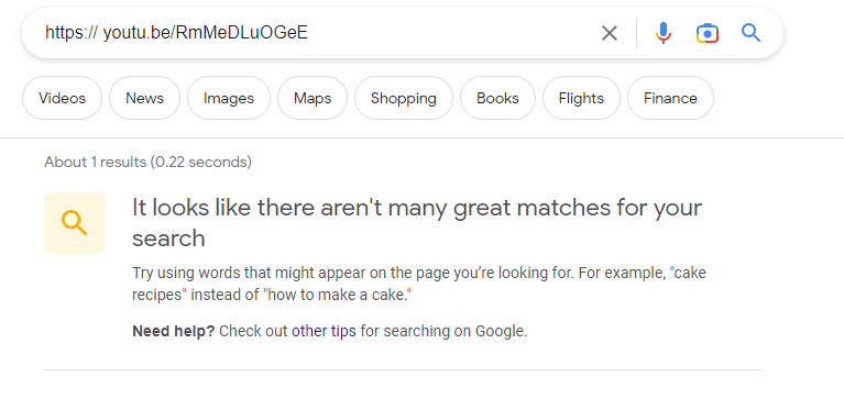

I tried going to the link and wasn't successful. See pic below for what I'm getting.
How would you best describe the noise? Is it a knocking, humming, growing, metallic, and so on type of sound? Does it change with vehicle speed? If it does, is there any change when turning or using the brakes?
Let me know as much as you can.
See pic below.
