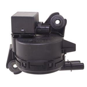

Whenever we get gas on the 2002 Taurus, and put the car in the garage, an unbelievable stench of gas fills the garage and the floors above. I did a pressure test and found no smells or leaks from the fuel rail on down to the tank. But there is an odor of gas coming from the canister mounted under the spare tire.
What could be causing fuel to get into the canister, or is it the canister itself or one of the purge valves? I really would hate to do the filler neck if it's something simple. I have no engine management issues, car runs fine, and no SES light comes on that I am aware of.

Is it possible that you are overfilling the fuel tank? Also, have you checked tank vents to make sure they are clear?

Actually took this one to a garage today, and with a high powered light, they looked and determined the seal on the gas tank is corroded, and wet with gas. So every time you fill the tank and leaks a very little amount, over half a gallon. Garage wants $500 to replace the tank. I reckon I can do it for about $100-200. I did the one on the Mercury Sable, without blowing myself up, so just have to run the tank down so it's not so heavy, and get another one installed.

Is it the tank that is bad or the rubber gasket that is leaking?

I'm not sure, I haven't crawled under there yet. I would assume though, there isn't a rubber gasket around where the seal is, as my mercury didn't have one either. Its just a welded/crimped edge that runs along the entire tank. I suppose I can slide under there and check.
On another note, while I've got you... I assumed incorrectly that the valve that controls the charcoal canister was bad (under the trunk), and wasn't closing when it was supposed to, to draw extra vapor into the engine. I get a strange gas problem, whenever I turn my car at a T either left or right, and it "pops" inside the engine. Also does it whenever I go up steep hills. I can jam the pedal and it takes a few seconds, but eventually I'll climb that hill at 4000 rpm and 55mph. I've replaced the gas pump, replaced the fuel pressure regulator, was going to replace the above mentioned item. Car drives for the most part fine (except at low speeds, where it tends to chug), but its hard to start when it warms up, takes 2-3 key turns to get it going again. Seems to be getting worse. Blew out the lines, replaced the lines, new spark plugs....I'm at a loss at this point. It's the 1998 Mercury Sable DOHC, but basically has the system as the forementioned Taurus.
