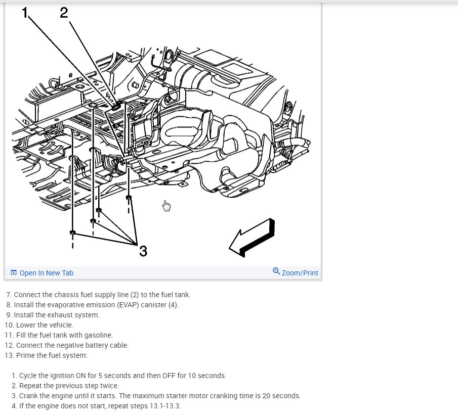

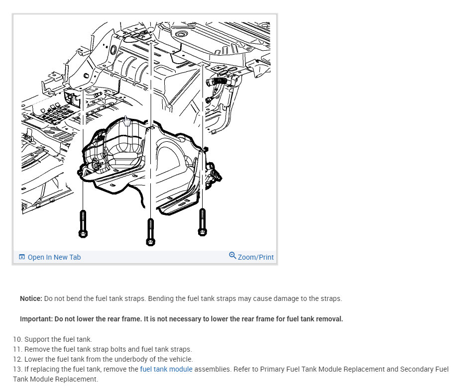

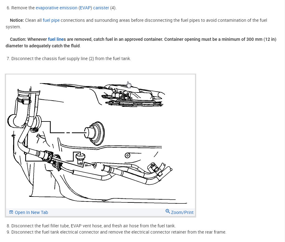

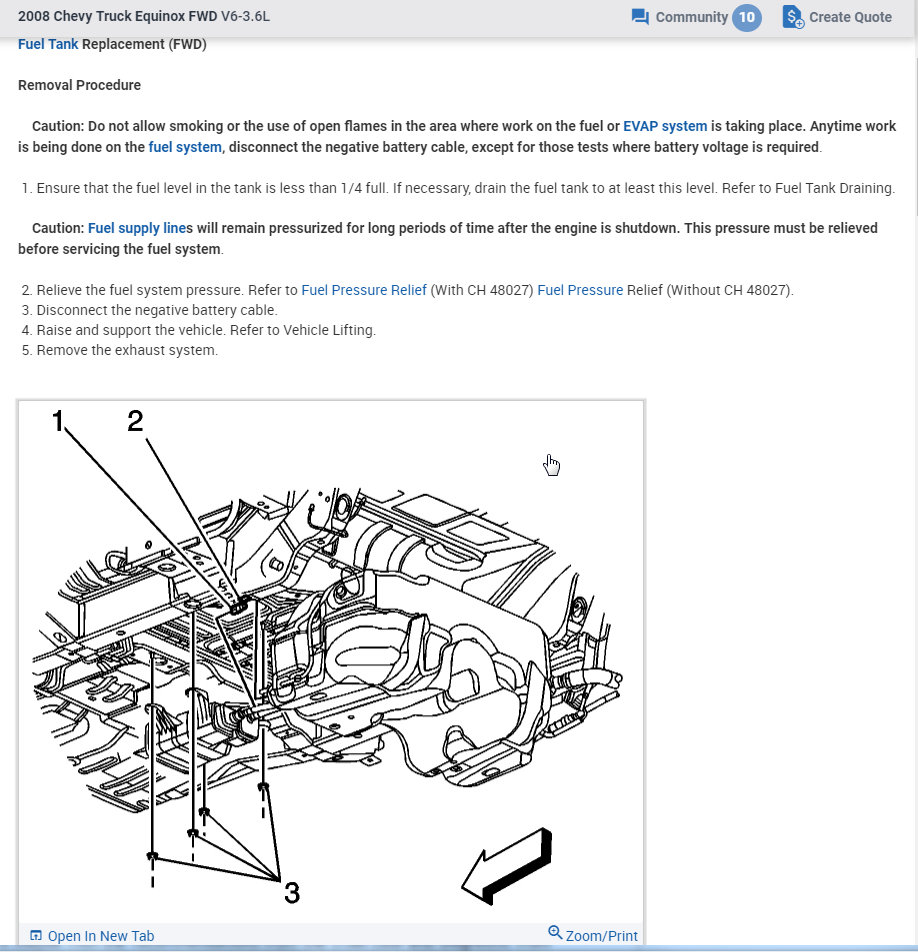

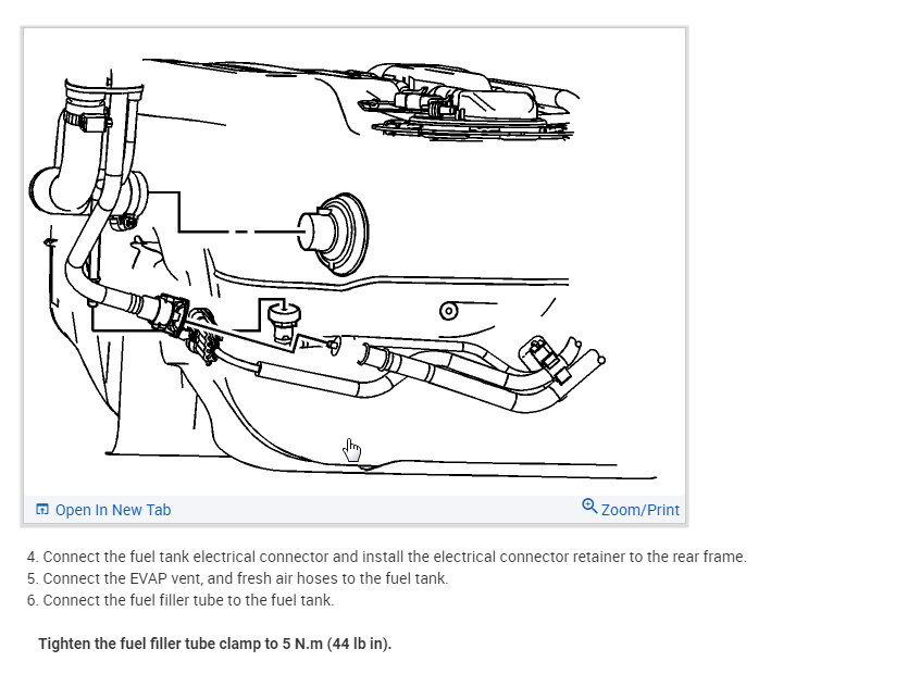

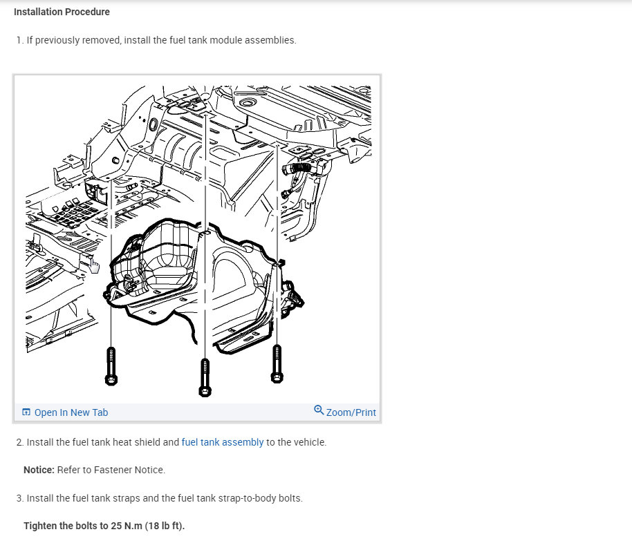

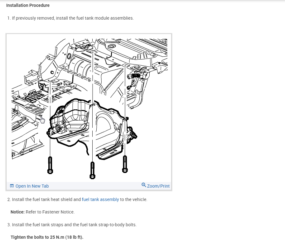

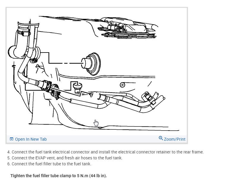

What do you have to remove to get fuel tank out?
Aug 4, 2019 at 10:59 PM
Hi Kenneth,
Here is the entire procedure for removing and installing the fuel tank.
Let me know if you need more information. Thanks

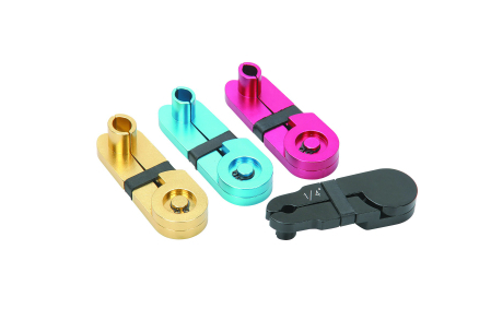

Do I need special tools to remove fuel lines?
Aug 5, 2019 at 9:51 AM
I don't think you need a special tool other than a fuel line tool. I attached the common ones below. I would just get a standard set and one of them will be the right size.
Here is a video that shows someone using a different set:

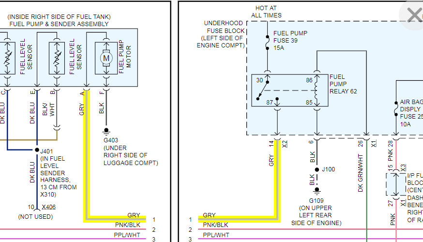

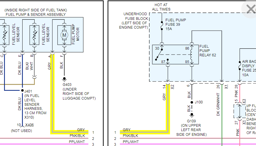

I'm not getting power to thepump I put in I checked fuses and switched relay but test light show no power,
Aug 15, 2019 at 7:53 AM
Okay. If you look at this wiring diagram you will see that the fuse feeds the relay which is a direct feed to the pump. So where do you have power? Do you have power on the fuse? If not, then your B+ feed to the fuse box may be the issue. I just am not sure where you are testing when you say the test light shows no power. Do you have a volt meter? If so, put the black lead on ground and then tell me what the meter says on both sides of the fuse and then what you have on the gray wire coming out of the fuse block.
Aug 15, 2019 at 11:21 AM
KENNETH WILLIAMS2
  • 7 POSTS
Don't have volt meter just test light.
Aug 15, 2019 at 11:26 AM
With the alligator clip hooked to ground, do you have power on either side of the fuse? The fuse should be hot on both side all the time then when the relay is energized you should have power on the grey wire. When you said you had no power, where were you measuring?
