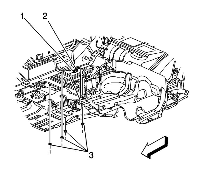

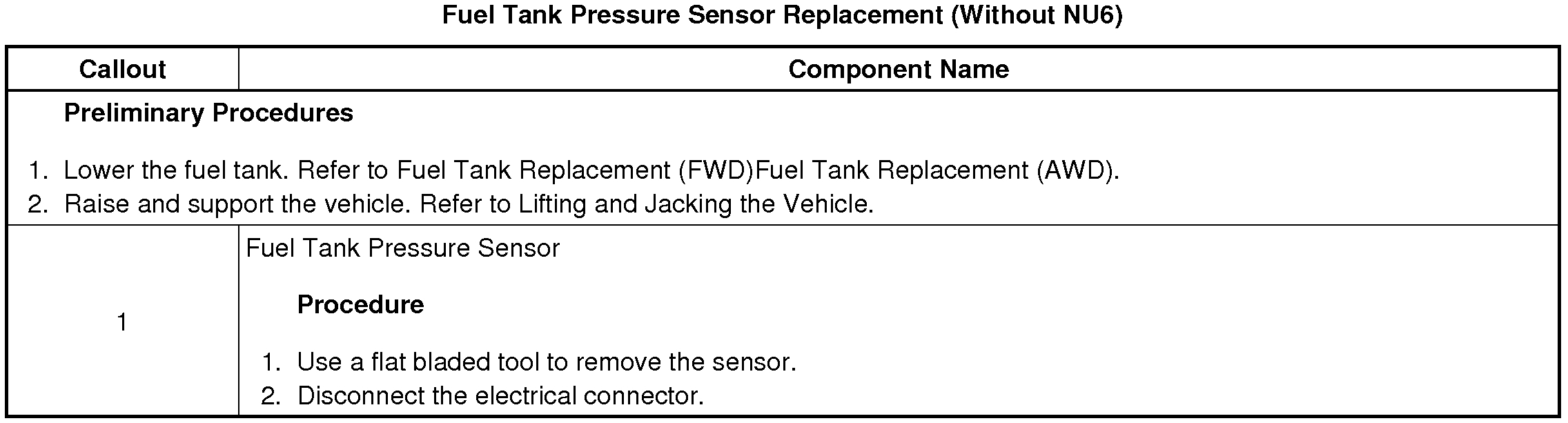

We have problems with engine light coming on we replaced already the fuel cap and still has the light on. I just wanted to ask if the sensor was on top of the fuel tank or inside?
Dec 6, 2018 at 6:39 PM
  • 110,194 POSTS
The fuel tank pressure sensor is on top of the tank. See picture 1 for the location of the pressure sensor. Locate number 2 in the picture. Also, what code is found when the computer is scanned? Does it indicate an issue with the evaporative emissions system (EVAP) or is it specific to the pressure sensor?
If possible, can you provide the code that was found when scanning the computer?
_____________________________

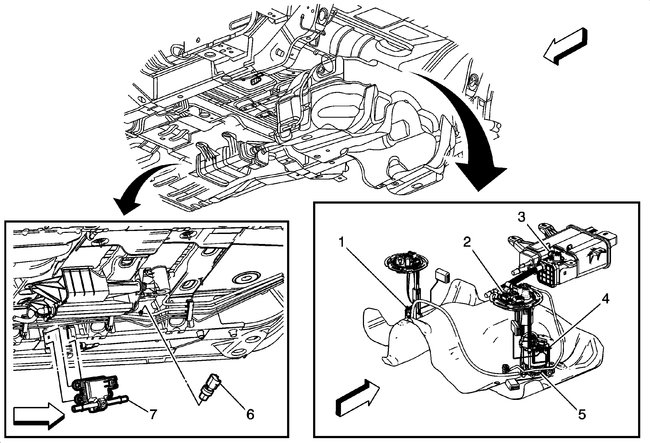

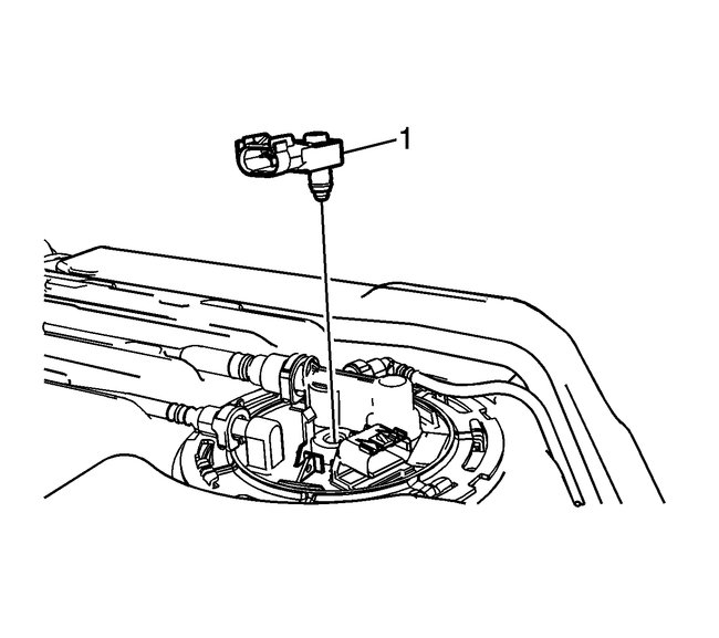

If you are certain the sensor needs replaced, here are the directions.
Picture 2 and 3 are the directions and location of the pressure sensor. Sorry I had to provide the directions in picture form, but it was my only choice.

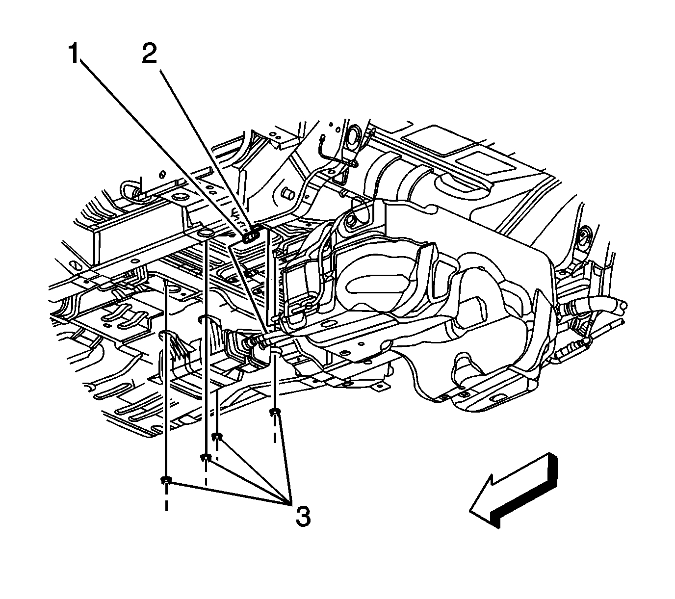

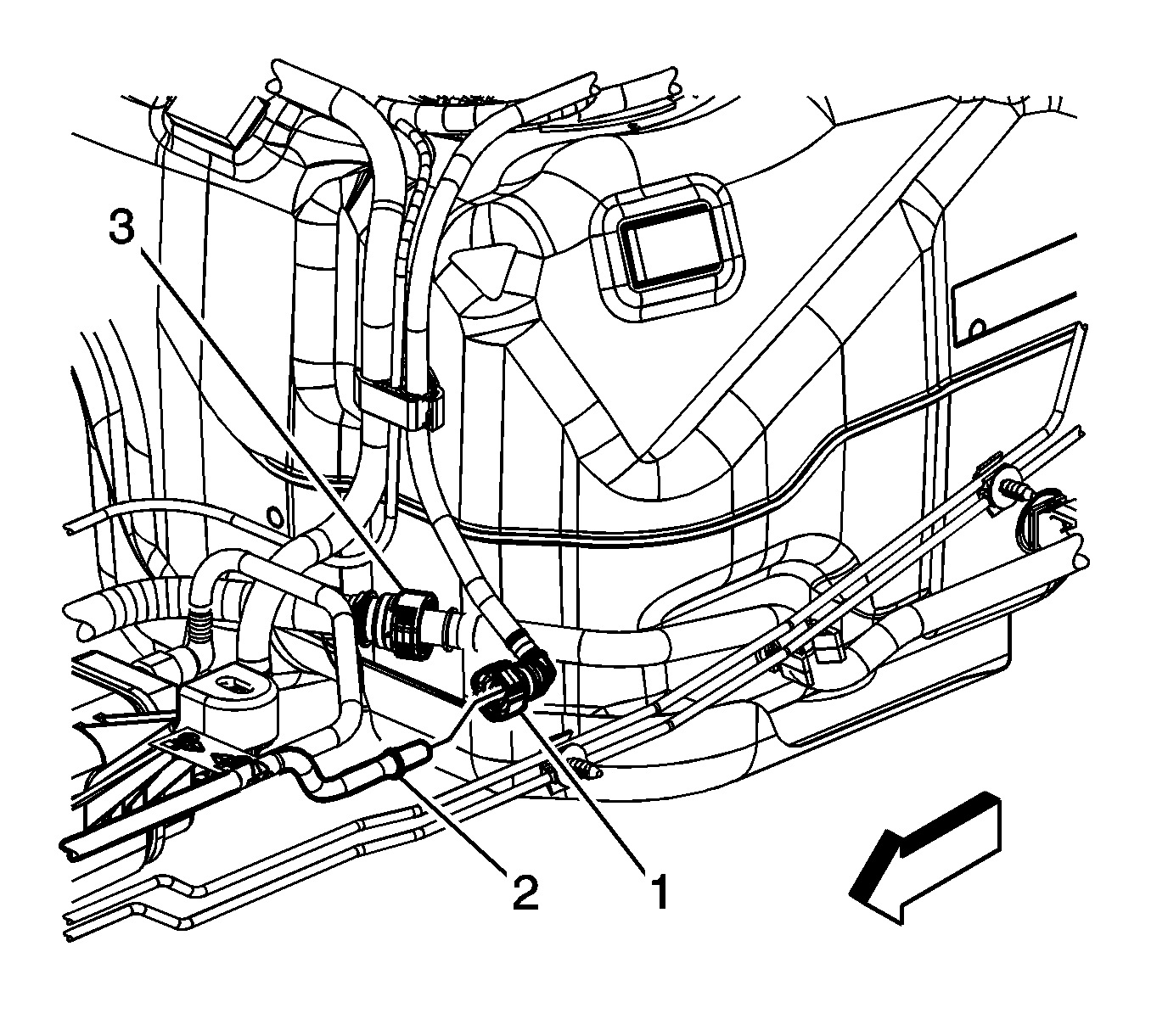

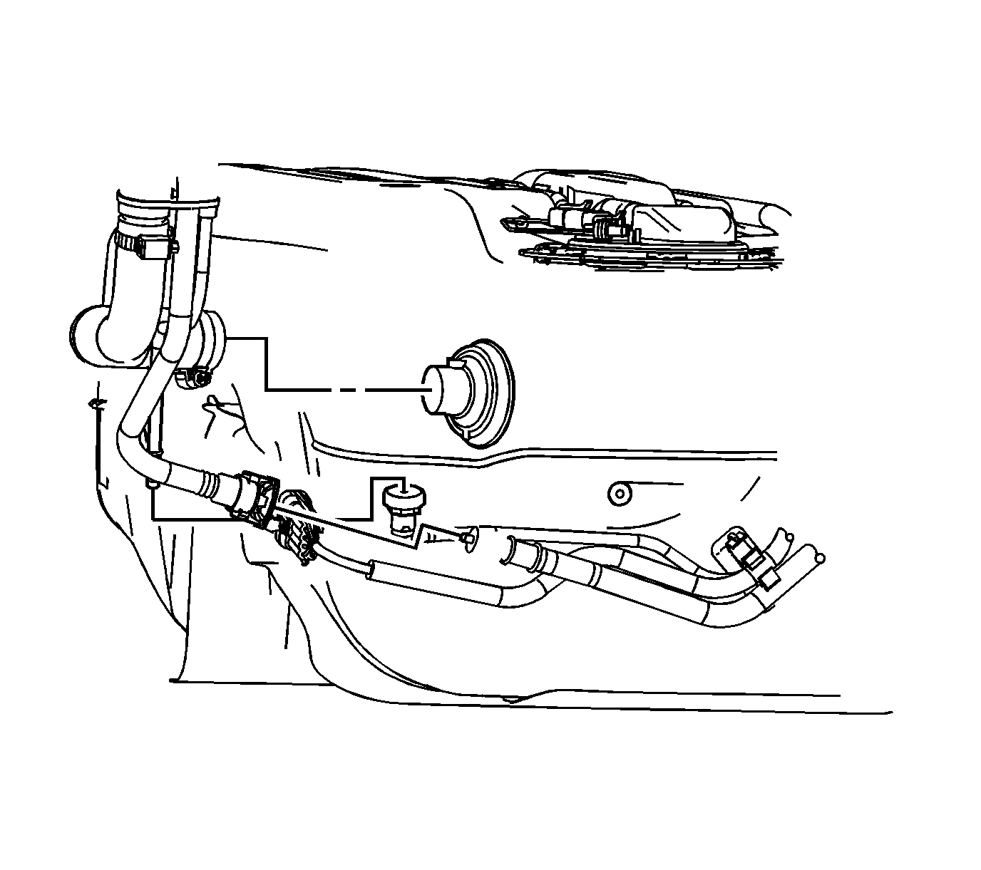

You will need to remove the fuel tank. Here are the directions for tank replacement. You will not be replacing the tank, but the directions provide removal and install instructions. Starting with picture 4, the remaining pics correlate with these directions.

I would hate to see you go through this if the sensor isn't the issue. If you have the trouble code, let me know it so I can confirm this is the actual problem.

The code given from AutoZone was P0455. And thank you for the reply that was so fast and very detailed. You must be beyond professional. I thank you very much.

I am glad you gave me the code because most likely, it is not the sensor. Instead, there is a large leak in the evaporative emissions system (EVAP). The (EVAP) emission control system prevents the escape of fuel vapors from a vehicle's fuel system into the atmosphere.
A bad gas cap, which you already replaced, is one cause. However, there are many other places and components that can cause this. Things as simple as a disconnected EVAP hose can cause this along with other things.
First, after driving the vehicle, park it and see if you notice the smell of gas coming from any areas on the vehicle. For example, around the fuel filler location, around the fuel tank which is located under the vehicle in front of the rear axle, and from under the hood. With a large leak, there is a good chance you will smell fuel vapors.
If you are not able to notice a smell, then I need you to contact a shop in the area that you trust. Ask them if they can fog or smoke test the EVAP system on your vehicle. What they will do is basically force smoke or fog into the system. Where the leak is located, the smoke will come out. It truly is the easiest way to find it.
One last thought, if you can, craw under the vehicle right below the fuel filler location. Inspect the steel filler tube that gas runs through to make sure there is not an issue with rust. Also, make sure you do not see any hoses to the tank or to the filler disconnected or damaged.
Let me know if you have other questions or need help. If you have the system smoke tested, let me know where the leak was located and I can help you repair it or just make sure you are not being taken advantage of.
