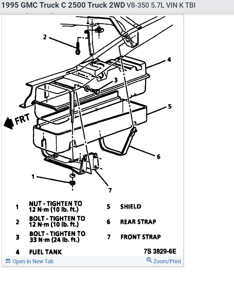

Started the truck to go to the store, was sitting there and idling for maybe 2 minutes then it just stopped running. The gas gauge was showing low fuel, but not out sprayed. carburetor cleaner in the air horn the truck would fire so assumed that it was a fuel problem. I put 4 gallons of gas in it just in case no change. everything appears to be operational there's no pressure to the fuel rail with no fuel relay seems fine, fuse seems fine.

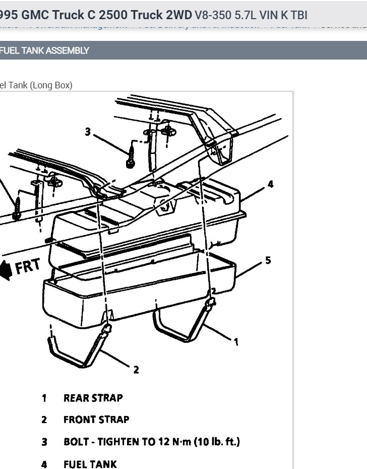

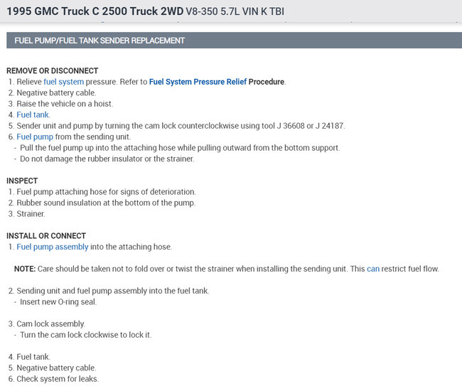

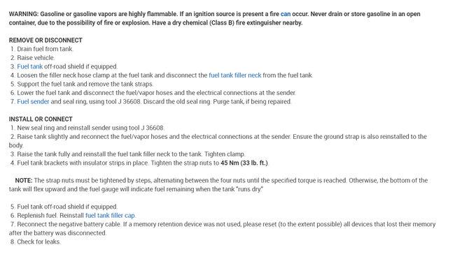

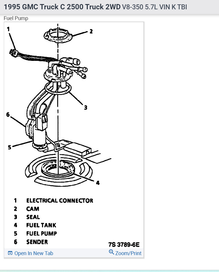

Yep, it sounds like the fuel pump has gone out here is how you can remove the tank to change it out, you must drain the fuel first.
https://youtu.be/Q5MH2gnyFH0
Here is the pump for $48.00 on amazon:
https://amzn.to/3HQ6goS
Please check out the instructions for the fuel replacement in the images below. Please let us know if you need anything else to get the problem fixed.
