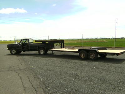

i have a 350 the truck runs great if im running around town as soon as i open the 4 barrels it falls on its face gas spraying out it has new fuel pump. new pickups in fuel tanks the carb is a quadujet that was newly rebuilt
[img:f3893d32a4]http://www.2carpros.com/forum/automotive_pictures/563044_SANY1545_1.jpg[/img:f3893d32a4]

Where are you seeing gas spraying out?

out of the 4 barrel the back two ports

Then you just have a bad carburetor. Replace the carb with one already rebuilt from the factory.

this one is newly rebuilt

It was either done wrong or the housing is damaged and they didn't know it. The carb is bad.

i have also put a holly double pump on it it did the same thing

Maybe your not explaining the problem correctly but the only place fuel can come out of the carb is through the carb itself.
Now, are you getting a backfiring or something like that?
