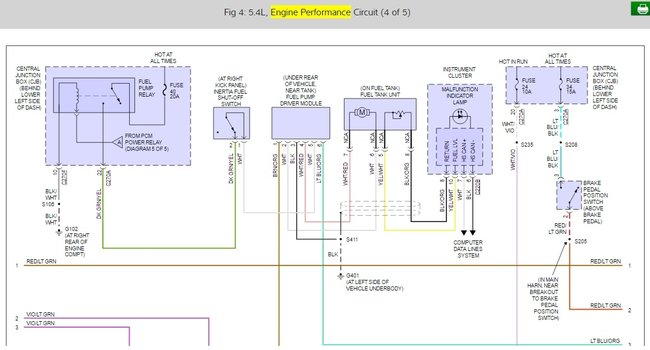

Fuel pump does not prime all the time when switch is turned on. Have replacedthe following:
fuel pump
fpdm
inertia switch
ignition switch
both camshaft sensors
fuel rail presure switch
fuel filter
I am having trouble locating fuel pump relay. The repair man states that it is behind radio. Can the problem also lie with the PCM relay?

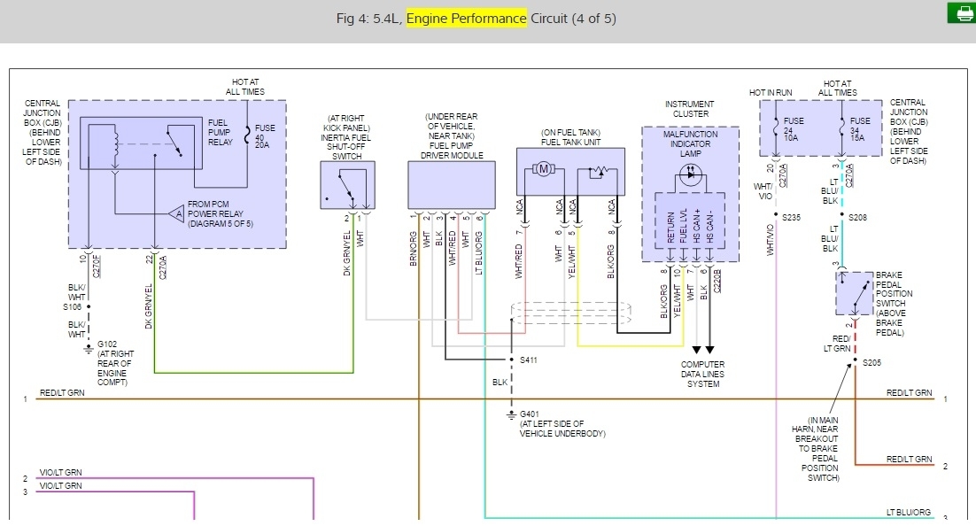

I was able to find a diagram in "Prodemand" as to the location of the relay you requested.
See partial diagram below, upper left corner.

BROLG172
Thanks the schematic was very helpful. I have been unable to find one online it just kept flooding my PC with useless webpages.

BROLG172
Ok.I found a relay behind the radio and changed it out. But still didnt fix the problem
so I changed the pcm relay still no help. The only thing left in the circuit is the fuel tank pressure switch on top of the fuel tank.

BROLG172
Well to answer your question (am I testing along the way?) Not only am I a mechanic. I am a licenced journeyman wireman of over 20 years. So im almost certain that I know how to trouble shoot a wiring circuit. So YES I have tested along the way. FYI it turned out that the only relay behind the radio is not the fuel pump relay after a long and nerve racking search through repaire manuels, internet sites, Q and A forumes, u tube videos, parts store clerks, and yes even the local ford dealership, no one could tell me where this damed relay is located. But a friend of mine put me on aretired ford mechanic that finaly answered my question as to where it is located. IT IS INTERGRATED WITHIN THE FUSEBLOCK ASSEMBLY.
I have one ordered it should be her in a few days.
And I will let you know if this fixes the problem. So someone else does not go through the needle in a haystack routine that I have.
