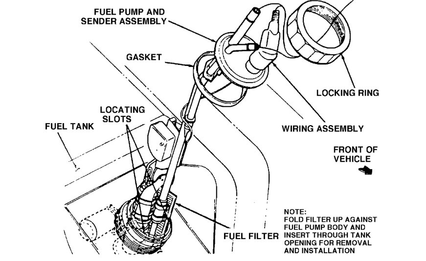

Air in fuel system, no leaks. Fuel reservoir?

Good afternoon,
If there air in the fuel line then it could be coming from the fuel pump in the tank. If the pick up hose or line has a hole in it, it will draw air instead of fuel.
Try filling the tank with fuel and see if it still has air in it.
There is also a high pressure pump along the fuel rail. If there is a hole in the line between the tank and the pump, it will show air in the line.

I pulled in tank pump no holes or leaks. Fuel lines and o-rings look okay. Tank was full when it happened. Check valve in fuel reservoir is disassembled.

Why is it apart?
