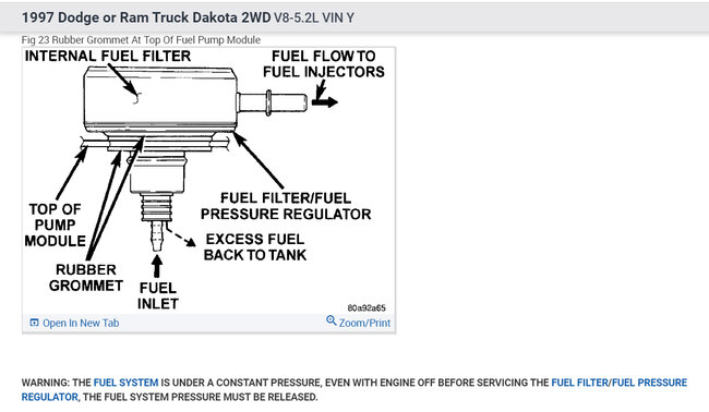

Installed new fuel pump last year but lately it starts and runs great. Drive 10 miles stop 20 minutes restarts at half idle for a couple seconds and shuts off 20 times then starts and gets me home. Restart in an hour, again it starts at half idle and dies over and over until it starts again like it's got some water. When it runs it has full power and has never shut off on the road. When it starts sometimes at half idle meaning very rough like it's just not getting enough fuel to catch then it catches and idles up smooth.
What the heck is going on?

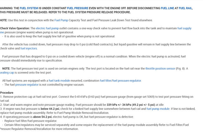

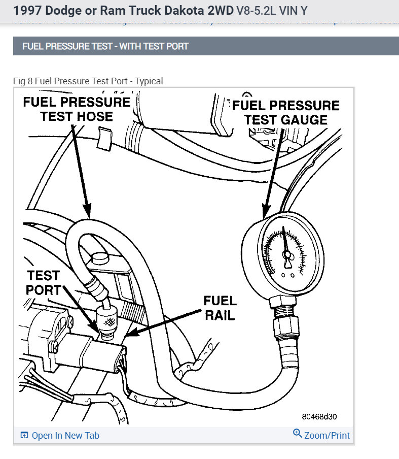

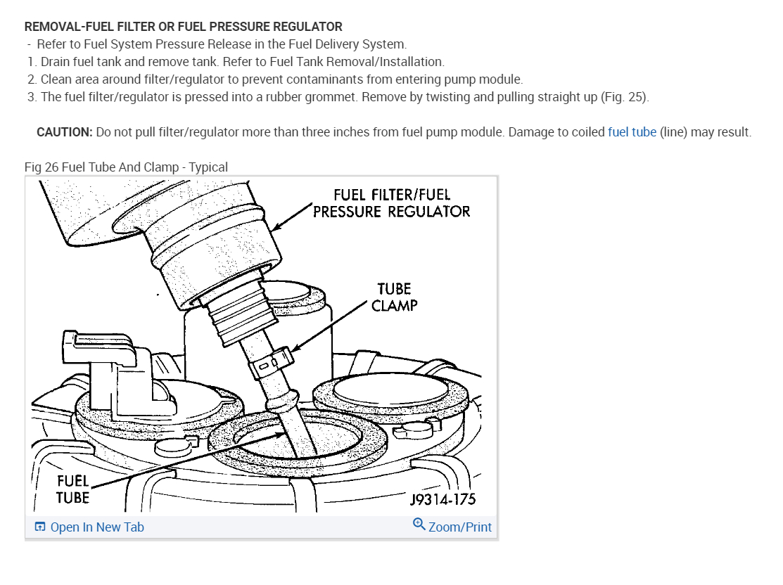

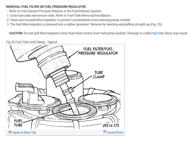

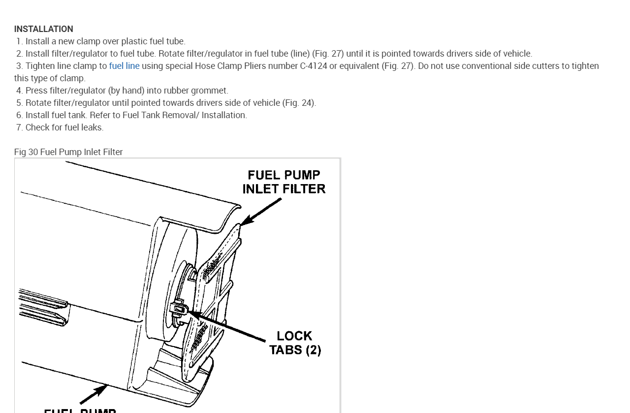

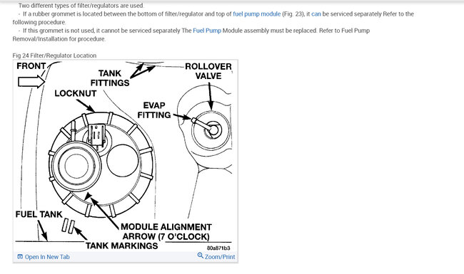

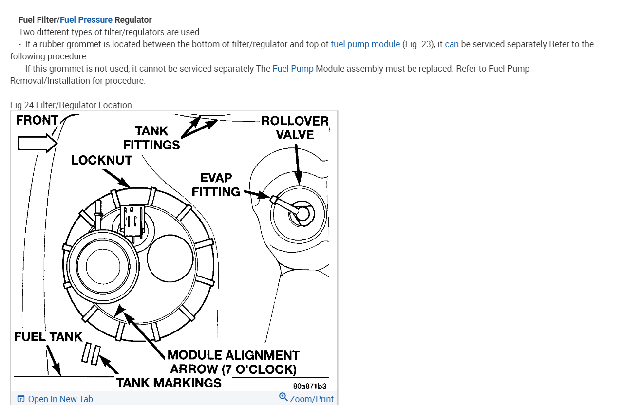

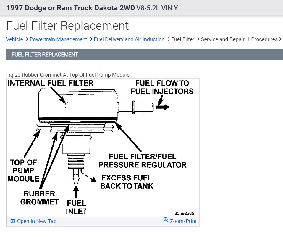

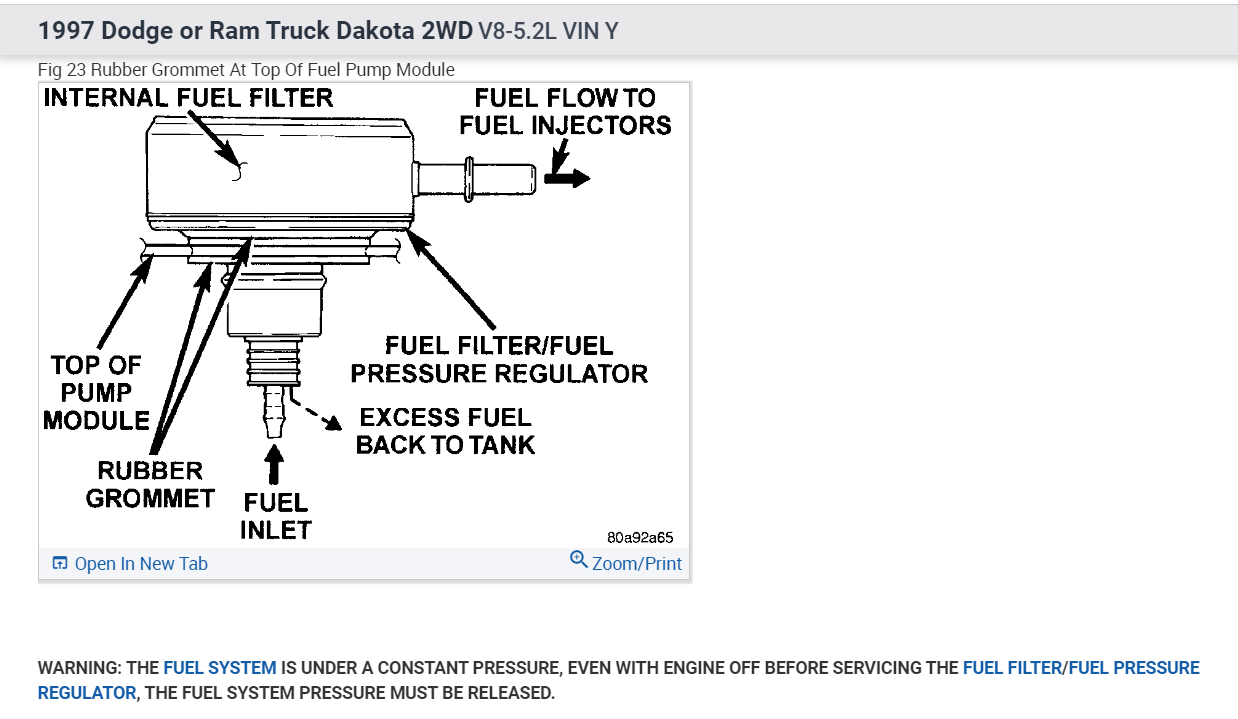

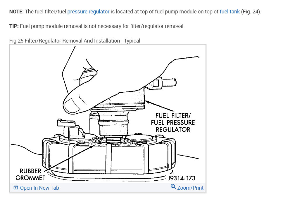

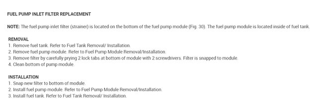

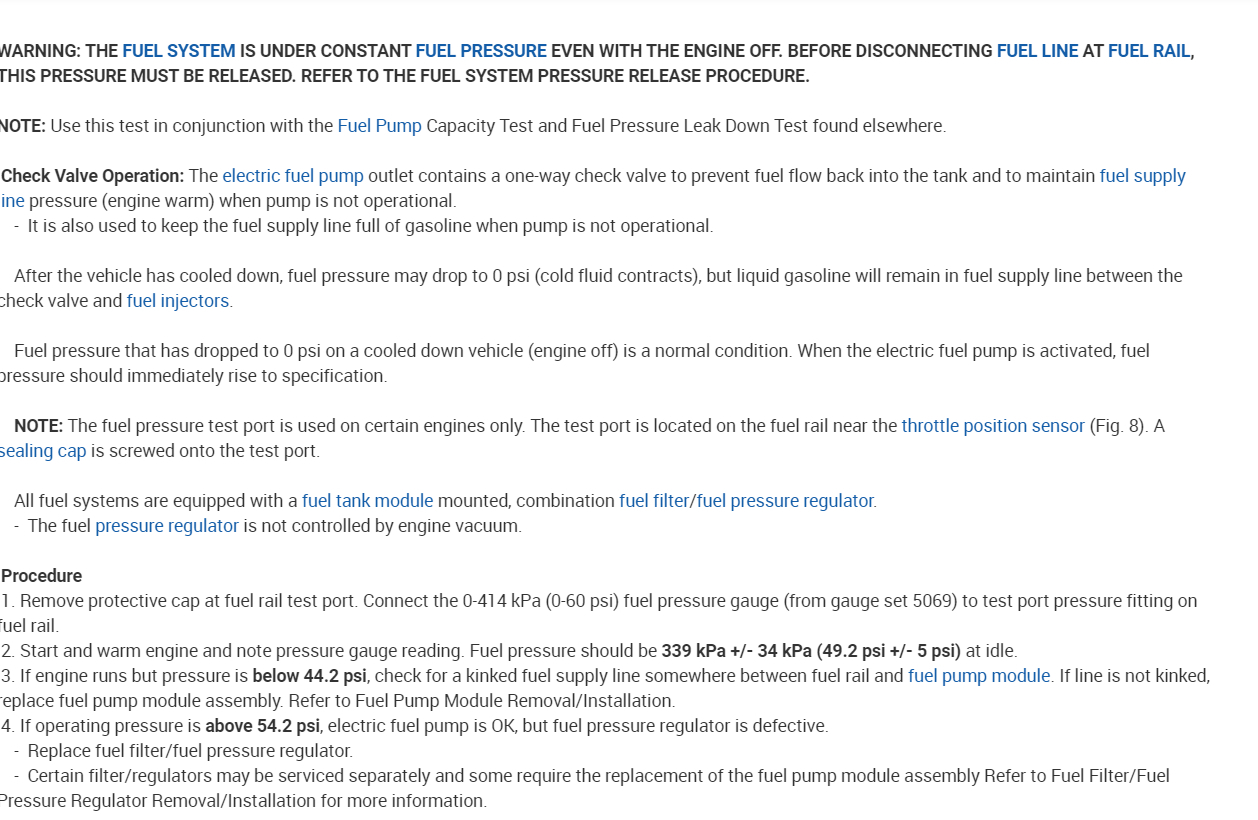

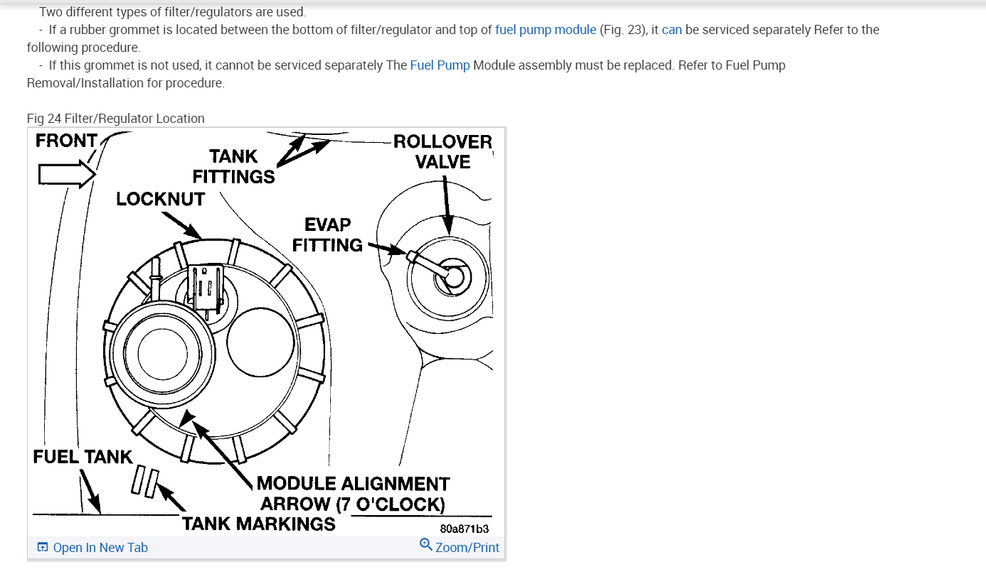

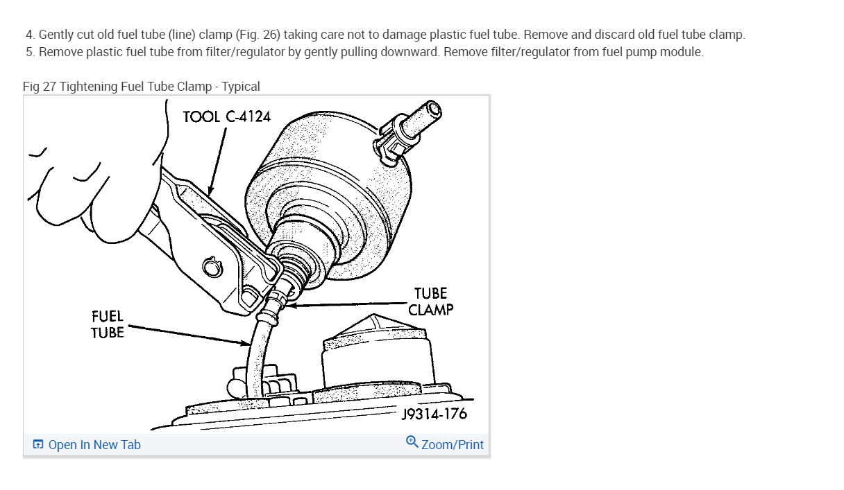

It sounds like the fuel pump is going bad again, but can I ask if you have changed the fuel filter which is the fuel pressure regulator as well? Here is the location of the unit so you can check it out in the images below. Also, we should run the codes and check the fuel pressure.
Here are generic guides for both and instructions below for your truck:
and

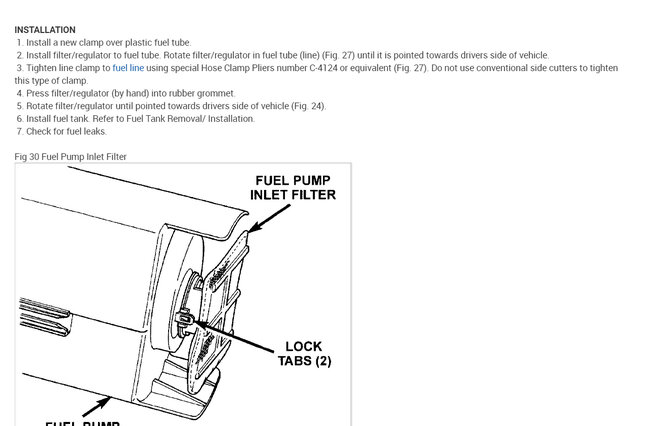

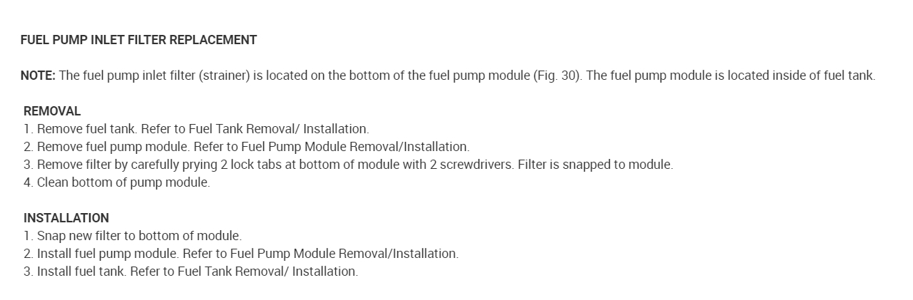

The other consideration is how the pump is replaced. If you buy a complete housing with the new pump and motor inside, it comes with a new fuel level sending unit and a new strainer. Those strainers cause a lot more trouble than the fuel filter. In fact, on older models where the filter is along the right frame rail, the fuel filter typically lasts the life of the vehicle, unless it rusts out and starts leaking. It is very unlikely you'll solve a running problem by replacing the fuel filter on those older Chrysler models. I don't know the history of the newer style with the filter in the tank.
Often people like me look for the least expensive route which is to replace the pump itself and reuse the housing, sending unit and strainer. This is more work but lower cost. Either way it's not addressing the actual cause of the problem. If the old strainer is collapsing from being plugged and the pump is pulling a vacuum on it, the symptoms will return right away. If it's the impeller that's becoming plugged, it takes a few weeks for the symptoms to return.
The solution for repeat fuel pump failures is to have the tank steam cleaned at a radiator repair shop, then install the new pump. As for that strainer, or pick-up screen / sock, mine became plugged twice over 440,000 miles on my '88 Grand Caravan, causing a very intermittent and elusive stalling problem. A new sock cost $12.00 and just snapped onto the bottom of the fuel pump's housing. On my '94 model, that sock was not available or replaceable separately, but I never ran into a plugged one either.

MARWEE, you didn't say what you found for fuel pressure. The second time this happened to my van, I drove for a year and a half with the fuel pressure gauge tied to the radio antenna so I could watch it. The symptoms finally acted up with regularity when I was dragging a tandem-axle enclosed trailer home from an old car show swap meet. That trailer is bigger and heavier than the van. Normal fuel pressure is around 45 - 50 psi. With the really heavy load, the pressure would slowly drop to 20 psi. A lot of engines, especially GM truck engines, show symptoms when fuel pressure drops just five pounds. Mine didn't start to sputter and lose power until pressure dropped to 15 psi, which really surprised me. What I found is if I lifted the accelerator pedal for just an instant, pressure would pop back up to 50 psi, then resume its gradual drop over about 20 seconds. I nursed it 55 miles to home that way. Next few weeks, with no trailer, there were no symptoms again.

First, there is no Schrader valve on my fuel rail to check the pressure and I did not want to cut the line anywhere so when I had a day it would not start, I banged on the tank and just like that it started. I have been starting the truck every day to keep the pump from seizing. so far so good. I bought a Subaru Outback, the truck is for sale while it runs.

If the fuel filter is clogged it will cause the pump to go out. Do you know if they changed the filter, it is mounted to the top of the pump?
