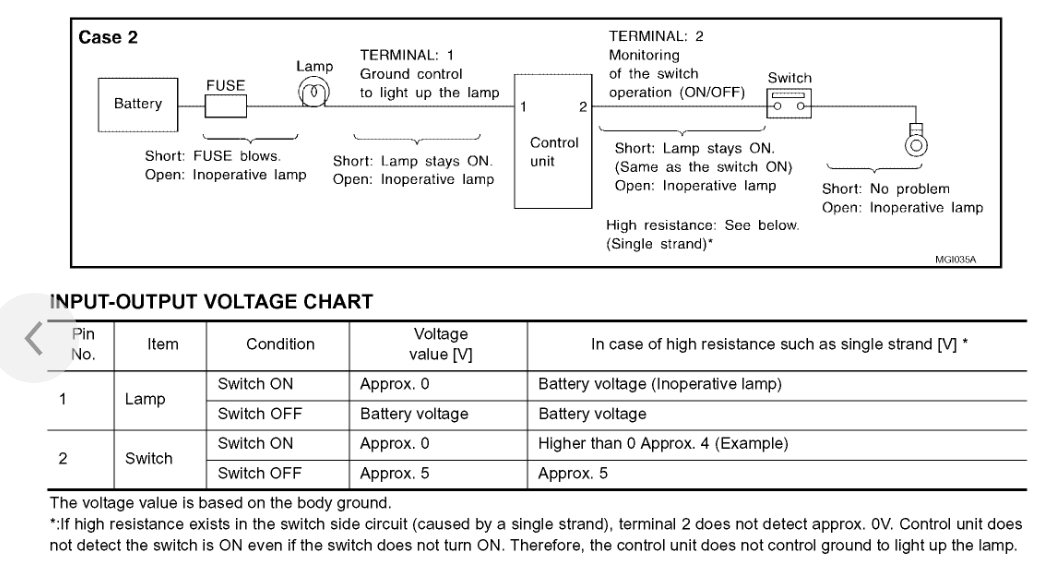

The wires going to the fuel pump and the fuel pump sending unit are probably damaged internally causing unwanted resistance and not letting the full current to flow through to the fuel pump. In the diagrams down below I have included a guide for you on the preferred way to find damage in an automotive electrical circuit called "voltage drop". When you have a damaged part in an automotive electrical circuit, it will take voltage to push the current through the damaged area. By measuring different parts of the circuit, you can easily identify where the damage is and fix it. Please go through this guide and apply it to the wires and get back to us with what you are able to find out. You will need to us a Digital Multi-meter [DMM] to do this, so here is a link down below explaining how to use on if you are unfamiliar with how to use one:

Oct 22, 2019 at 4:22 PM
LILGYP78
I will check into this and let you know my outcome today.
