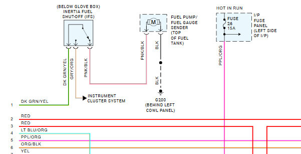

I need the wiring color/diagram for the fuel pump.
Sep 25, 2025 at 3:37 AM
Experienced Mechanic
55,711 POSTS
Sure, here you go, just two wires, check out the images (below). Let us know if you need anything else.
