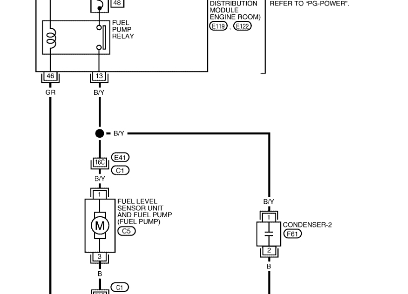

Pump will turn on but will not deliver fuel. I can run a hot wire to the pump and it will work. Installed new fuel pump new IPDM. All I can think is it is getting low voltage to the pump. What is is correct voltage for pump to work?

The voltage to the pump is battery voltage.
Attached is a wire diagram. check the black/yellow wire for battery voltage while cranking.
