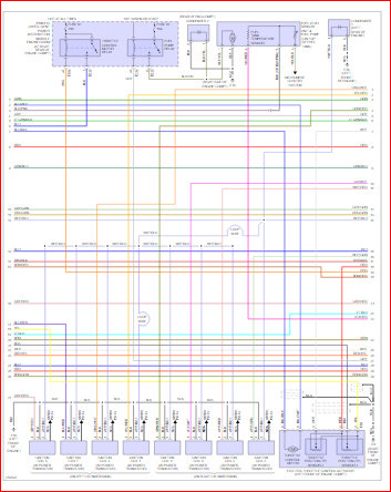

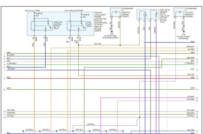

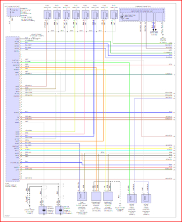

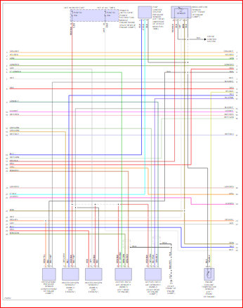

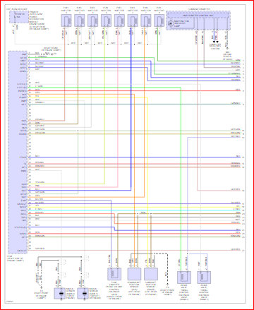

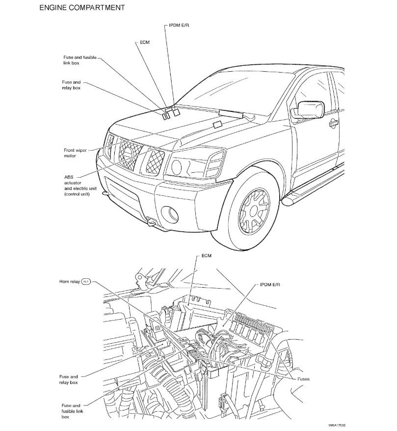

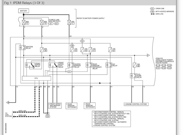

The fuel pump relay is in the IPDM right rear of the engine compartment. Check the diagrams below.
The fuel pump had better not run with just the ignition switch turned on. To do so would pose a serious fire hazard if a fuel line got ruptured in a crash. The pump should only run for one or two seconds after you turn on the ignition switch to insure pressure is up for starting. After that, it only runs when the engine is rotating, (cranking or running).
Pumps are diagnosed by checking for voltage on the 12 volt feed wire. Most mechanics use a test light so they can see it from inside when they turn on the ignition switch. If they see 12 volts for one second, next they check the ground circuit for continuity. If that is good, that just leaves the pump.
If you only have a digital voltmeter, you either have to place it so you can see it from inside the vehicle, or you need a helper to crank the engine. Often digital meters don't respond fast enough to give an accurate reading during that initial one-second pulse.
The test for 12 volts is much more valid if it is done with the pump plugged in and you back-probe the wires through the rubber seal in the connector. Better yet, you should hear the pump run. The problem with testing with a voltmeter and the pump is unplugged is there can be a corroded connector terminal or a break in the wire with just a tiny carbon-track left, and the digital meter will pick that up and give a false "good" indication. You won't get enough current through corrosion or carbon-tracking to run a test light or the pump, so those will give a more accurate indication if the circuit is okay.
Check out the diagrams (Below). Please let us know what you find.

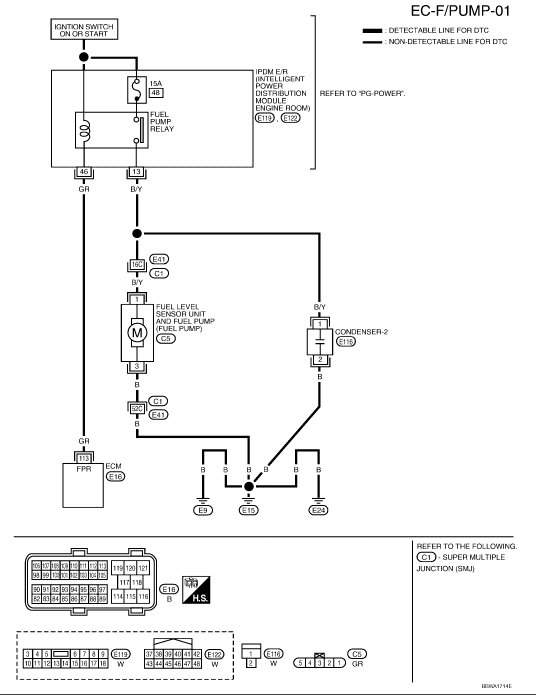

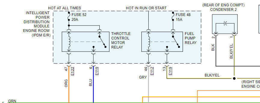

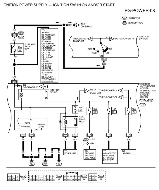

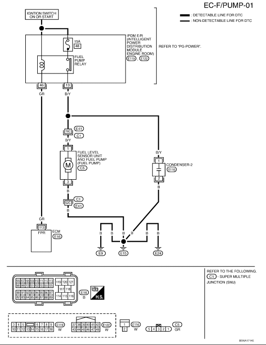

Dandy. About 95 percent of cranks / no-starts are caused by a loss of spark AND fuel pressure and injector pulses. About one percent are caused by just no spark. The rest are caused by just the fuel delivery system, and it sounds like that's what we have. For the loss of spark and fuel, the pump would still run for that initial one or two seconds, but since you don't hear that, we know it's the pump circuit that needs our magic.
First check fuse 48, a 15 amp, in the under-hood fuse box. Next, remove the fuel pump relay from that box and check for voltage on the terminals in the socket. Two of them must have 12 volts when the ignition switch is on. If that's what you find, try swapping that relay with a different one like it, then see if the pump turns on.
If that doesn't work, remove that relay again and do a continuity test on the remaining two terminals, (not the two that had 12 volts). The ignition switch can be off for this test. One terminal should read open. The other one is for the pump motor and should read perhaps one or two ohms. The exact value isn't important now because there's going to be a few ohms of resistance in the meter leads.
Those four measurements were with a digital volt / ohm meter. If you only have a test light, all we care about is you have voltage on two terminals, then, move the test light's ground clip to the battery positive post and test the other two terminals. The light will light up when you find the one going to ground through the pump motor.

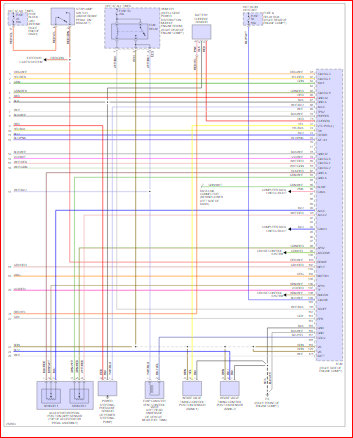

By this time I suspect you will have either found fuse 48 blown or there is no continuity to ground through the pump motor. If everything has checked good up to this point, check for 12 volts on the black / yellow wire at the pump's connector. You can do that while a helper is cranking the engine, but to do it yourself, I find it easier to bypass the fuel pump relay. Right now I'm not 100 percent sure I would tell you the right two terminals to connect, so a safer way is to pop the cover off the fuel pump relay, reinstall it that way, then squeeze the contact. Usually there is a way to wrap a rubber band around it or wedge a piece of thin cardboard in it to keep it turned on. That will let you do the testing without having to crank the engine or even turning on the ignition switch.
Read this guide on testing relays, it will help
See the diagram below for the relay wiring
(USER NOTES : The fuel sensor is integrated into the IPDM and cannot be tested individually.)

DANNY L
  • 5,648 POSTS

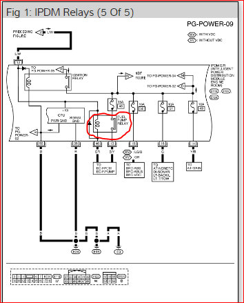

Hello, I am Danny.
Here is a wiring diagram and picture of the Fuel Pump Relay. (I circled the relay- red) *Note: there is also a different wiring diagram if your vehicle is Flex Fuel capable. Hope this helps! Danny-

STEVE W.
  • 15,407 POSTS

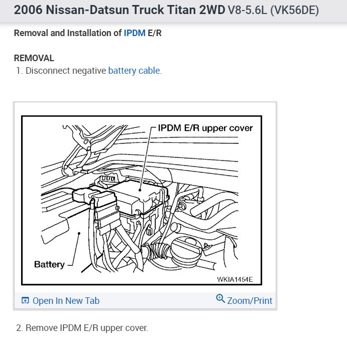

Looks like it is in the under hood smart fuse panel. It may not be a replaceable item without replacing the box itself or wiring in an external relay. The labor they show for replacement is the same as replacing the entire box.
See the diagrams below for component location and wiring diagrams

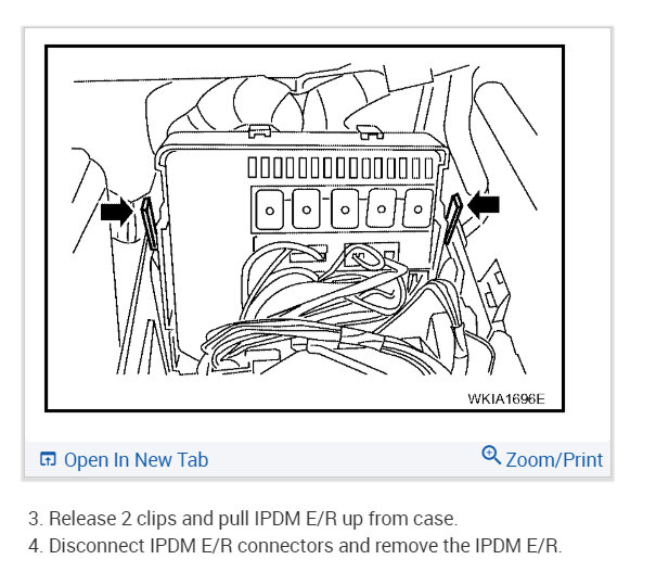

Good morning,
The fuel pump relay is part of a power module under the hood. In that module are several relays but the bad news is they are not serviceable as the entire module has to be replaced if the fuel pump relay has failed.
IPDM E/R (Intelligent power distribution module engine room)
System Description
- IPDM E/R (Intelligent Power Distribution Module Engine Room) integrates the relay box and fuse block which were originally placed in engine compartment. It controls integrated relays via IPDM E/R control circuits.
- IPDM E/R integrated control circuits perform ON-OFF operation of relays, CAN communication control, etc.
- It controls operation of each electrical component via ECM, BCM and CAN communication lines.
CAUTION: None of the IPDM E/R integrated relays can be removed.
