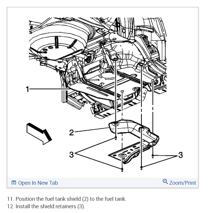

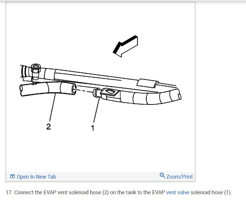

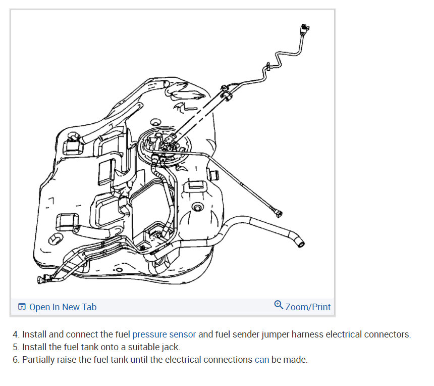

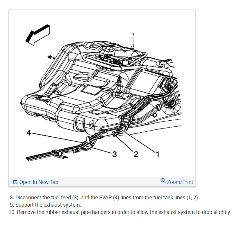

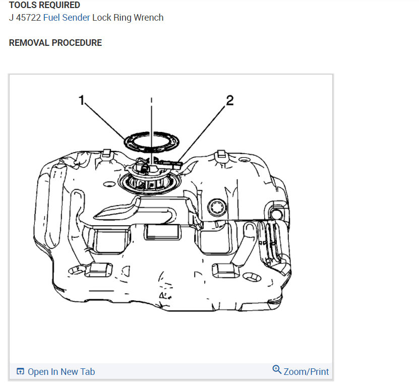

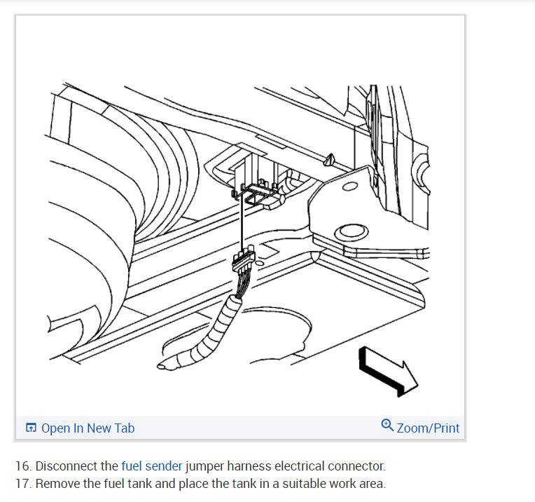

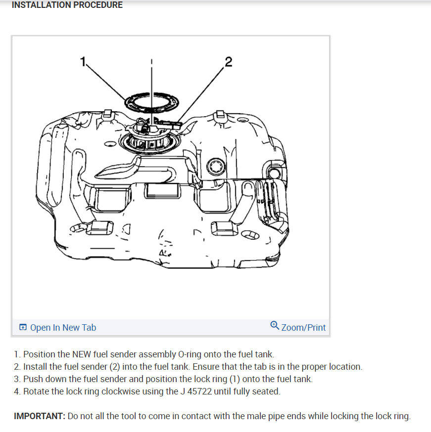

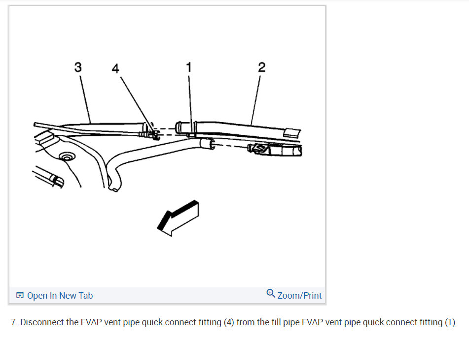

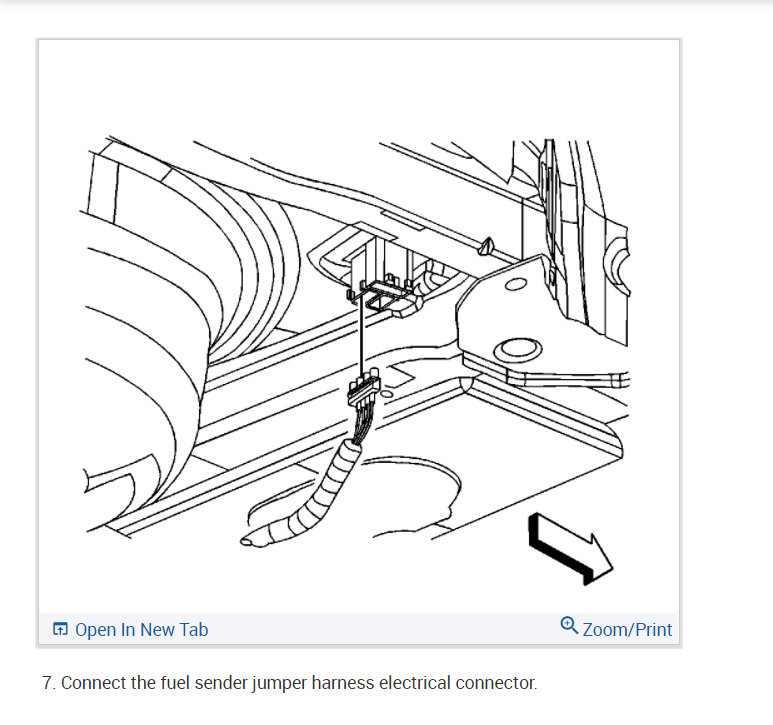

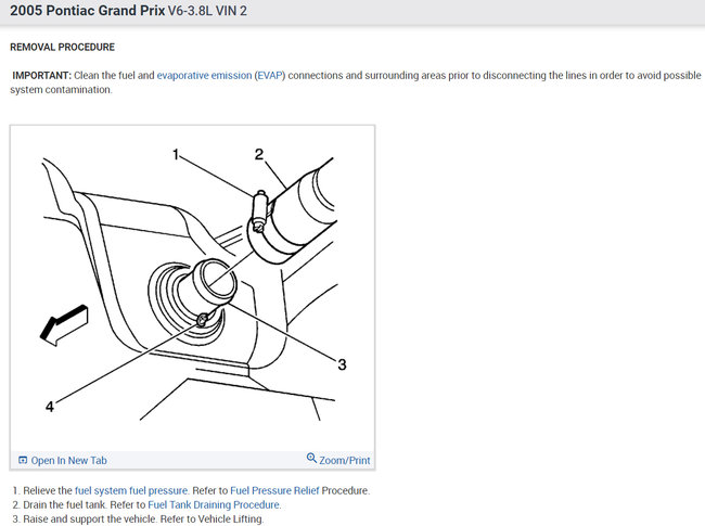

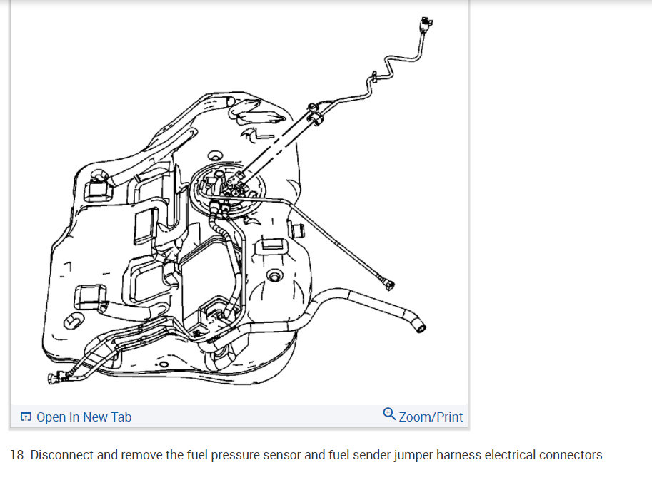

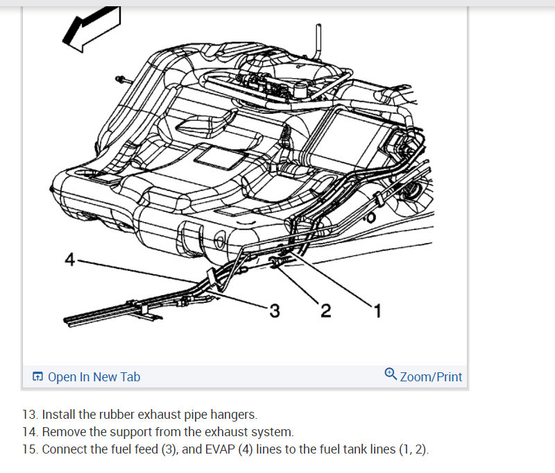

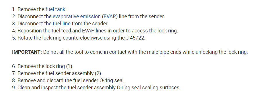

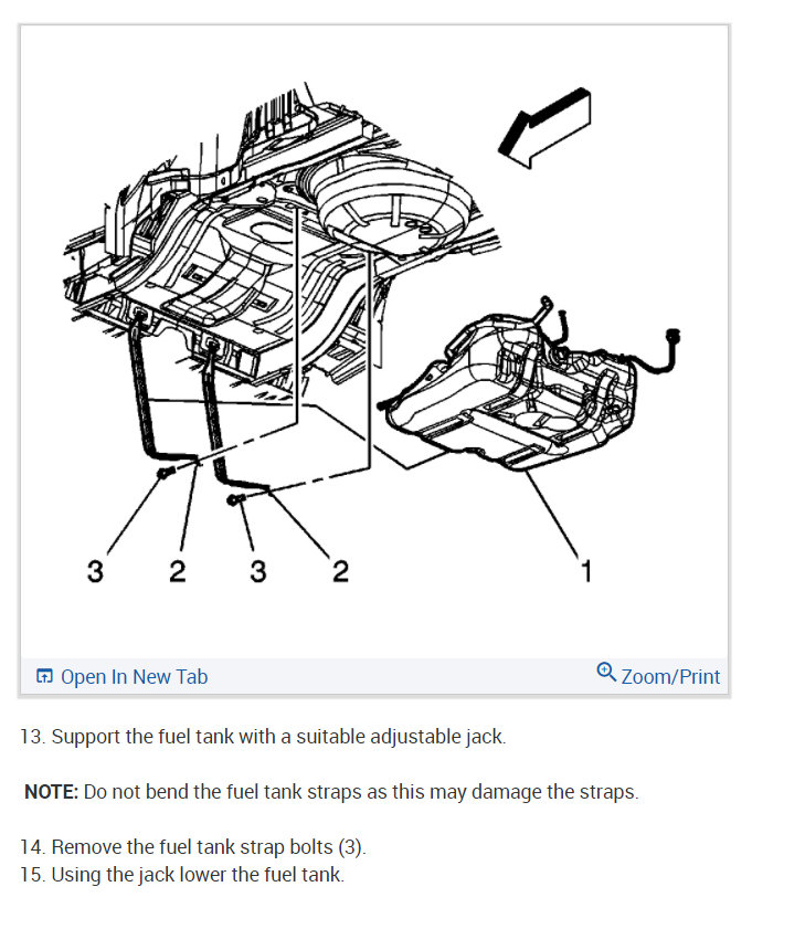

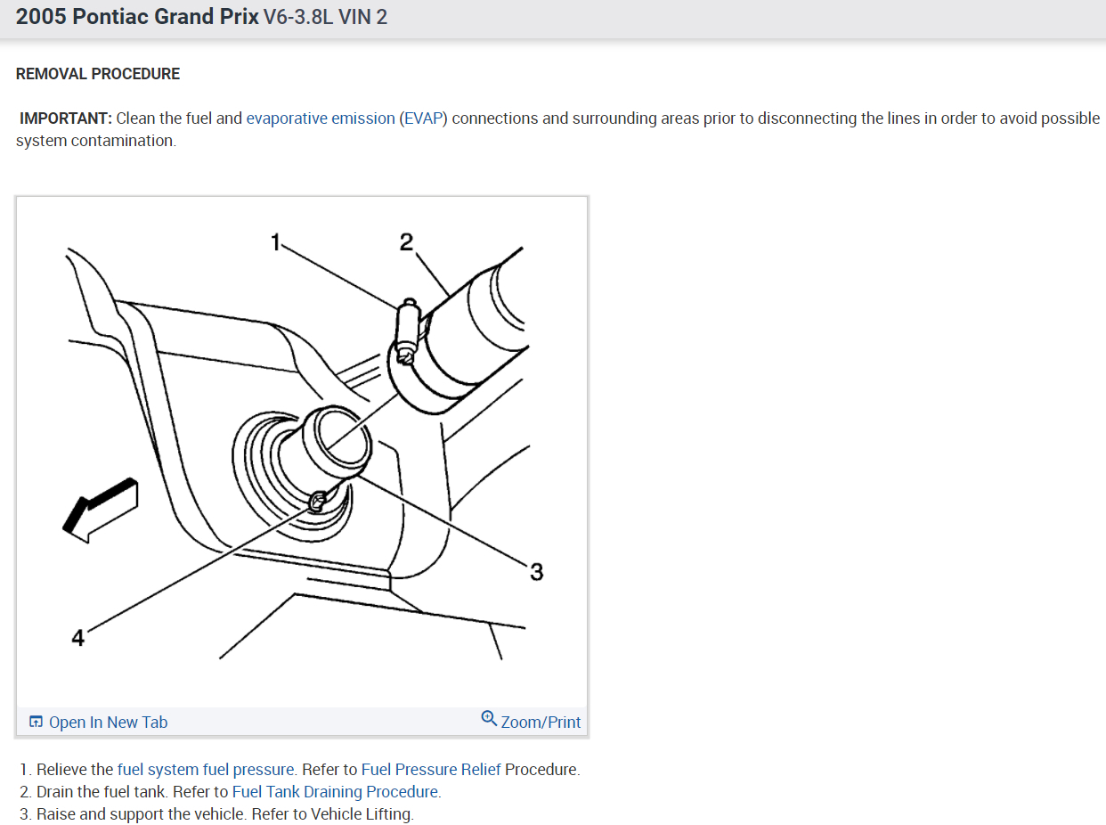

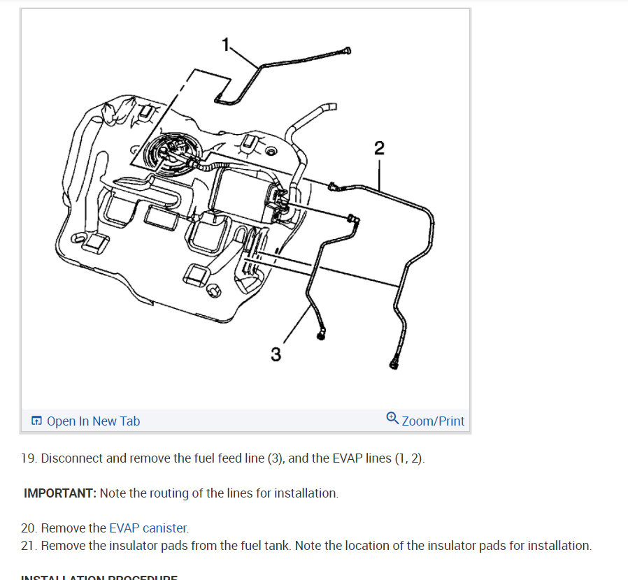

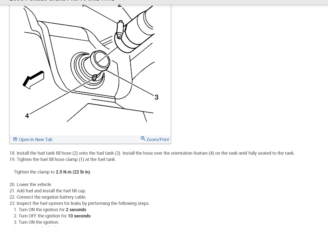

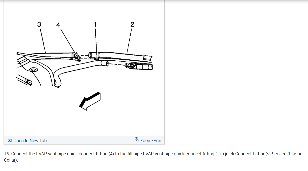

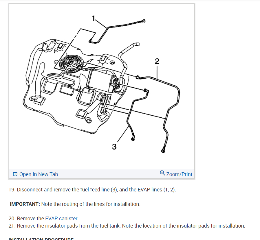

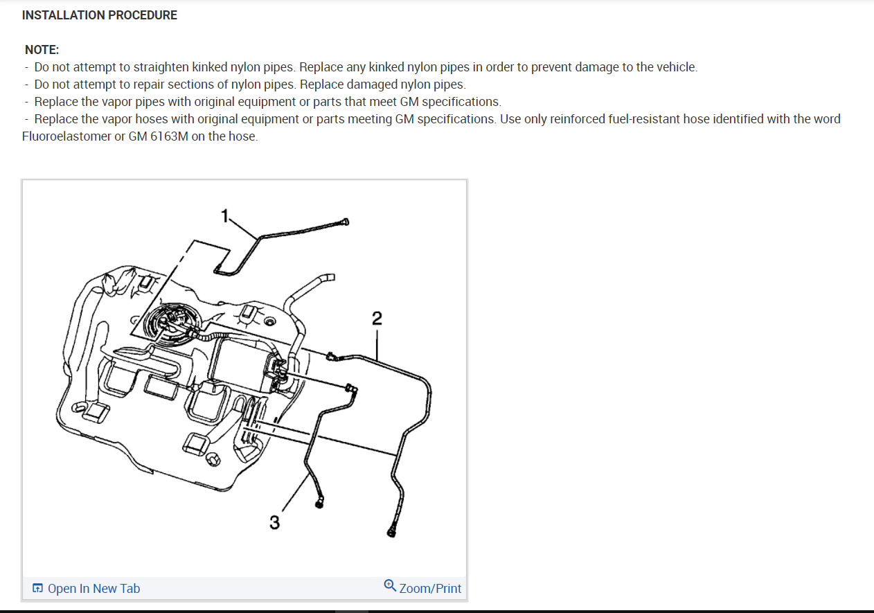

I have to have the fuel pump changed, and was wondering if can do the job myself to save money?
Oct 4, 2018 at 6:54 AM
  • 110,244 POSTS

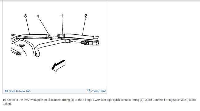

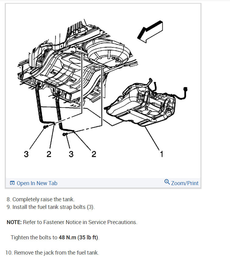

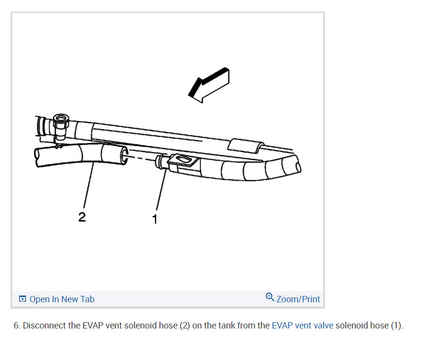

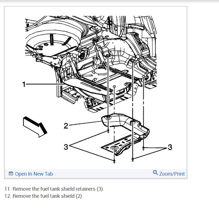

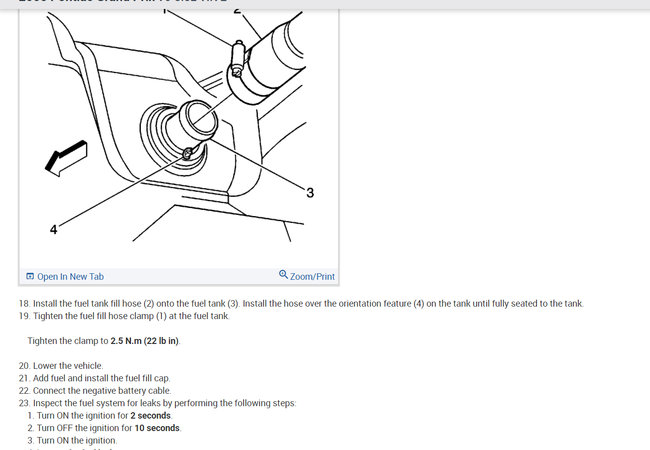

Here is a guide to help you step by step with instructions in the diagrams below to show you how on your car. Here is a link that shows in general how one is replaced. This video shows the job being done on a similar car but the process is the same.
https://youtu.be/Lhd0vd8pdBU
and
https://www.2carpros.com/articles/how-to-replace-an-electric-fuel-pump
