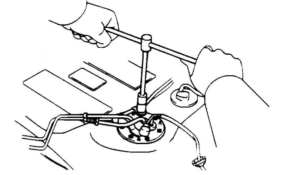

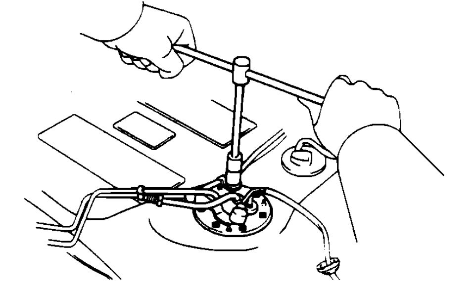

I need to replace my fuel pump I am going to try to make a service hole with a air chisel I need to no where to cot it

The best way to figure it out is to go under the car to the area of the pump. It is on top of the tank You will need to mark the area with something so you can get a view from the top when you break through the floor. I would remove the rear seat and clean out the trunk.
Measure the diameter of the pump and go about 2 more inches to allow better access.
You will need to cover the hole with some metal when you are done.
