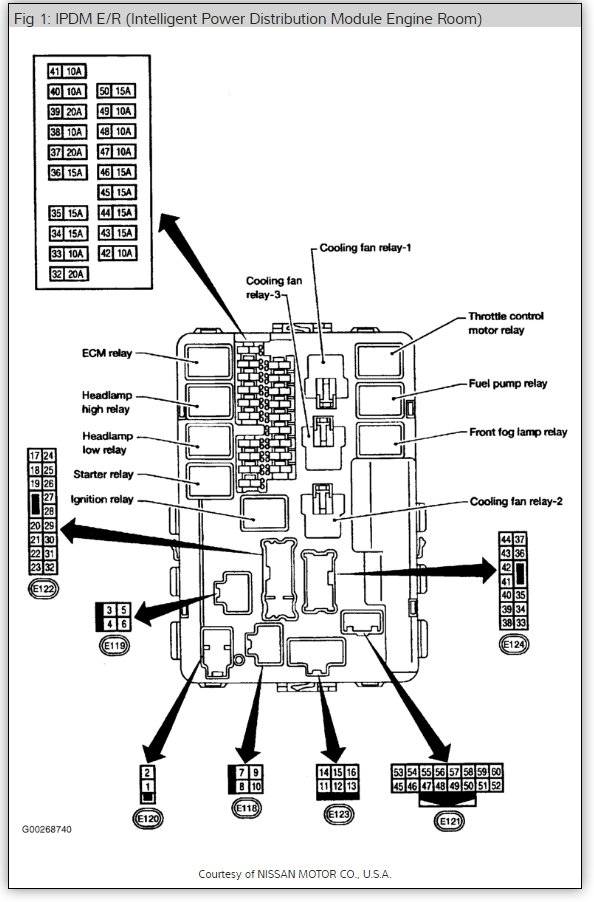

TRIPSLUV

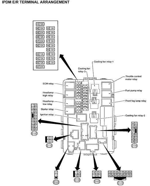

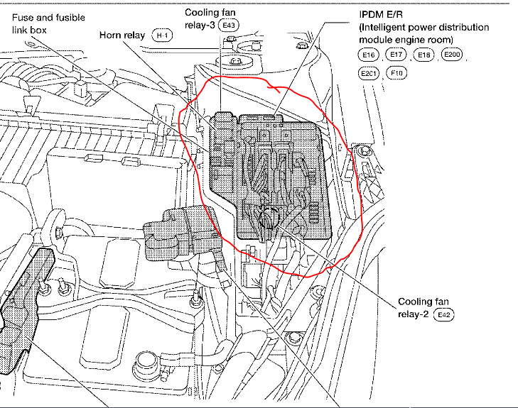

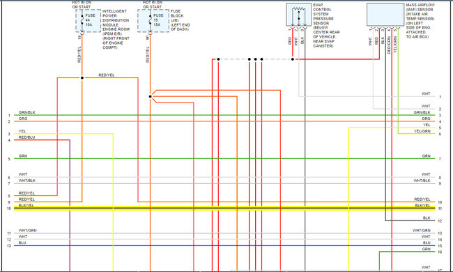

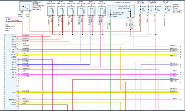

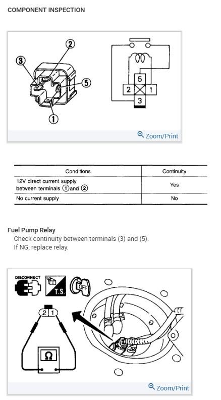

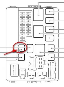

I cannot find my fuel pump relay location. Also, does my car have a fuel pump reset switch?
Jul 2, 2019 at 11:59 PM
  • 55,433 POSTS
There is no reset switch.here is a guide to help you test the relay which is inside the IPDM in the engine compartment:
Jul 4, 2019 at 7:31 AM

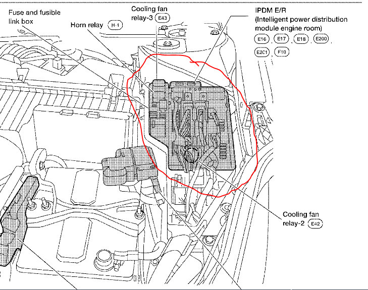

TRIPSLUV
I still can't find it. I don't understand those diagrams. Is it inside the car or under the hood?
Jul 5, 2019 at 5:57 AM
DANNY L
  • 5,648 POSTS
Hello, I'm Danny.

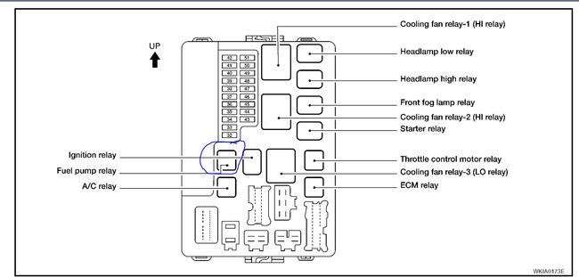

The fuel pump relay is located in the IPDM (intelligent power distribution module) which is located under the hood on the left side near the strut tower. I've attached a picture below. Hope this helps and thanks again for using 2CarPros.

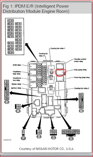

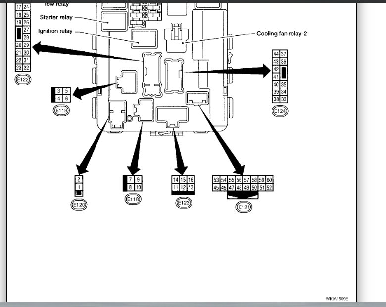

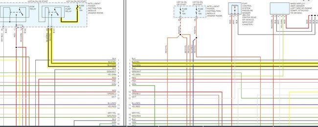

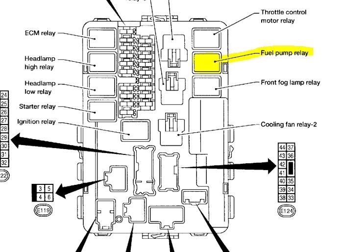

HAROLDNASHJR

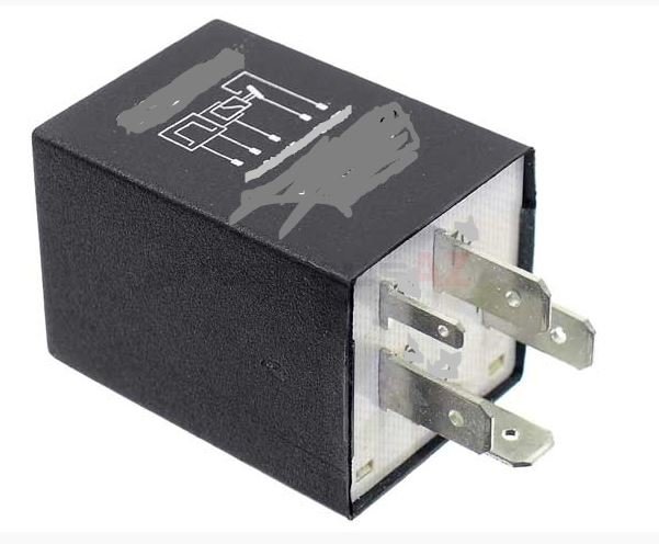

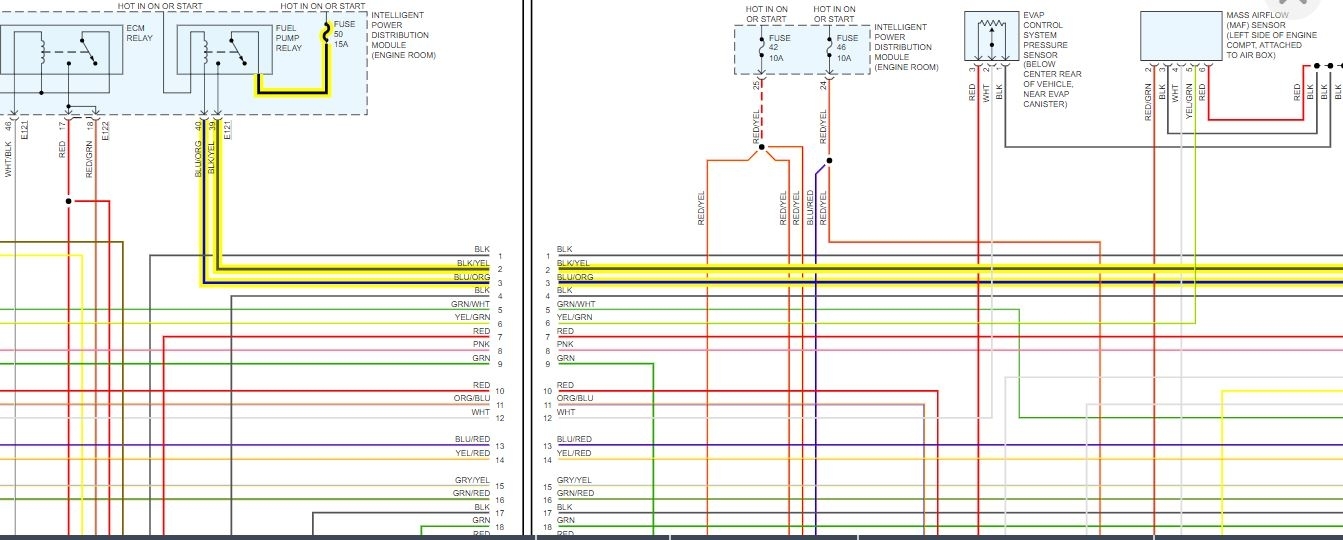

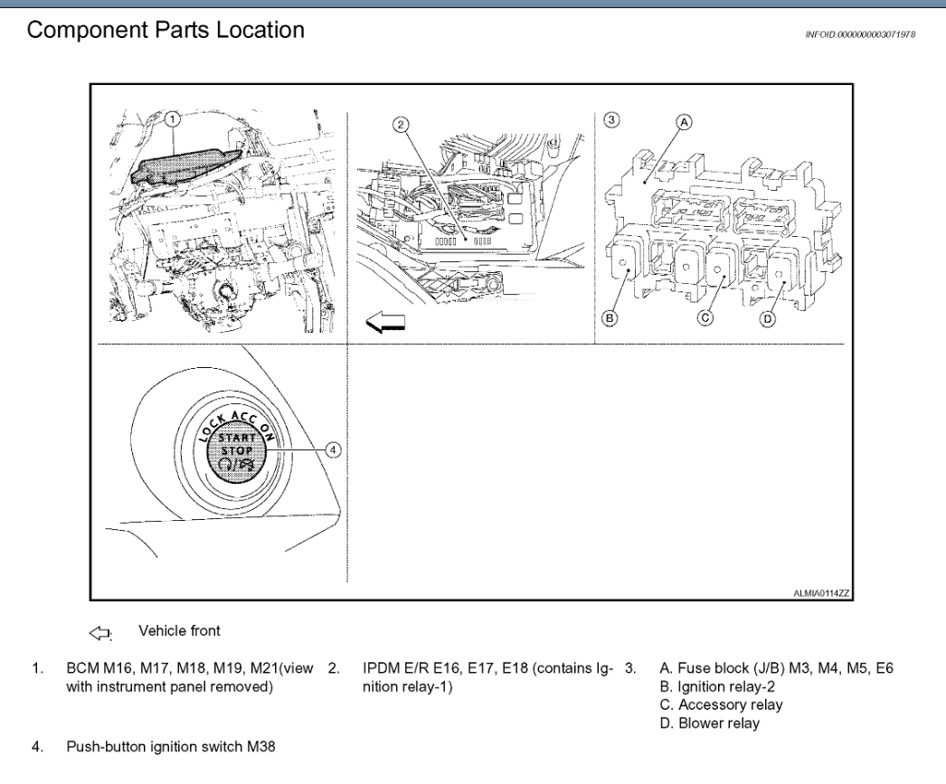

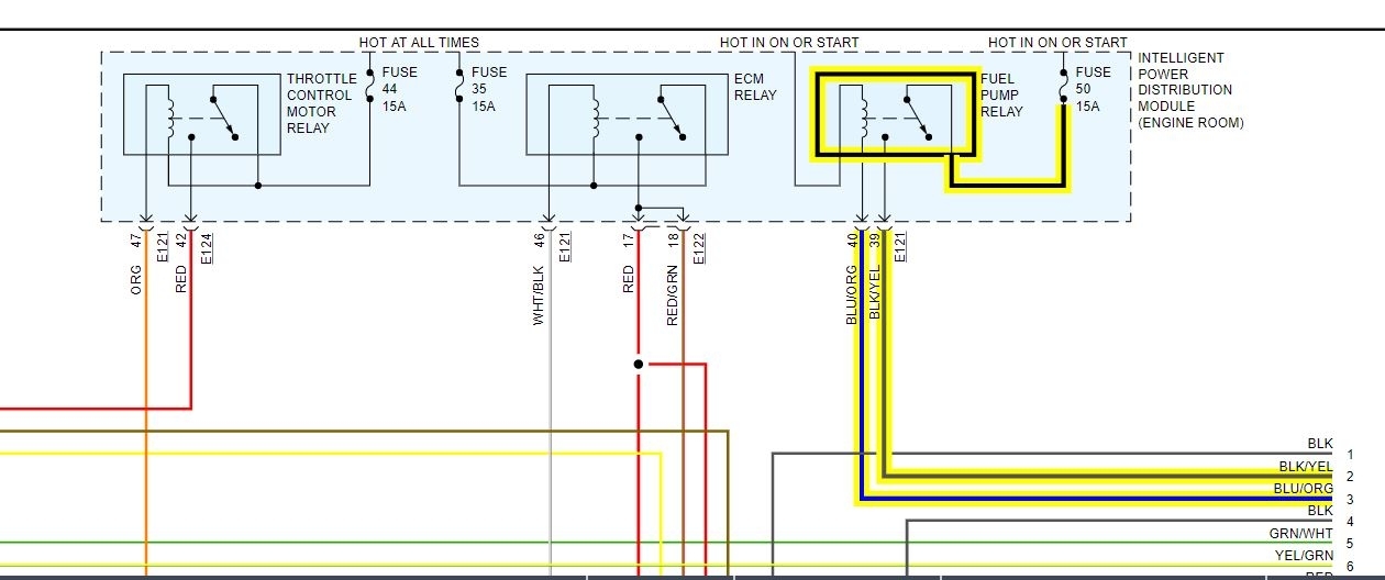

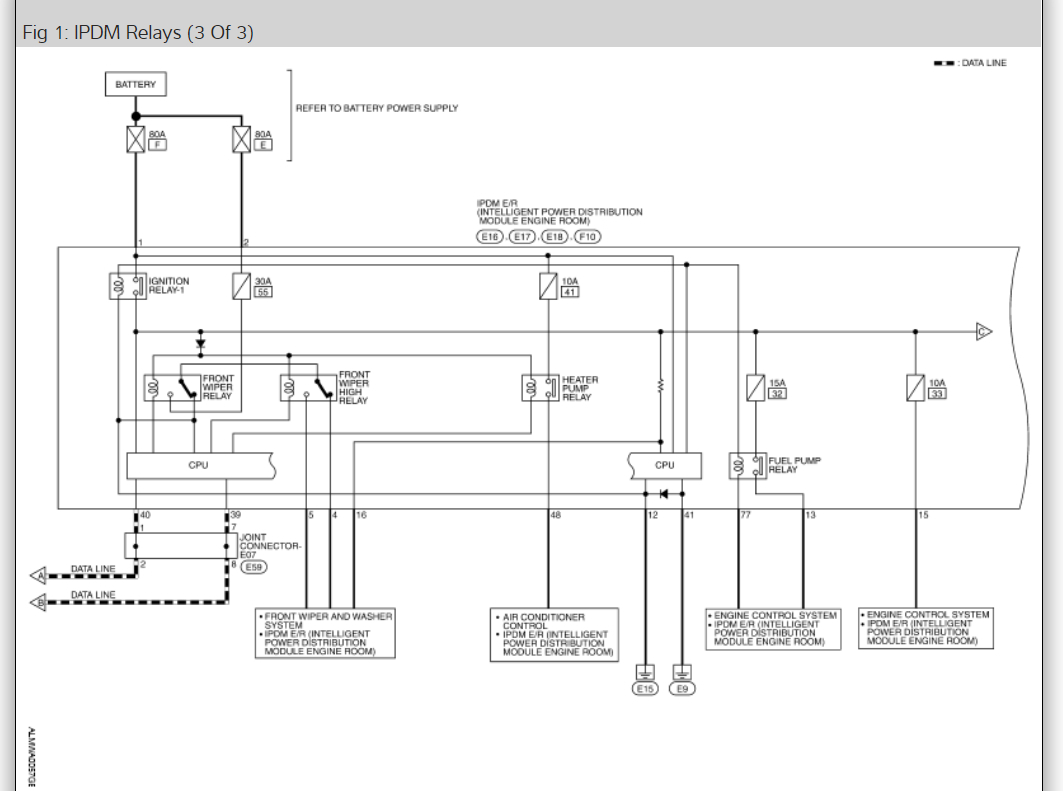

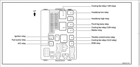

Where is the fuel pump relay location? What does the relay look like?
May 25, 2021 at 6:31 AM (Merged)
  • 110,244 POSTS
Welcome to 2CarPros.
The relay is located in the under hood power distribution box. I attached a picture which shows the relay location for you. Pic 2 is a general picture of a fuel pump relay.
Here is a link that explains how to check a relay:
Here are a few additional links you may find helpful:
Check out the diagrams (Below). Please let us know what you find.

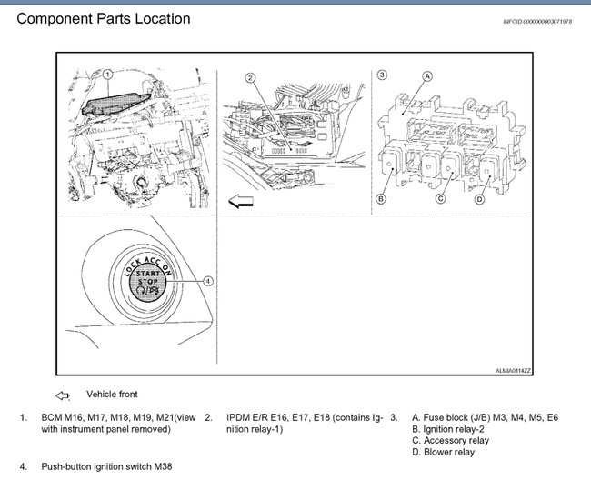

HAZEY83
I have looked all over the engine to find the relay location. I located two different fuse boxes under the hood and none of them are where the fuel pump relay is. Even looked under steering wheel found some fuses there but no relay. Please help I have no idea where it could be. And yes I looked through YouTube and Google images already and no help.

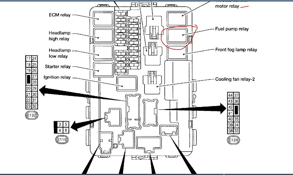

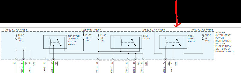

DANNY L
  • 5,648 POSTS
Hello, I am Danny.
The fuel pump relay is located in the Intelligent Power Distribution Module Engine Room (IPDMER). Attached is a picture. I circled it in red below.
Here is a guide to help you test the relay as well

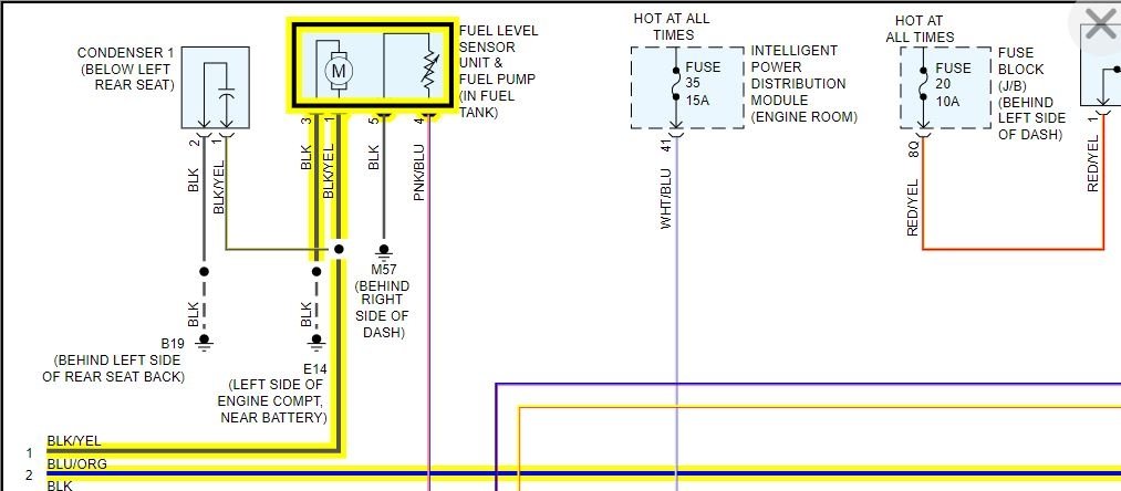

DAVEMANLEY
Replace the fuel pump in the car still won’t start after hearing feel pump humming. Car just previously running.

Good afternoon,
Can you hear the pump after replacing the relay?
There should be 2 powers to the relay with the key on. One is fused control and one is powered by the ECM relay.
Can you feel the relay energize when you turn on the key?

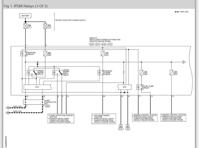

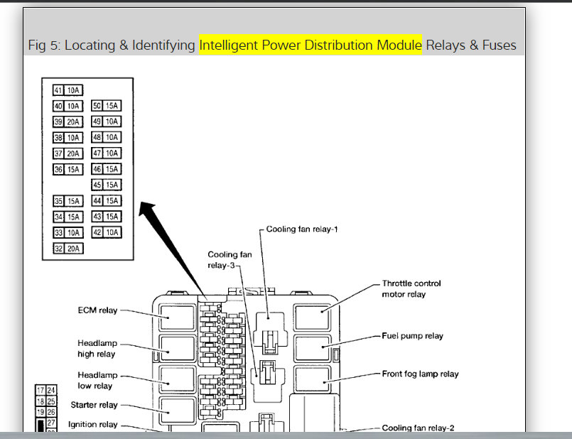

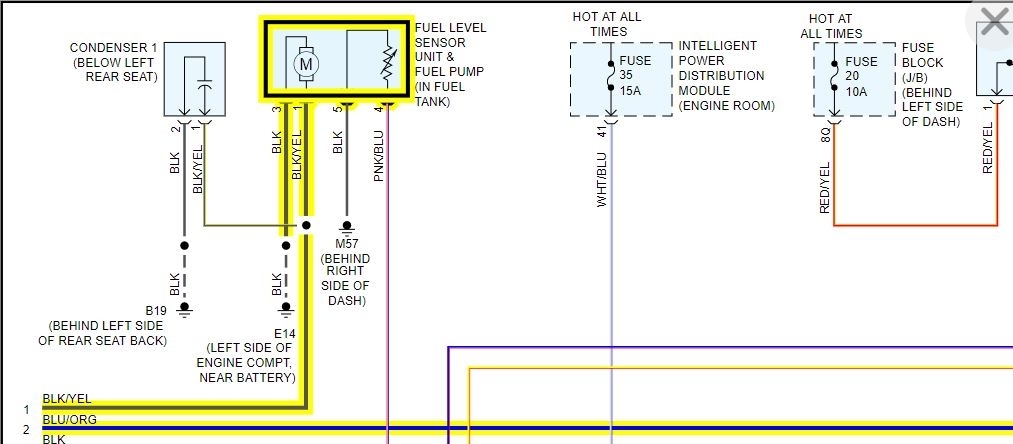

MKOROMA06

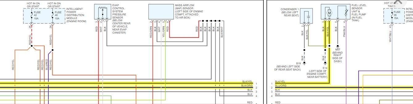

Changed the fuel pump recently, but now I have to change the fuel pump relay. I bought a Duralast relay and I do not know where the location of the fuel pump relay is to put it in. The car is the SE-R model.
  • 55,433 POSTS

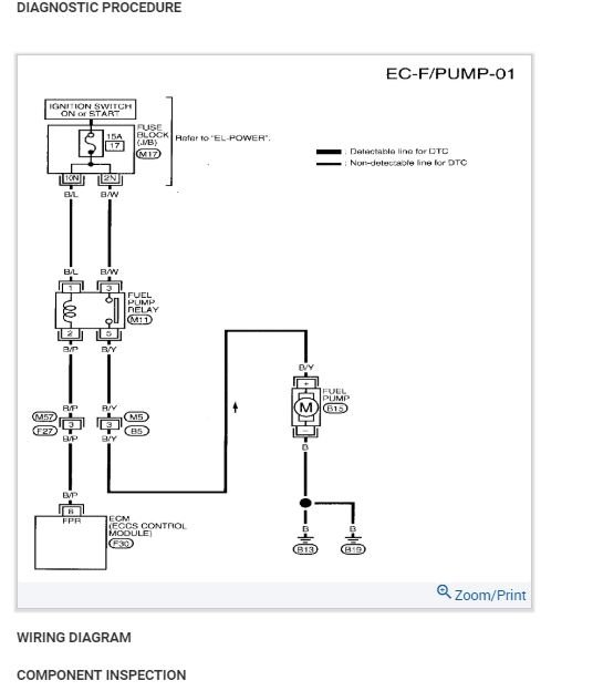

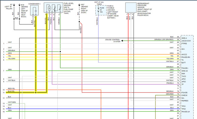

I found the relay location for you along with the guide to help you test it to see if it is the problem. Relay diagram (below).

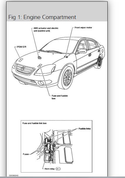

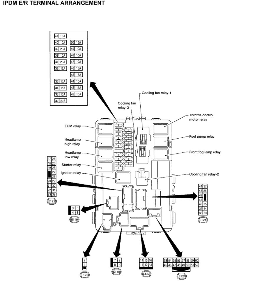

MARTIN0514
I got a 2003 Nissan altima with a 3.5 engine, it has 125k on it.The car will turn over but won't start, I notice that there's no fuel going to the fuel rail,(I disconnect the fuel line going to the fuel rail) The 10 amp fuse in the engine compartment next to the coolant recovery is not blown,i look for a fuel pump relay but i couldn't find one the question for you the experts where do I go next to find the problem. Thanks OKC man
  • 75,992 POSTS

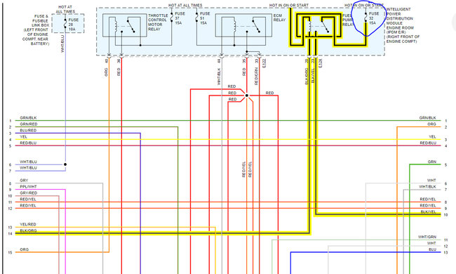

Hi Martin0514, Welcome to 2carpros The FP Relay is in the intelligent power distribution module in the right front engine compartment. Check fuse no.32 15amp in the IPDM Do this find the fuel pump connector and power the black and yellow wire from the battery this will cause the fuel pump to come on.
https://images.2carpros.com/forum/automotive_pictures/12900_IPDM_1.jpg

TCAFFEE

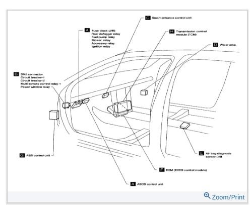

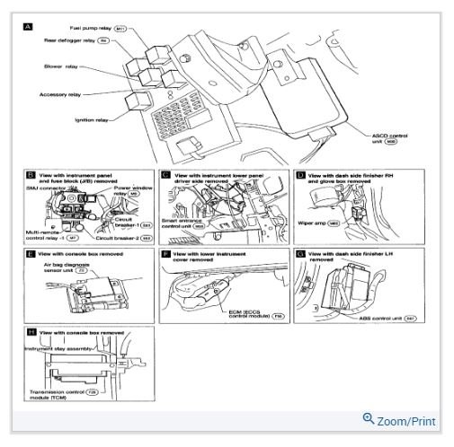

where is the location of the fuel pump relay in a 2003 nissan altima. 4 cylinder?
WRENCHTECH
  • 20,761 POSTS
https://images.2carpros.com/forum/automotive_pictures/561653_Fuel_pump_relay_03_altima_1.jpg
KENYA PATRICK

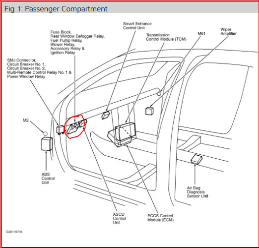

Where is the fuel pump relay switch located on the car listed above GXE model?
DANNY L
  • 5,648 POSTS
Hi there, I am Danny.
Your fuel pump relay is located on the passenger compartment fuse block. I attached a picture and circled it in red. Here is a guide to help check the relay.

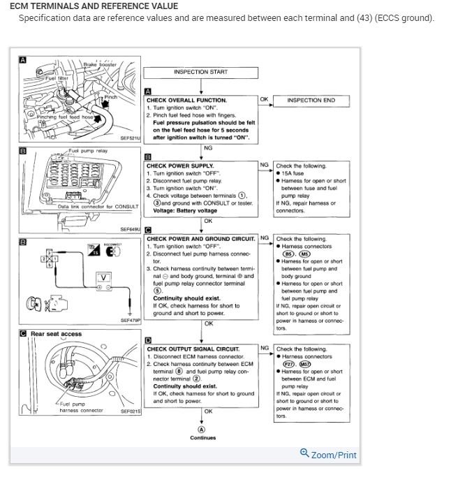

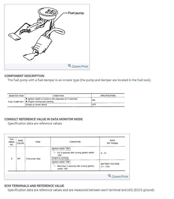

Here are the diagnostic procedures for the fuel pump system.
FUEL PUMP SYSTEM TEST
1. Turn ignition on. With fingers, pinch fuel feed hose at fuel filter. Fuel pressure pulsation should be felt for 5 seconds after ignition is turned on. If pulsation is not felt, go to next step. If pulsation is felt, system is functioning properly.
2. Turn ignition off. Disconnect fuel pump relay. Fuel pump relay is located in relay box next to battery. Turn ignition on. Measure voltage between ground and fuel pump relay harness connector terminals No. 1 (Blue/Black wire) and No. 3 (Blue/Black wire). Battery voltage should be present. If battery voltage is present, go to next step. If battery voltage is not present, check 15-amp fuse in main fuse box. Check harness continuity between fuse and fuel pump relay. Repair or replace as necessary.
3. Turn ignition off. Disconnect fuel pump harness connector, located under rear seat. Check continuity between ground and fuel pump harness connector Black wire. Check continuity between fuel pump relay harness connector terminal No. 5 (Black/Red wire) and fuel pump harness connector Black/Red wire. Continuity should exist in both checks. If continuity exists in both checks, go to next step. If continuity does not exist, repair appropriate harness or connectors.
4. Ensure ignition is off. Disconnect ECM harness connector. ECM is located under center of instrument panel (connector is on passenger's side). Check continuity between ECM harness connector terminal No. 8 (Black/Yellow wire) and fuel pump relay harness connector terminal No. 2 (Black/Yellow wire). Continuity should exist. If continuity does not exist, check harness between ECM and relay. Repair harness and connectors as necessary. If continuity exists, check fuel pump relay. If relay is okay, check fuel pump.
© 2008 Mitchell Repair Information Co., LLC.

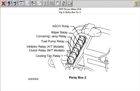

Could you please tell me where the fuel relay switch is located on a 1995 nissan Altima. I have been trying to find it to reset it for days. After I changed the fuel line on my car the car is not running right it will start and idle until the gas runs out but will not take gas when the gas peddle is used. it was running fine until I change the cracked hose. People are telling me I need to reset the fuel relay switch but I have no idea where it is.
May 25, 2021 at 6:32 AM (Merged)
  • 75,992 POSTS
You're talking about the fuel pump relay-its right inside relay box #2 beside the battery. See below
https://images.2carpros.com/forum/automotive_pictures/12900_fuel_pump_relay_4.jpg

I attached the location of the fuel pump relay as well as the diagram for the operation for you.
