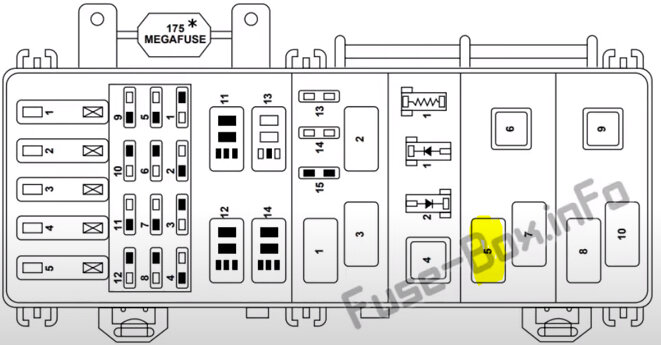

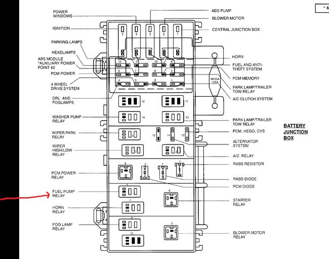

They don't make a 2000 Ford Courier in the US. Here is the location in a ranger maybe they are the same, fuel pump relay is in the main fuse panel under the hood, please check the images below to see the location.
Feb 21, 2023 at 12:06 AM
BORIS K
  • 836 POSTS
The fuel pump relay is located in the engine fuse block.
See image below, relay 5.
Fuse and relay information:
https://youtu.be/k_UkjChvvk4
Hope this helps.
Cheers, Boris

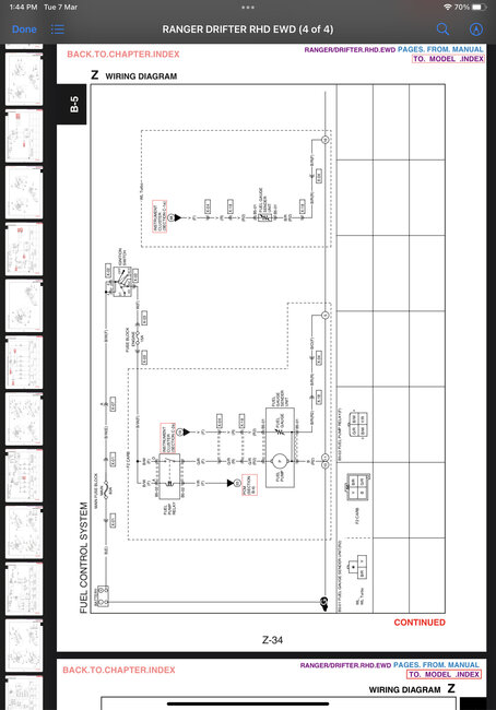

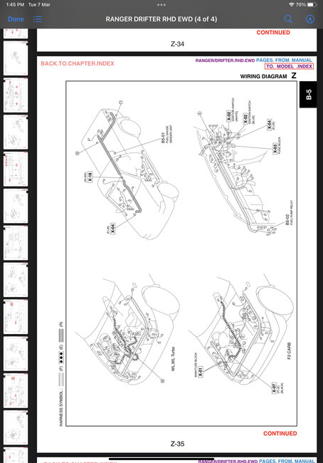

ELLEYC27
Here’s the diagrams from the manual, doesn’t have anything about the fuel pump relay for the WL Turbo only F2 Carb with different wiring?
Mar 6, 2023 at 8:51 AM
  • 55,402 POSTS
The images are too small to read. Can you resize them and re-upload please?
