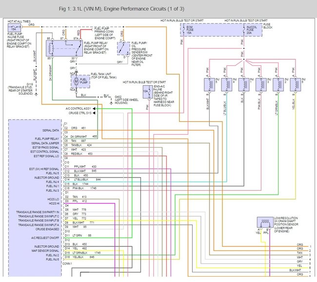

Hello and thanks in advance. Much misinformation on the internet. Hard starting. Every time I disconnect/reconnect oil pressure sender harness I can here fuel pump engage while ignition starting. Car dies while driving. Turn ignition and can not hear fuel pump go on. Disconnect/reconnect oil pressure sender harness. hear pump engage when ignition on and starts. Car dies while driving especially steep hills reverse or forward. Finally disconnected oil sensor harness from sensor and now no problems except harness is disconnected from oil pressure sensor. Can you figure this one out please?

yes they are the low oil level is exactly what it means the sensor is in oil pan a lot of times the fuel pump relay is to run the pump on startup and then if required during running of engine. the oil pressure switch sends a signal to the pump/relay as well as the dash if pressure gets low pump quits. but since you disconnected it it can't do that as well as give any oil pressure readings. if the low oil level light is on and you haven't checked the oil then it may be so or it's a bad sensor/shorted wire. see pic

But with my oil pump pressure sensor disconnected, shouldn't my oil pressure be sent as 0 and shut off fuel pump?

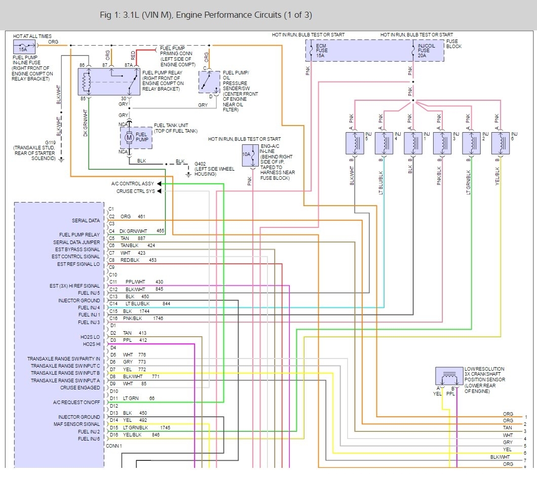

Hi Jon,
If I may jump in here, yes the oil pressure sender does interrupt the fuel pump to stall the engine. Here is a wiring diagram so you can see exactly how the system works.
Please let me know if you need anything else to get the problem fixed.
Best, Ken

FIXED! Thanks to the wiring diagram. My intention was to hotwire my fuel pump to see if it worked. I followed fuel pump wire from fuel pump relay over to the left(drivers) side and along the route on the left side of the engine I found a loose ground that connected about 4 or 5 wires to the engine block. No wonder why I had intermittent problems through the last year or so. So HMAC300, you were on to some thing from the start and Ken helped me clinch it with the wiring diagram. No parts replaced and works fine now for days. ONE QUESTION THOUGH, the wiring diagram only shows two wires coming from the oil pressure/sensor switch and there are actually three...... can you please clarify? Thanks so much for the help, aloha, jon

And why is there a solid line around the fuel pump relay and dotted lines around the oil pressure sensor/switch in the wiring diagram? Where is that diagram from? Thanks again, jon

the other line is more than likely a ground for the light/gauge in dash. the dotted lines mean that where they come from that something else uses the same ground at the dot and dotted line shows where the ground wire connects to
