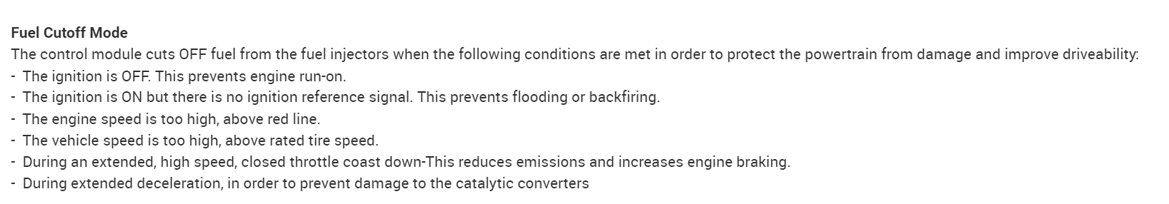

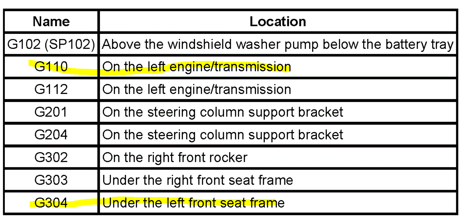

I read through several things, and this doesn't appear to be related to the oil pressure. If you look below, I attached a pic showing the fuel system cut-off causes. Take a look.

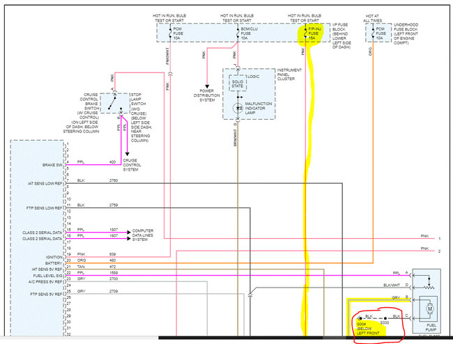

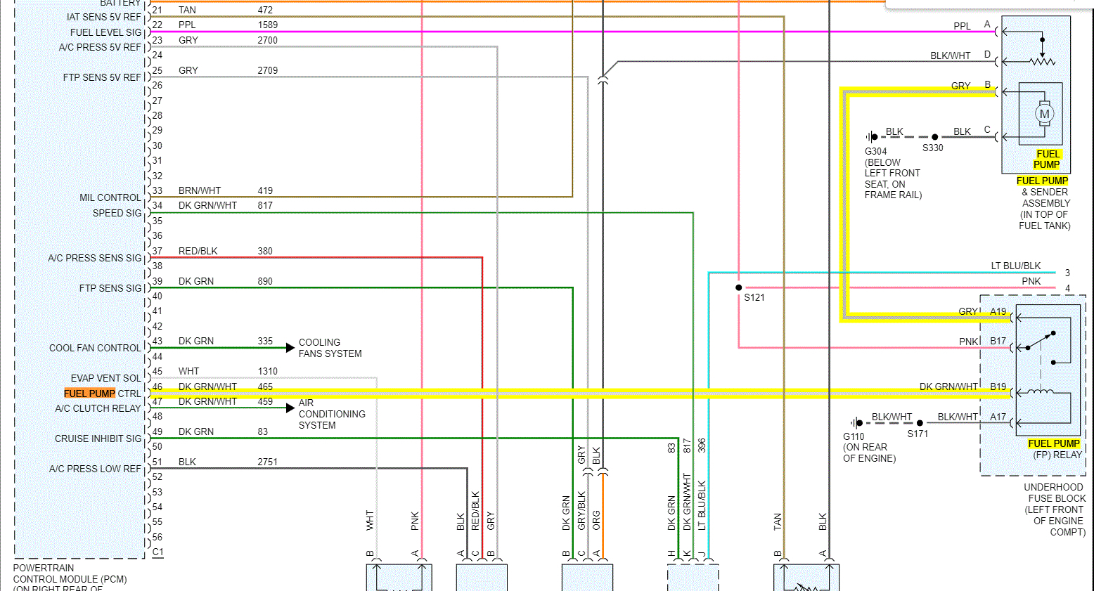

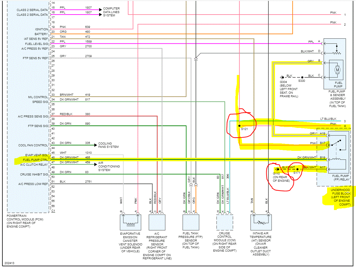

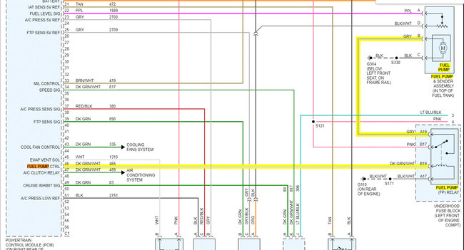

Actually, the PCM sends a voltage signal to the fuel pump relay to actuate it. Once that signal is applied, the relay closes and power to the pump and fuel injectors is supplied by fuse (F/P Inj) in the interior fuse panel.

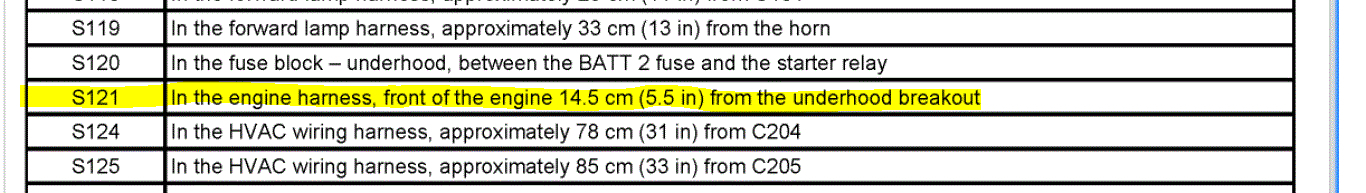

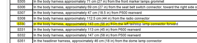

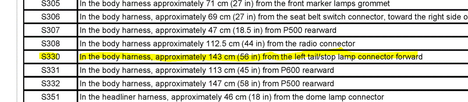

There is one thing I see that may be the problem. There is a splice between the fuse and the relay. The splice provides power from the fuse mentioned to both the relay and the injectors. That splice may be failing and not able to keep up with demand. However, I suspect we have a weak ground at some point.

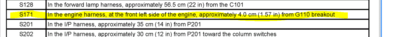

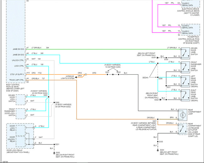

If you are sure the relay is good, we need to locate the splice. Pics 2 and 3 show the wiring schematic. I highlighted some wires and circled others. I circled the splice and grounds that should be checked as well. Pics 4 - 7 below show the locations of both the splices and the grounds.

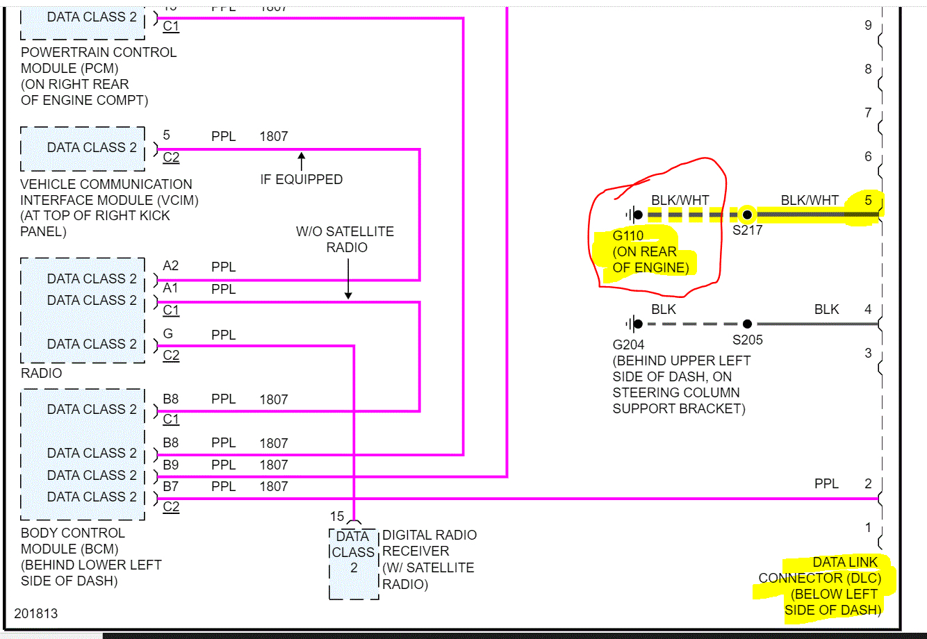

Here is where I strongly recommend starting, ground 110 at the rear of the engine. Not only is that the ground for the fuel pump relay but also, it is the ground for the data link connector that also isn't working. Take a look at pic 8 below. Start there. I have a feeling you are going to find either a partially broken ground, corrosion, or something is damaged at that point.
Take care and let me know what you find. I'm interested in knowing if that is where the problem is coming from.

You are very welcome. Although I can't guarantee it, the ground I mentioned seems to make the most sense simply because of the DLC issue.
I would suggest testing for continuity to ground from pin 5 on the DLC; however, that could provide a false positive. I suspect the ground is failing when loaded and a multimeter won't provide the voltage needed to cause failure. However, it wouldn't hurt to try.

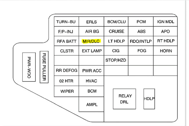

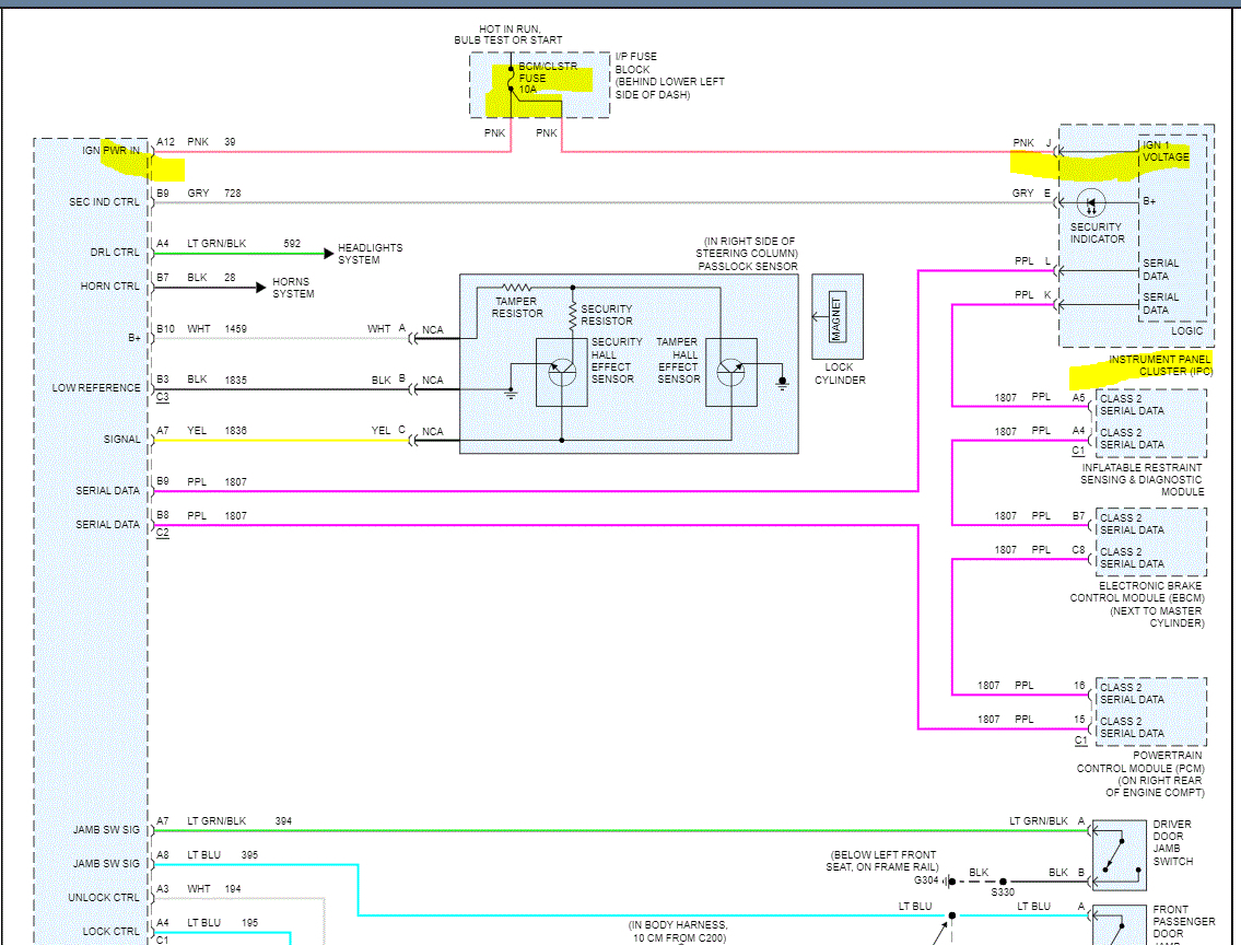

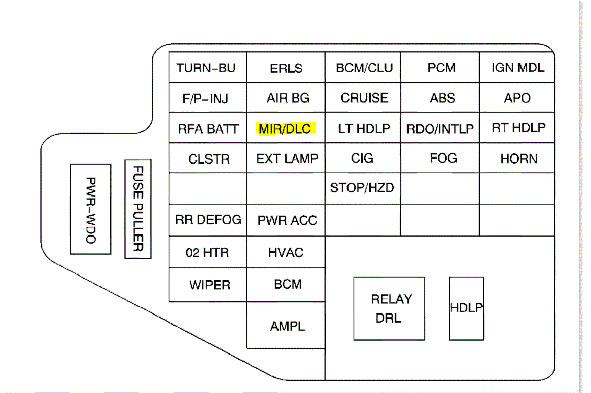

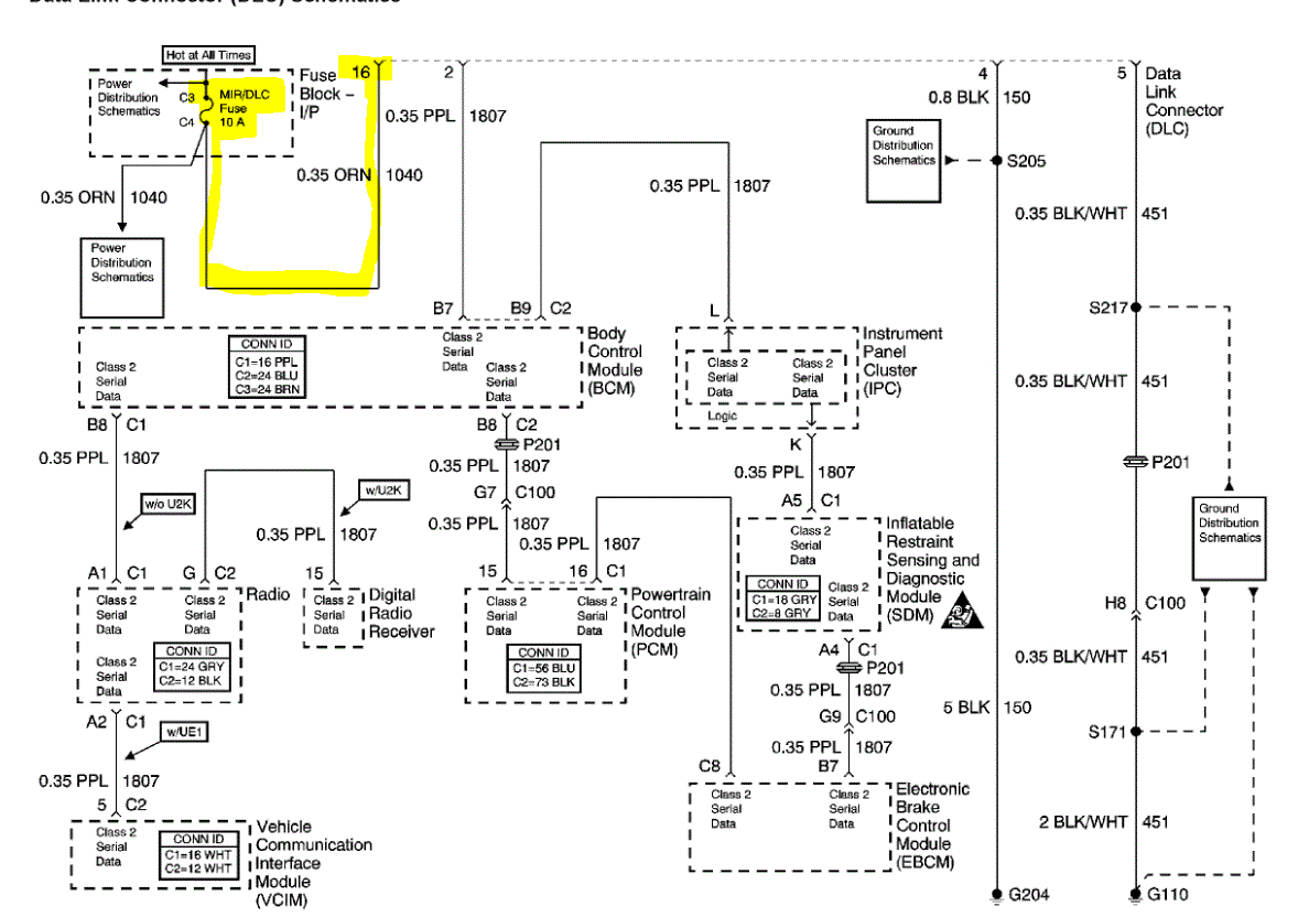

I attached the DLC wiring schematic and the fuse that powers it. Check the fuse to see if it is good. Additionally, if the fuse is good, make sure there is power to and from it.
Pic 2 is the fuse panel (IP). I highlighted the fuse.
See pic.
Mar 26, 2022 at 5:54 AM

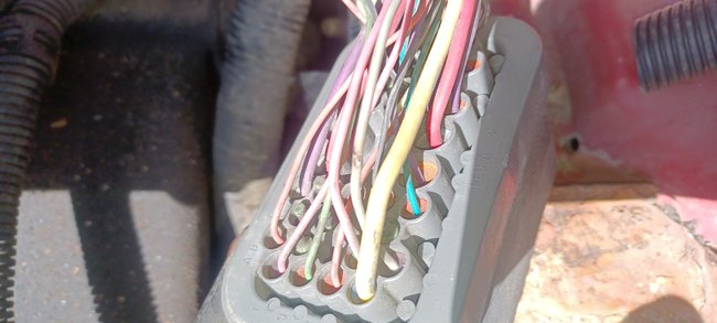

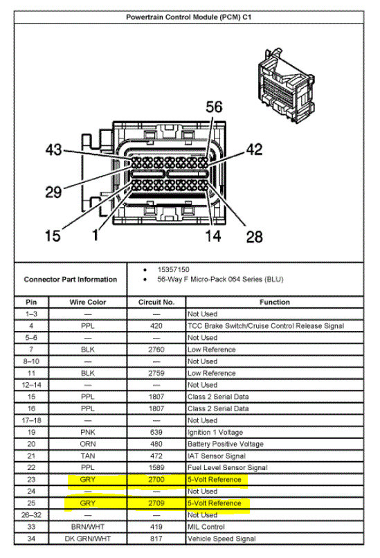

I have checked all fuses for 12v and all tested good. I will go back and verify that circuit. Thanks. The picture I attached is the gray wire powering the pump. If you zoom in, you'll notice a Hotspot on it. The corresponding pins in connector look good though. The outbound wire doesn't show any heat signs. I have opened the wire looms from the fuse panel to this connector looking for a slice. I haven't found one but I will. I'm going back to figure out the color of that wire. That will help. I can't tell you how much help you've been in this process. You'll be on my Xmas gift list this year. Lol. BTW, I've lost the theft light on the instrument panel totally. Even during the self-test upon power up. Darn gremlins. how would you like a cavalier for Xmas? I'm about ready to buy my niece (it's her car) something else and strike a match...
Mar 26, 2022 at 6:31 AM
DAVEINMO
  • 19 POSTS
The colors aren't great but it's the smaller wire that intersects the larger gauge yellow wire in the lower left of the pic.

I am going to check resistance on that burnt wire probing on each side of the connector to ensure there isn't more damage than just that little burnt spot.

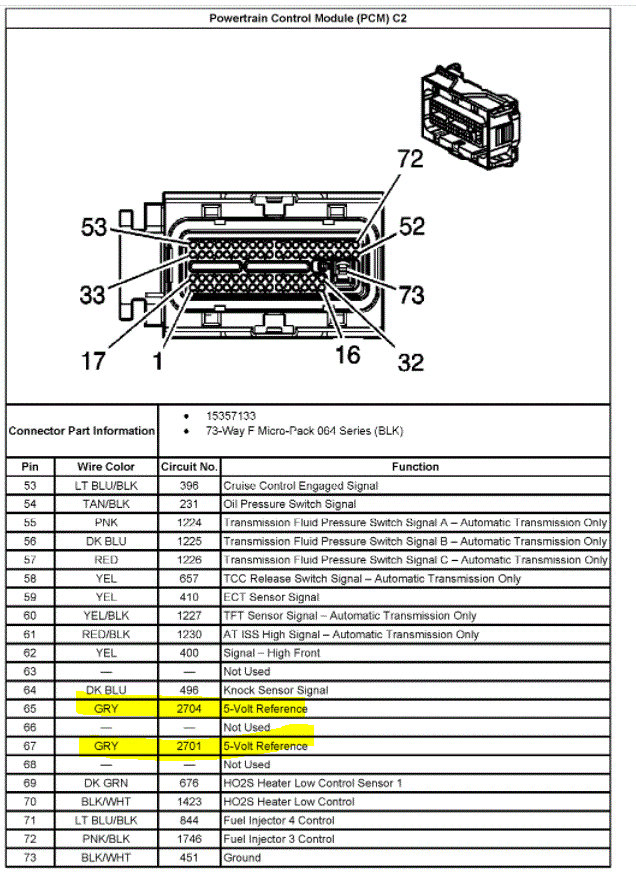

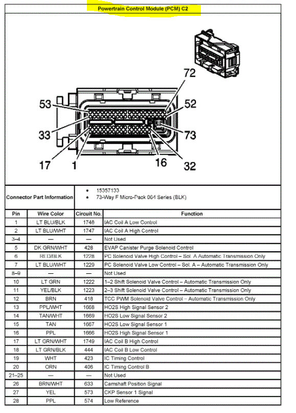

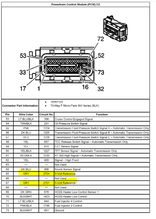

I attached a few pics below of the PCM connectors pinout. The first pic is connector 1. It is blue in color and has only 2 gray wires. Both are a 5v reference.
The remaining pics are of connector 2. It is black in color. Take a look.
The last pic shows a dark green wire with a white tracer between the PCM connector 1 and the fuel pump relay.

Like I said I have a lot of info. The gray wire provides 12 volts DC to the fuel pump that has a burnt spot about 2 in away from the connector body. If you blow up that picture, I sent the gray wire is in the left-hand side of the picture right next to the yellow wire that is a bigger gauge. Look approximately an inch to 2 inches before the connector body and you're going to see a burnt spot in that wire. I was going to splice a test wire before that burned spot around the connector body and back into the gray wire.

Now, it really does seem as though the Immobilizer is the issue. Take a look at the pics below. That is the wiring schematic for the anti-theft. Confirm the fuse is good and has power. Then check at both the BCM and the cluster for power.
