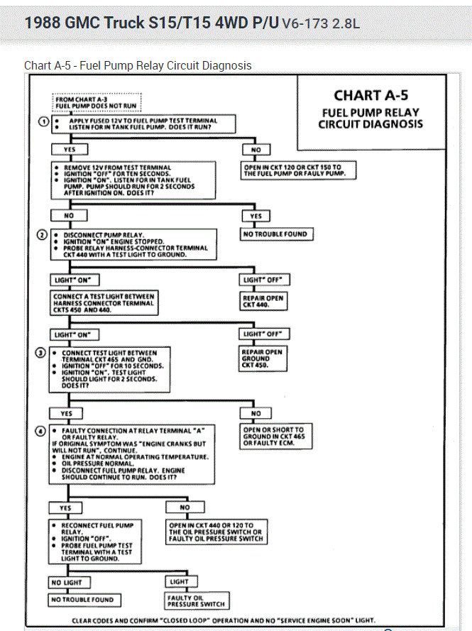

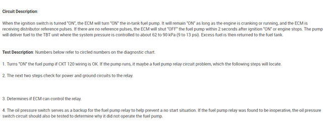

The pump is designed to prime when the key is first turned on (for a second or two), and then it turns off until the engine starts. Once it starts, it should get 12v. Are you only seeing 6v?
If that is the case, you need to go to the fuel pump relay and check pins A, b, and d. See if there is 12v there. There could be an issue with the ECM.
If you look below, I provided the diagnostics for the pump relay circuit. Follow the directions and let me know what you find.

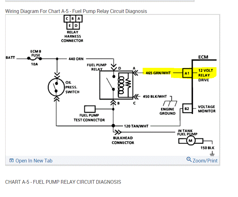

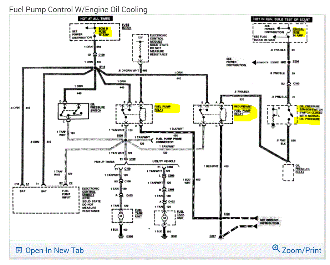

Are you sure the fuel pump is providing the pressure needed? I looked for a wiring schematic and did find an old OEM schematic for the fuel control. I noticed it is tied to the oil pressure switch. Also, there are two relays for the fuel pump. The issue for me is the schematic isn't specific to where the items are located and I'm not there to look.
Take a look through the schematic below. See if it helps. Confirm the relays are good and the fuses indicated are also good and have power to them.
If you do have power and the relays are good, I suspect the ECM is the likely issue. The injectors are controlled by the ECM.

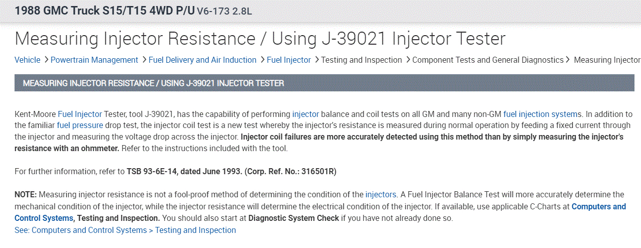

Take a look through the schematic and let me know if you have already checked these items. Also, pic 2 explains how to test the injectors.

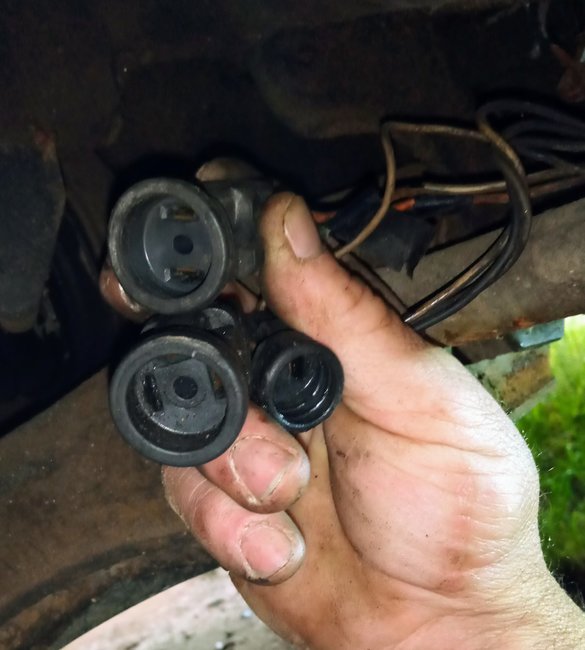

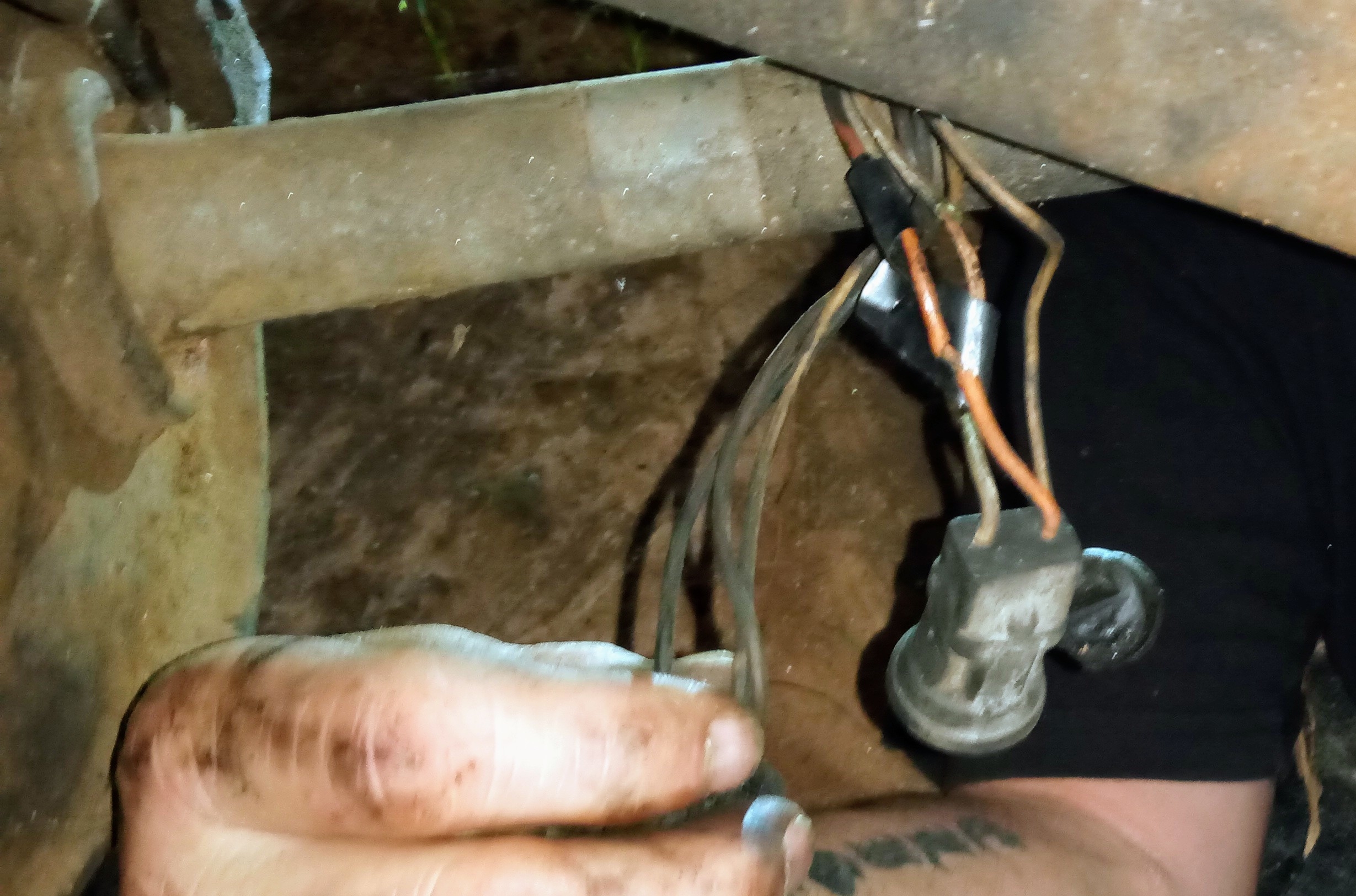

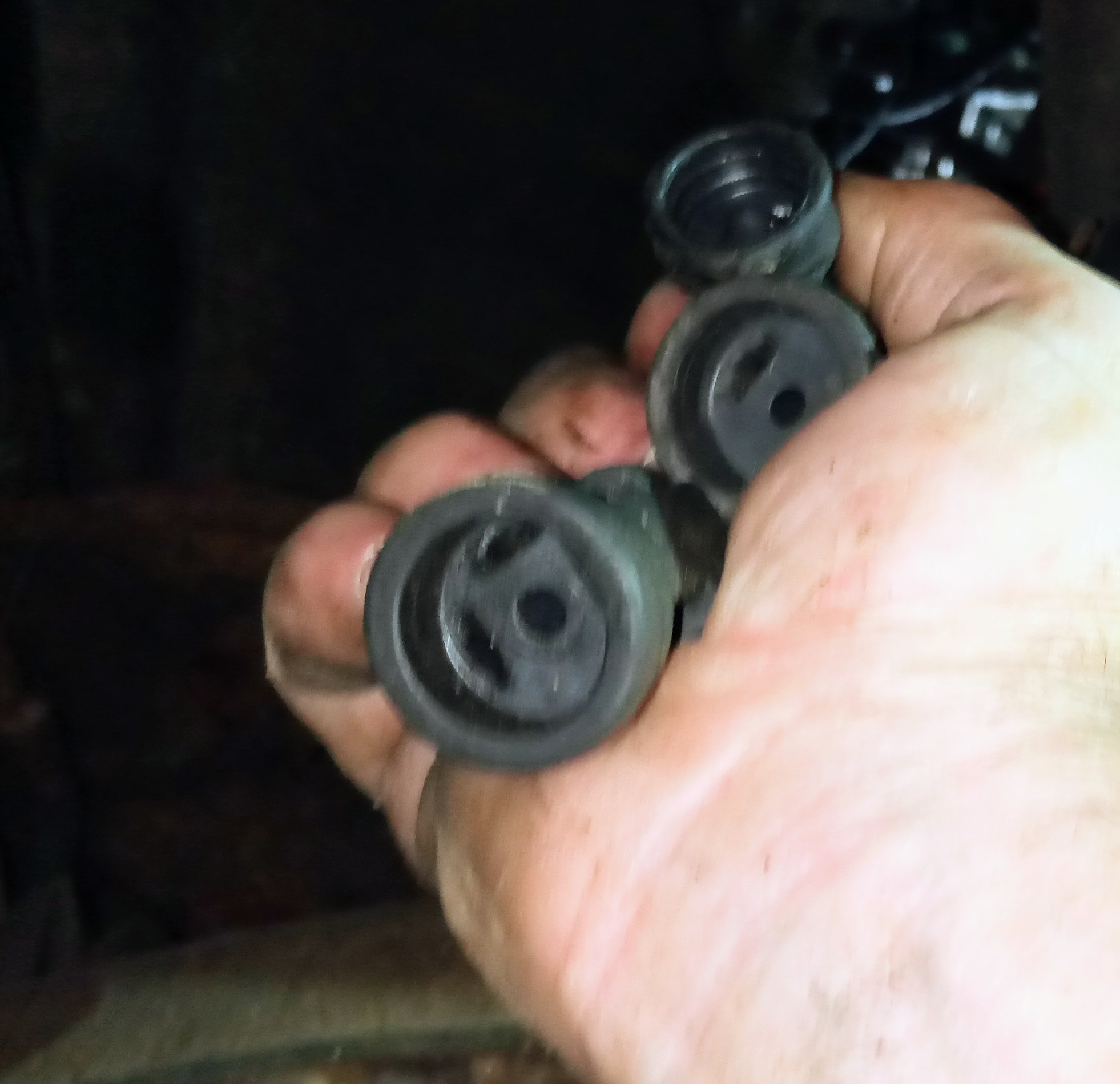

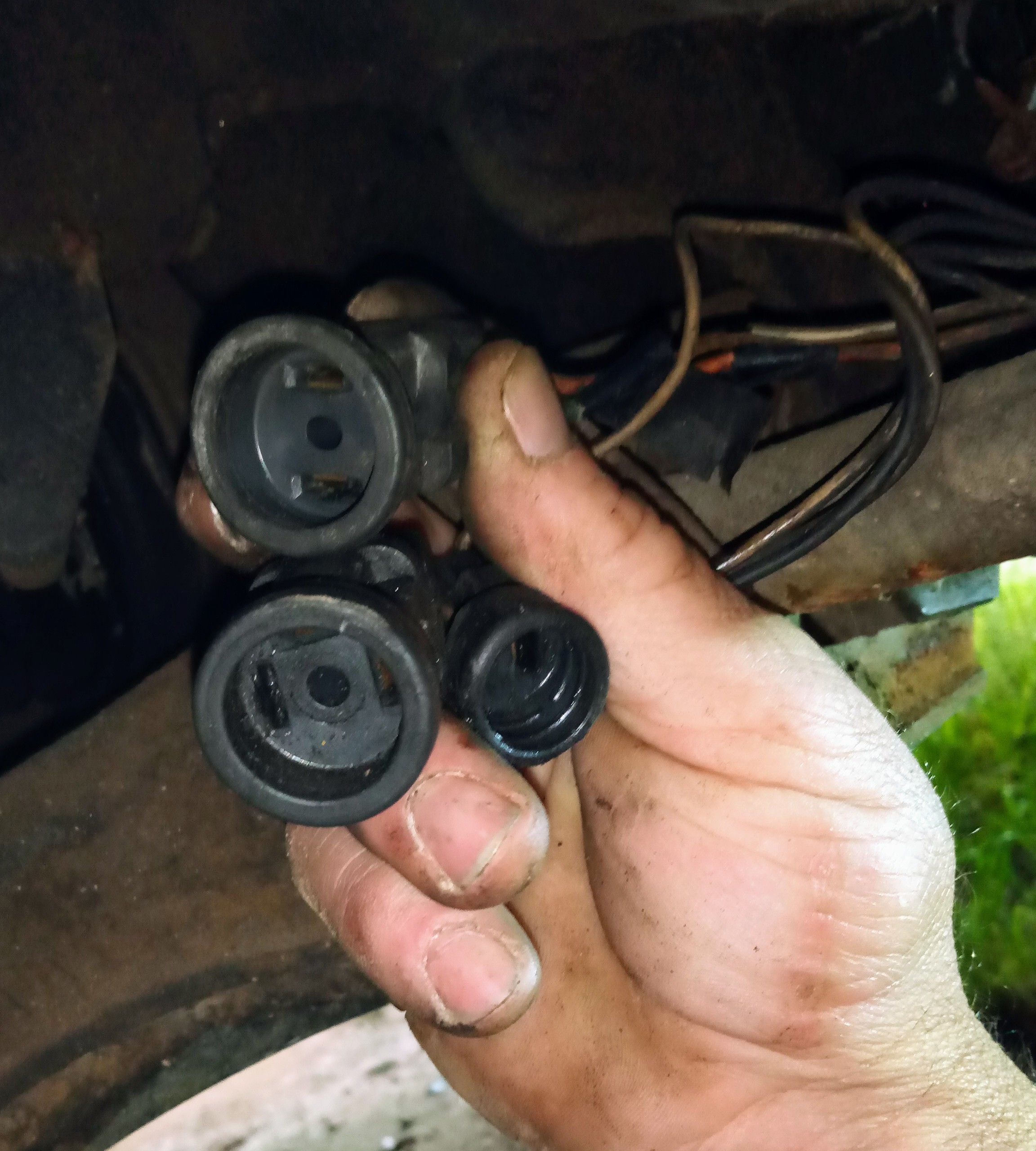

You mentioned the oil pressure switch, so I started looking around and checking some things out. I found these 3 (images attached) underneath and two of them were hooked up but the one with three wires was just hanging there and I'm not seeing a place for it to go. Any and all help is appreciated. I'm still checking the other things you listed and will let you know what I come up with.

Looking at pic 2, I am struggling to determine wire colors. I see the orange, but the others are difficult.

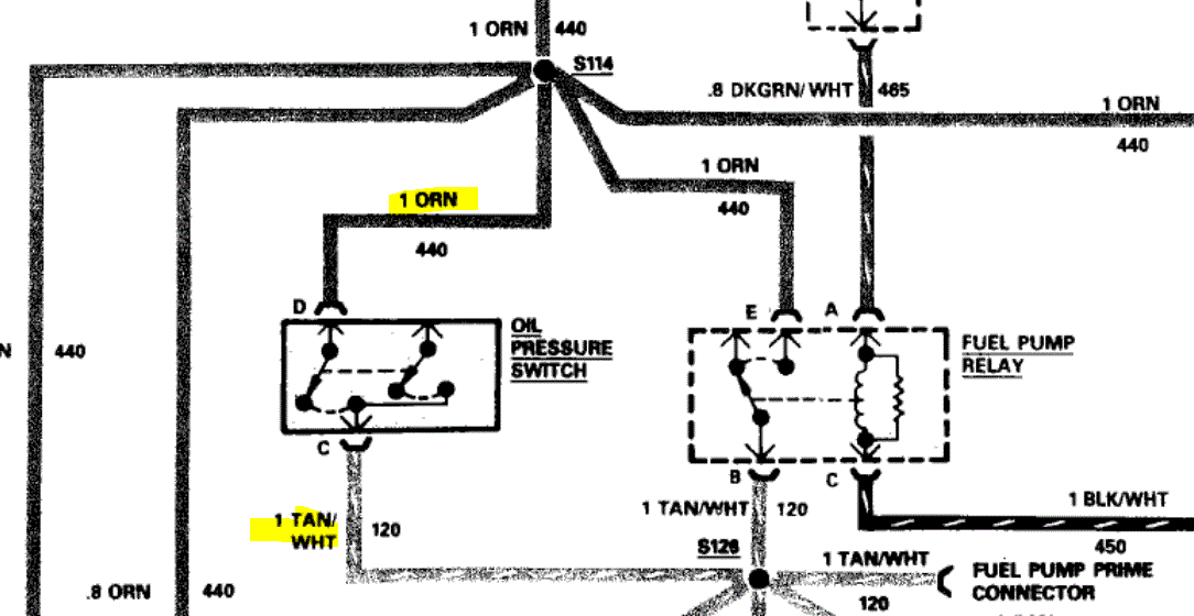

I did note the oil pressure switch and fuel relays all have an orange wire with a tan/white wire going to them. Is there any power to any of the wires?
See pic below.

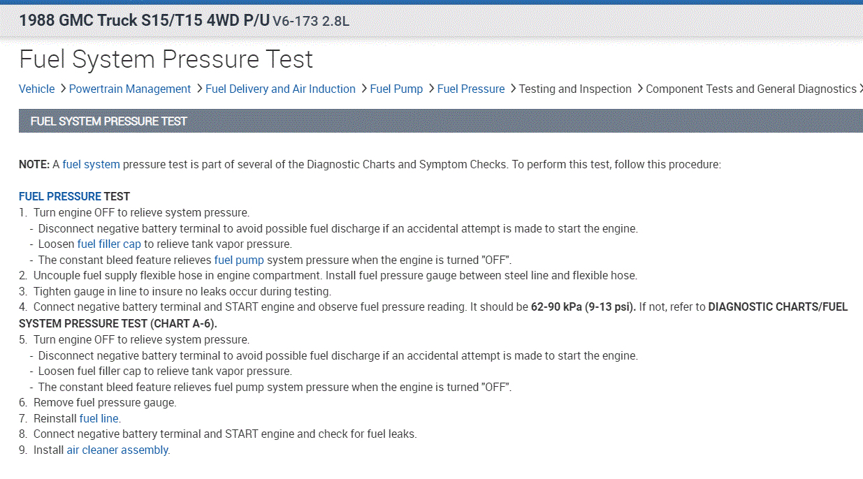

I'm sorry to hear this isn't running yet. Have you checked to see if the ignition is working properly? In other words, does it get spark to the plugs? If there is no ignition signal, the fuel pump won't work.
https://www.2carpros.com/articles/how-to-check-for-ignition-spark

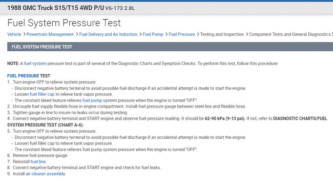

Also, have you confirmed fuel pressure? It only requires between 9 and 13 PSI, but if that is too low, the injectors won't properly work. See pic 1
See pic below.
