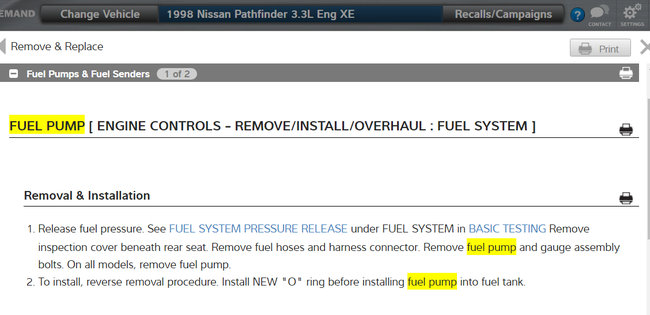

Where is fuel pump access door located to remove pump?
Apr 7, 2019 at 5:52 AM
SCGRANTURISMO
  • 4,897 POSTS

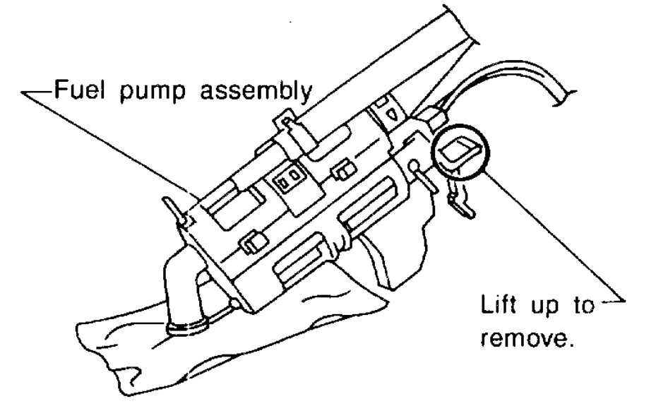

It is located underneath the back seat. I have included in the diagrams down below the instructions from your vehicle's manufacturer on removal and installation of the fuel pump. Please go through them and get back to us with how it turns out. Please feel free to ask about any other automotive questions that you may have. That's why we are here.

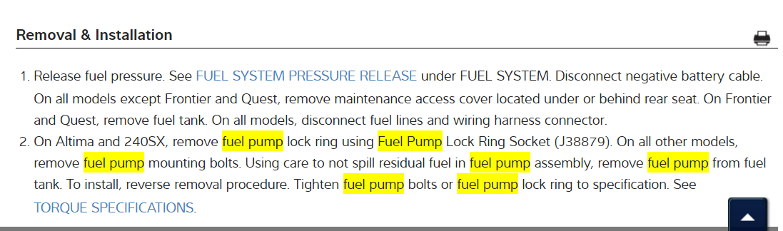

Hello again,

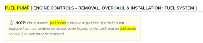

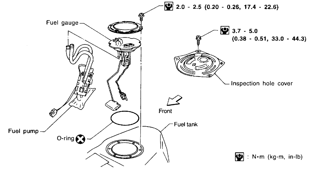

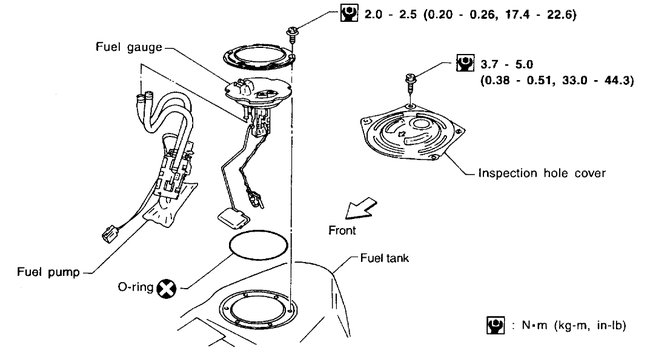

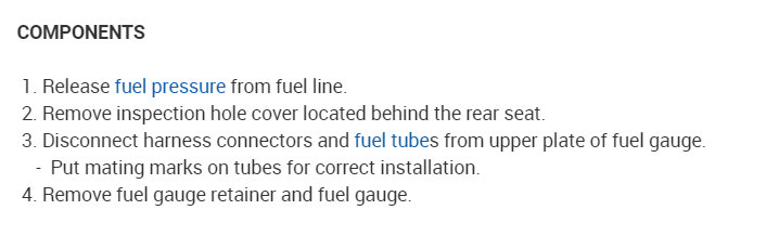

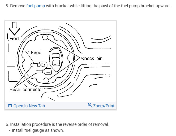

I have included my other reference source guide for removing and installing the fuel pump for your vehicle in the diagrams below. Please get back to us with what you find out.

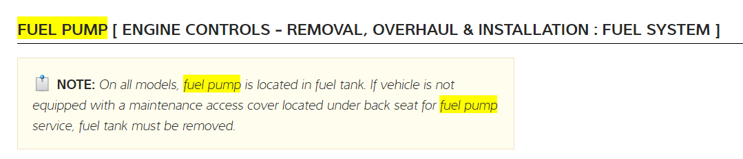

Hello again,
The information that I have and that I have sent to you says that the access panel is under or behind the back seat. The fuel pump itself is located inside your vehicle's fuel tank. So if you are not 100% sure where the access door is, you can kindof line up approximately where it should be by where the fuel tank is. I have sent you all the information that I have available to me for your vehicle's fuel pump.

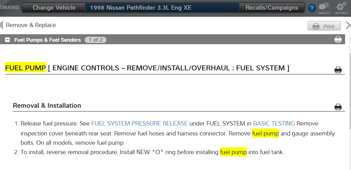

Hello again,
I am sorry sir, I have no other reference material at my disposal. My suggestion would be if you took out the passenger side and it wasn't there, it will probably be on the driver's side. Sorry I can't exactly pinpoint it, I can only pass along the information given to me by the vehicle manufacturer. Please, let us know if we can help in any other way possible.
