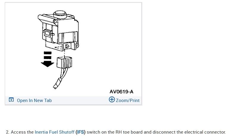

Hello, have you tried turning off the inertia switch for the fuel pump circuit and see if that shuts the pump off? That would help to rule out if the pump is getting power from another circuit it might be shorted to. The inertia switch on these is down on the passenger side kick panel. Its pretty easy to find, its just a 2 wire switch, looks like a button with two wires plug into the bottom, a Pink/Black wire and a DarkGreen/Yellow wire, they are 14 or 12 gauge, pretty heavy wire. But you can just unplug the switch and it should stop power from going to the pump. And if the pump continues to run, then you know its getting power from another source. The wiring harnesses in these trucks is pretty basic, we have an 01 as well for a spare vehicle, they are pretty reliable.

No power runs through the switch to the pump, the inertia switch is a safety component. If you are in an accident and hit hard enough, the switch will open and stop the fuel pump from running. Disconnecting the switch will help to determine if the power is coming from the relay staying on, or if power is coming from a short to power somewhere else on the circuit. Ill post a wiring diagram of it for you. But even pulling the relay out, if the pumps stops, then you know either the relay is staying latched (On) or something is keeping the relay on, as providing a ground for it to stay active.

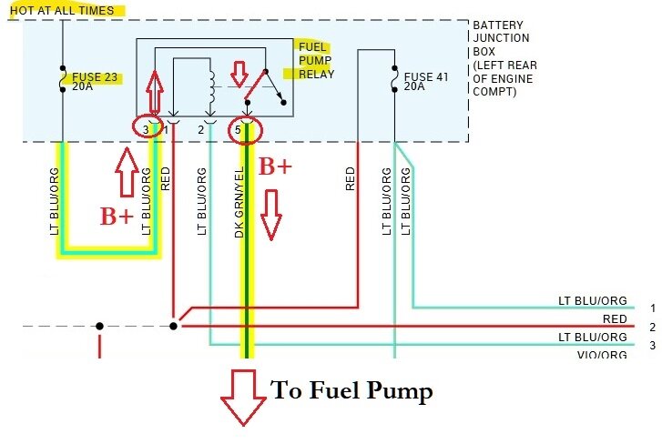

We can even start to track down where the power is coming from by checking for voltage at certain locations.
This first diagram is battery power coming from the fuse through the relay and out to the pump.

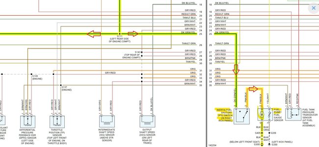

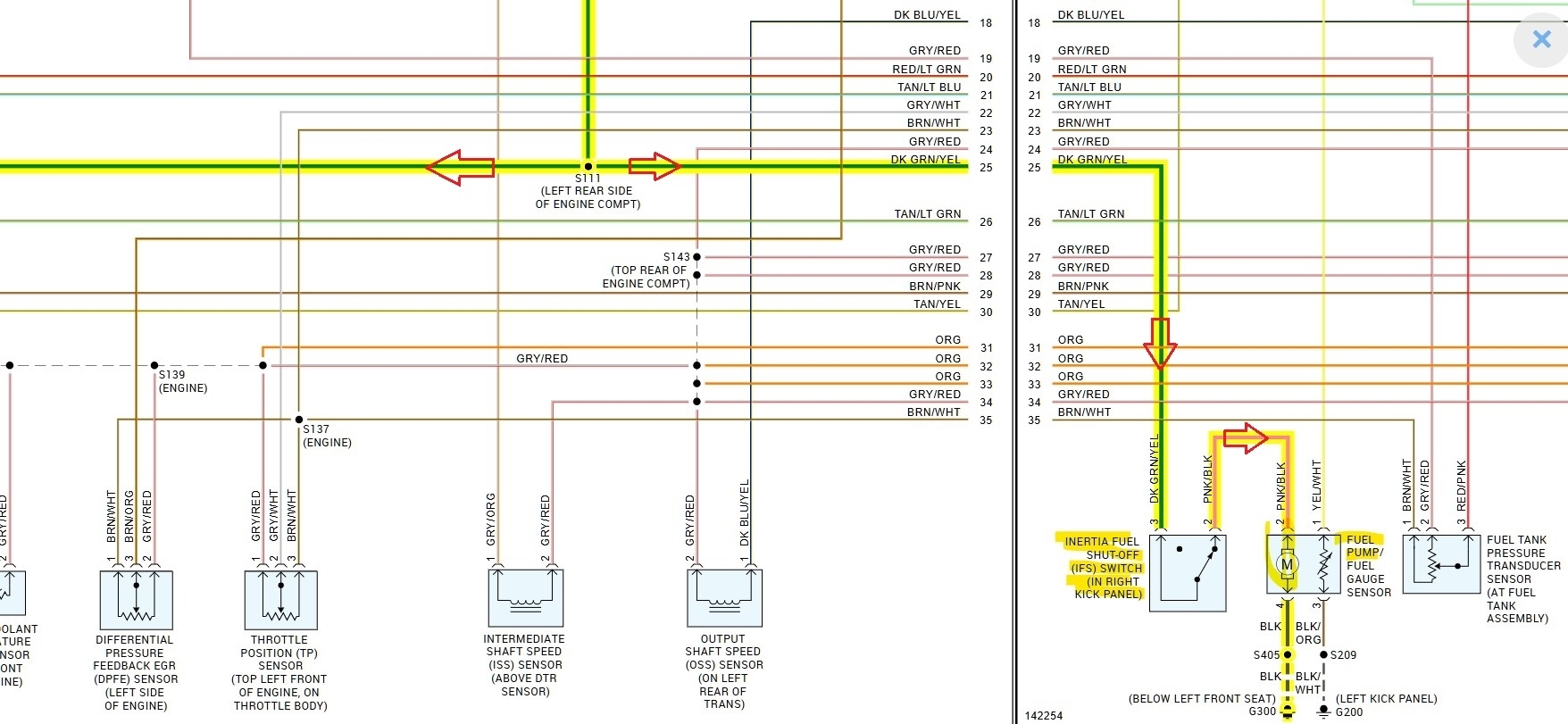

The 2nd diagram is still that same DarkGreen/Yellow wire from the relay, you can see it runs to a Splice (S111) where power goes two ways, to the inertia switch and then the pump, and also power goes to the PCM where it monitors whether the relay is actually suppling power to that wire. You can see at the inertia switch the wires change colors, DarkGreen/Yellow going in and Pink/Black coming out.

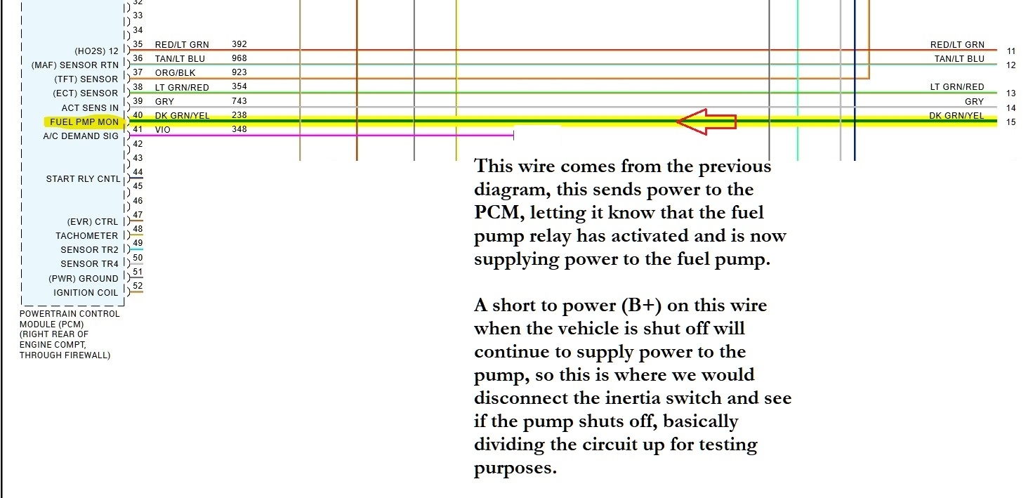

The 3rd diagram shows that PCM monitoring wire.

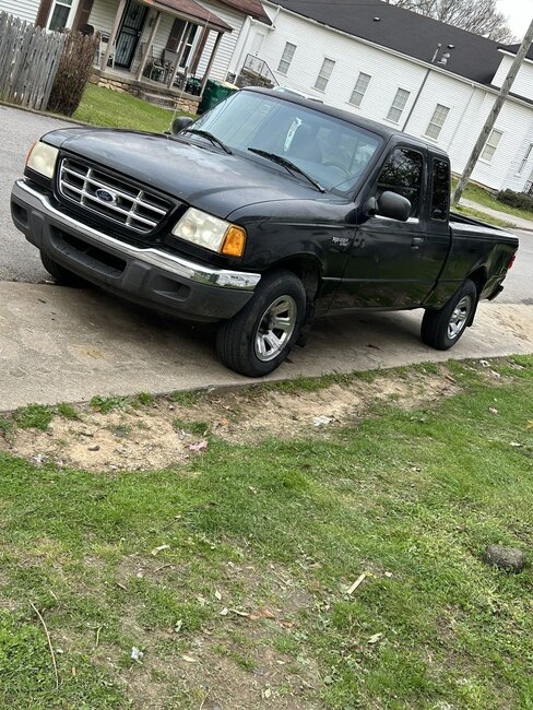

i’m not sure if the cel even works or not, half of my dash doesn’t really work like the speedo and blinkers but when i first got the truck it wasn’t having any issues starting. i do want to note it did get bumped into with a front end loader i can add a picture i dont know if that has anything to do with the inertia switch
Aug 25, 2025 at 2:53 AM
KINGMYK3L
  • 23 POSTS
i’m not sure if you can really tell in the picture or not
Aug 25, 2025 at 2:54 AM
AL514
  • 5,642 POSTS
Is that when the trouble started? Because that is what the inertia switch is for, a bump to the truck can definitely cause the switch to trip, maybe it only partially tripped, it kind of like a circuit breaker, if it gets tripped you just push the button on top and reset it.
Aug 25, 2025 at 2:59 AM
AL514
  • 5,642 POSTS
Looks like a north carolina vehicle.

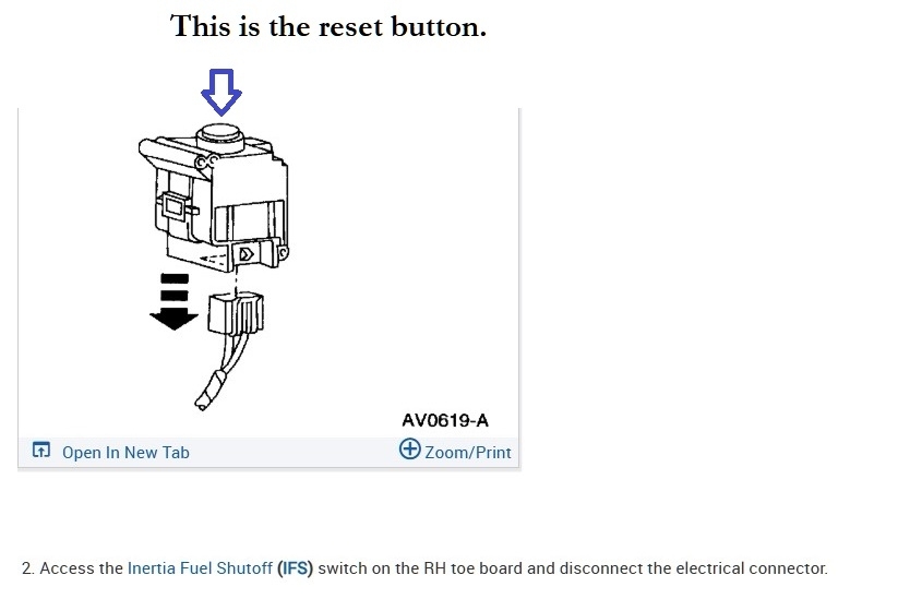

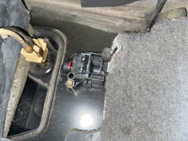

This is inertia switch and reset button, give it try,
Aug 25, 2025 at 3:03 AM
KINGMYK3L
  • 23 POSTS
i tried to push it and it didn’t do anything, this is what it looks like
Aug 25, 2025 at 3:04 AM
KINGMYK3L
  • 23 POSTS
sorry the picture didn’t add
Aug 25, 2025 at 3:05 AM
AL514
  • 5,642 POSTS
Yup, thats the switch, if you pull the carpet away a bit you will see the connector and 2 wires on the bottom of it, with these if I need to check the switch for whatever reason, Ill just keep it simple, I will check the voltage level on the Dark Green wire first, then check for the same voltage level coming out on the Orange wire. Most of time you can do this without even having to unbolt the switch, although that will make it easier, but I would grab a cheap multimeter somewhere, (walmart, autozone etc). You just need to read DC voltage and resistance in some cases (Ohms). So you can get a cheap meter probably for $20 or so, and this is Harbor Freight's cheapest fuel pressure gauge that does come with the Ford adapter, its the most common adapter out there.
In this case, since we really dont know if that inertia switch is ok or not, you can do a couple things here, you can unplug the switch and jump the two wires together, just make sure youre using the same or higher gauge because the fuel pump pulls some amperage.
You can also do a voltage drop test across the two wires while its plugged in and the pump is running, you should read close to 0volts, meaning there is no voltage loss on the switch itself. This is very basic testing, so dont let the terminology get to ya.
I would do the testing first before jumping the switch out, unless youre comfortable doing that, it would eliminate the switch altogether for now. But seeing what the fuel pressure is doing is important, this might be something completely different than we think, so its very important we test so we dont change parts that dont need to be changed. That gets expensive.
