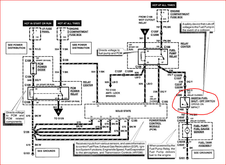

I have turned my car into an off road race car, thus I have been doing a lot of modifications. I have run into a problem with the fuel pump fuse constantly blowing. I have removed the fuel pump itself from that circuit yet if I pull the fuse or it blows, the engine shuts down. I have traced all the wires from it, and none of them are shorted. What else runs off of that fuse?
Aug 2, 2018 at 7:53 AM
DANNY L
  • 5,648 POSTS
Hello, I am Danny.
I have a diagram that I attached for you to look at. I believe your car has an inertia switch (I circled in red). If car goes over a hard bump/traffic accident(in your case off-roading) it trips the switch to shut off fuel. I can get more wiring diagrams if needed. Hope this helps and feel free to ask any other questions.Thanks for using 2CarPros.

ARIDACUS
I have completely run the fuel pump from a different wire altogether. The pump still runs while the engine shuts off from the original fuel pump fuse blowing. I have traced the wire from the fuse and nothing is broken or exposed. Here are the pictures:

ARIDACUS
Everything from the computer on the interior of the car back is eliminated. There is something else that fuse runs, and I cannot find that. That fuel cut off switch was taken out and bypassed when I built it into the racer.

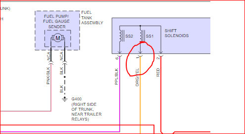

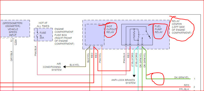

  • 5,648 POSTS

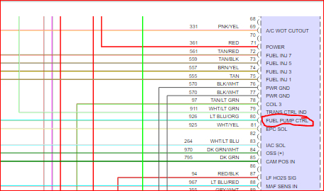

Hello again.
I traced the diagram. And here is what I found: The circuit goes from Fuel Pump into Inertia Switch, then Inertia Switch into Wide Open Throttle cut-out,Then from Cut-out into Shift Solenoid(transmission), then from Shift Solenoid into PCM (Power-train Control Module). Maybe by disconnecting it is triggering something in the PCM. I have attached parts of the diagram.Trace the wire colors to see. Also circled in red. Hope this helps.
Danny-
Aug 3, 2018 at 9:56 AM
ARIDACUS
Here is what I have found: The fuse runs to the ECC relay, that in turn is wired to the computer in the firewall. The wire from the original fuel pump goes through the crash cut out switch, to the fuel pump relay, and into the computer in the firewall. What I have done for the short term is put in an automatically resetting circuit breaker into the fuse socket for the ECC relay. That has at least allowed me to complete the qualifying race and the feature without issue. I think at this point it is blowing the fuse from either the computer board being broken, or one of the many sensors that are still hooked up to make the car run. Thank you very much for the information, and I hope I can find more information for the next lucky person to choose the mighty Lincoln for a proper race car!
