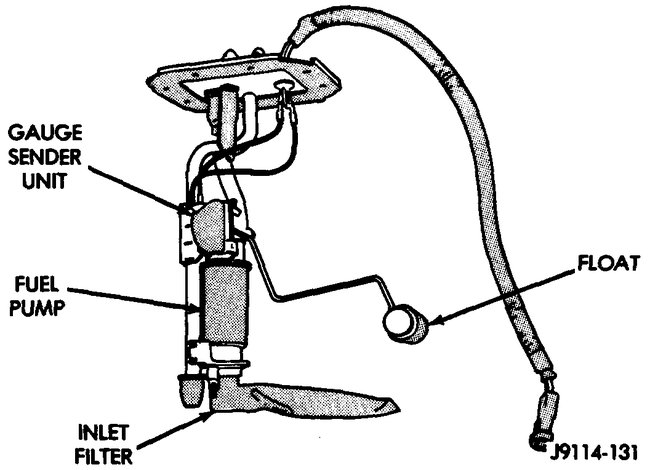

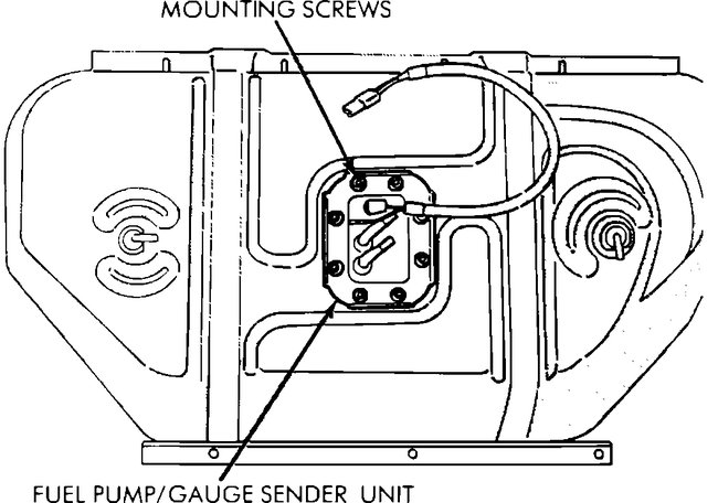

I have filled tank to be sure but that was not the problem. I was driving down the road and it shut off.
Dec 7, 2019 at 12:55 AM
  • 110,240 POSTS
If you have no fuel pressure and you still hear the pump running, chances are it needs replaced. To replace the pump, the fuel tank and skid plate needs removed. Here are the directions for pump replacement. The attached pictures correlate with the directions.

Pic 1
REMOVAL
1. Disconnect the negative battery terminal.
2. Drain the fuel tank, using a gasoline storage/siphon tank or acceptable substitute.
3. Remove the 8 fuel pump/sending unit mounting bolts, and lift the unit out of the tank.
4. Discard the mounting gasket.
Fuel Pump Module
pic 2
DISASSEMBLY
1. Remove and discard the fuel pump sock style inlet filter. Disconnect the fuel pump terminal wires.
2. Remove the fuel pump outlet hose and clamp, and discard the hose if it shows any signs of wear.
3. Remove the fuel pump top mounting bracket nut, and remove the pump.
ASSEMBLY
NOTE: Whenever the fuel pump is replaced, a new sock style fuel pump inlet filter must be installed.
1. Place fuel pump top mounting bracket over the top of the pump, and position the pump into the lower bracket. Slide the stud of the top bracket through the hole in the fuel pump side bracket. Install and tighten the fuel pump mounting nut.
2. Install a new fuel pump outlet hose, and secure the hose with a new clamp. Reconnect the wire terminals to the fuel pump motor.
3. Install a new fuel pump sock style filter.
