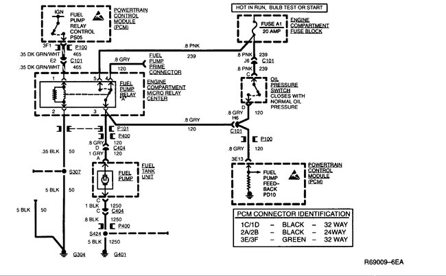

Replaced bad fuel pump with new pump it comes on now, but not getting fuel to the filter.
Mar 2, 2019 at 1:59 PM
SCGRANTURISMO
  • 4,897 POSTS
Three things I want you to check. 1) Is there fuel in the tank. 2) Check the hose that runs from the pump to the outlet line on the holder. 3) Check the electrical connections and mark sure they are not reversed. Red wire to red wire, black wire to black wire. Let us know what you find out.
Thanks,
Alex
2CarPros
Mar 2, 2019 at 3:50 PM
SOCKO

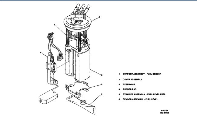

Need diagram of fuel lines coming out of fuel pump.
Mar 4, 2019 at 2:17 AM
SCGRANTURISMO
  • 4,897 POSTS
Hello again,

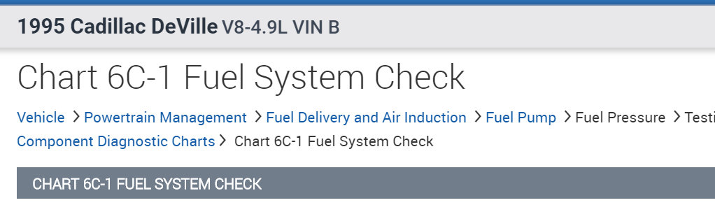

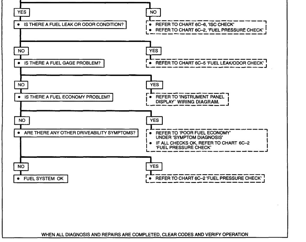

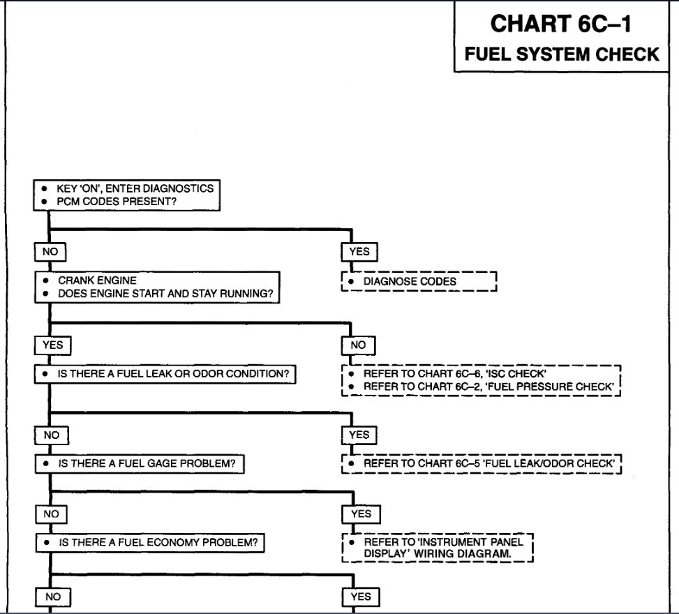

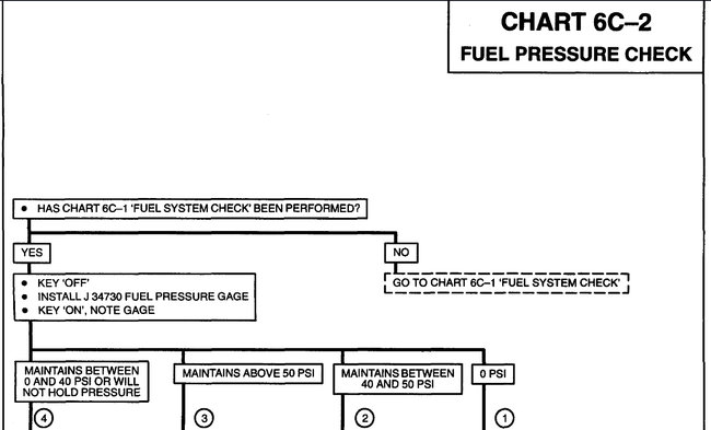

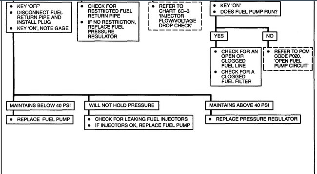

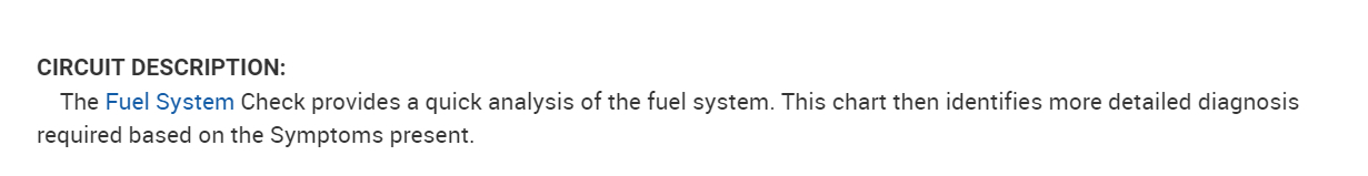

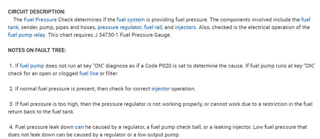

I can't find any information on what hose goes where, but it looks like you have a fuel return system, so usually the bigger hose would be the return, the smaller line would be pressure to the engine, plus it would have a line from the pump to it, and the third line would be for the EVAP system. I have included in the diagrams below a blown up diagram of the fuel pump and hanger as well as two troubleshooting flow charts for your vehicles fuel system. Please go through them and get back to us with what you find out.

Fuel pump only has two lines both same size.

Does it look like the first picture in the diagrams I sent earlier?
